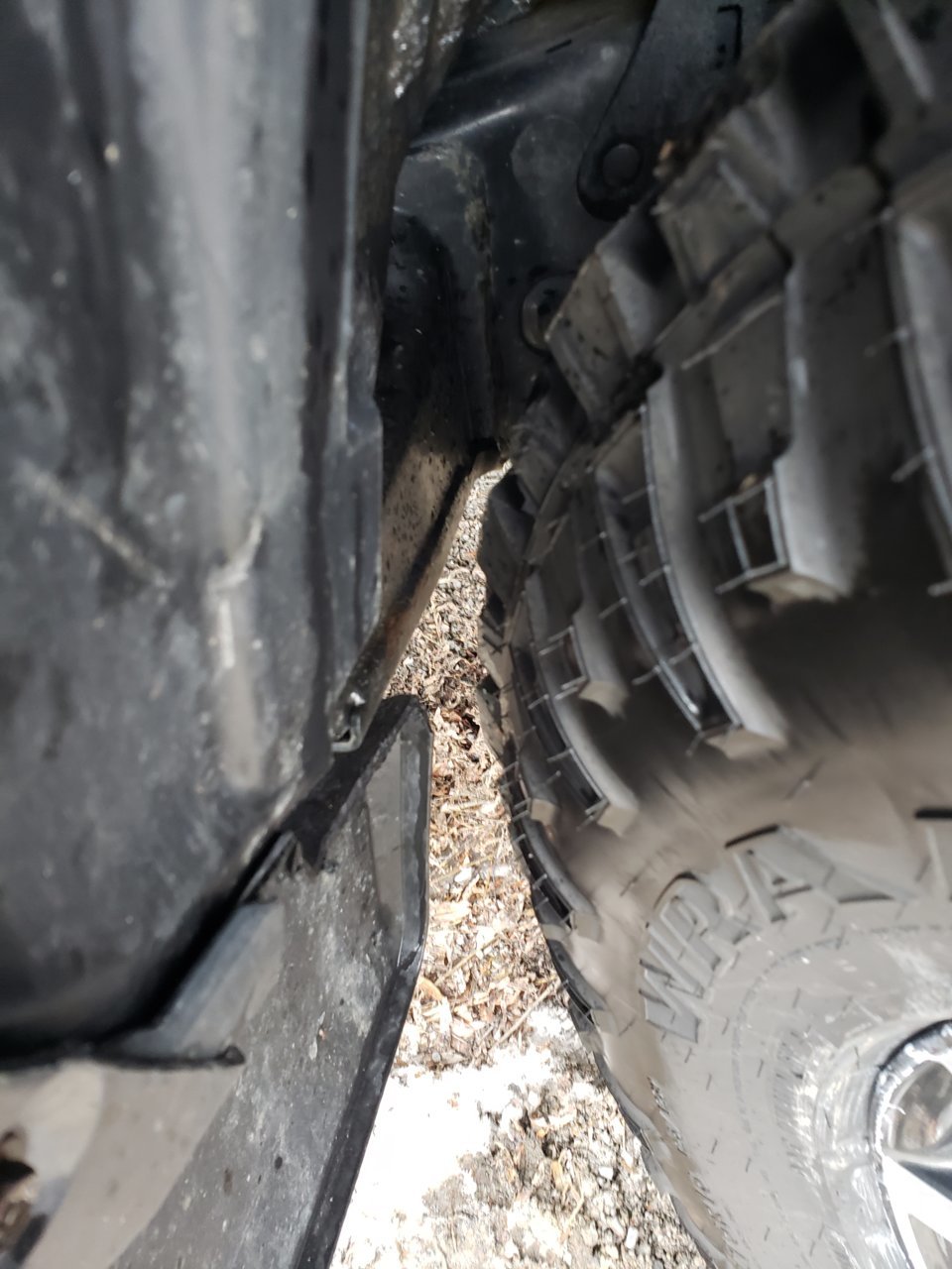

    Front - 5100's stock height plus 2" lift spacer , 1" rear block plus AAL, 1"wheel spacers, SPC uca's, ARE cap, Prinsu cabrack, DIY Prinsu toprack, Goodyear Wrangler Duratracs 285/75/16, K&N air filter, custom bed drawer system, center console rear outlet mode, 400w inverter all the time mod, DIY pop n lock tailgate e lock, hondo garage un-holey tablet mount. Soon.... RRW Stealth front bumper (ordered - 6-8 weeks) Smittybilt X2O 10,000 lb winch (waiting on bumper) Rigid industries 20" E series combo beam (waiting on bumper)
    I adjusted the lower control arm, putting the wheels as forward as possible (front in, rear out) to start, then set the SPC uca's to get everything as close as I could. Took it to get aligned and told them what i wanted and they made it happen. The key is getting someone to do the alignment that is willing to work with you because it takes time to get it right. It's not just toe, camber and caster....its all of those things with the wheel spaced perfectly in the wheel well. After alignment they turned lock to lock while I watched spacing and that was it. Took about an hour and a half and ended up with perfect spacing and these numbers. Drives amazing and I definitely regret not getting SPC uca's earlier as I have a long commute.
    caster D 2.31 P 2.80 / camber D 0 P 0 / Toe D 0 P 0
    This is as close as it gets to rubbing.

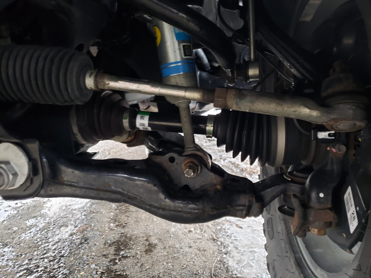

    20191213_101302.jpg and here is my CV angle

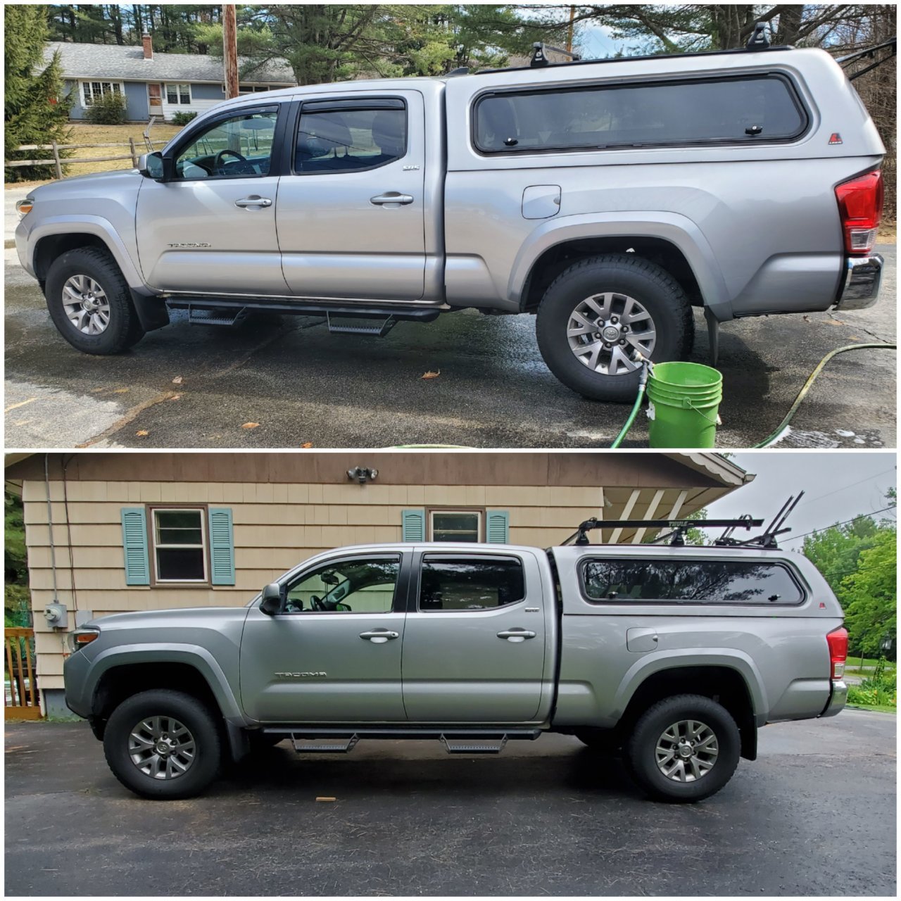

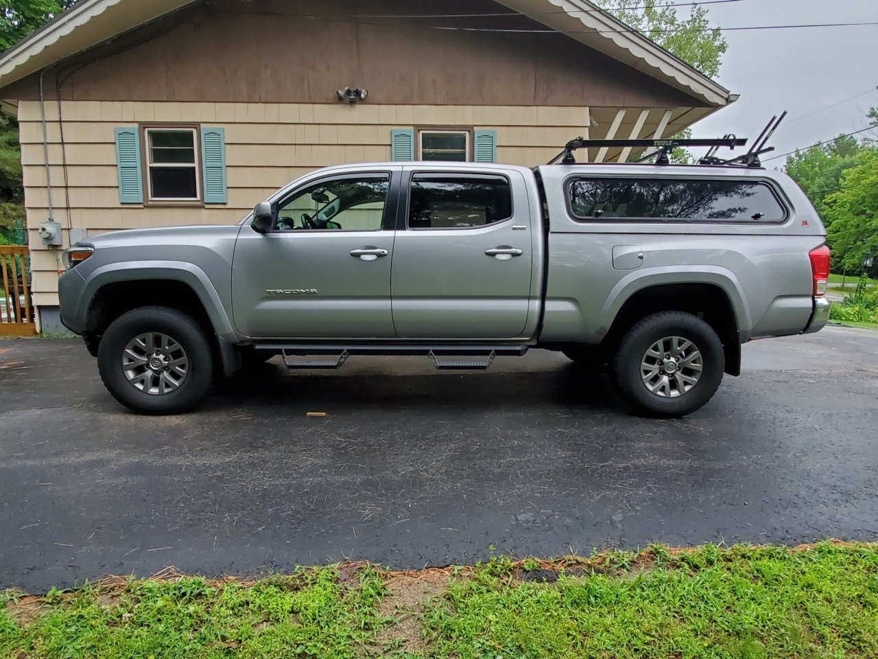

    I ordered 5100s for all four corners w/ 2888s up front and a set of Ruff Country AALs on the rear. Gained:
    RR: 2.7"
    LF: 3.1"
    RF: 2.4"
    LF: 2.5" (w/ 1/4" spacer)
    Tires are 265/75R16s so I gained ½" from sidewall height over the stock 245s. Thought I had an apples-apples picture but all I could find prelift was sitting on slope. Will see what kind of settling I see. 20200629_193429.jpg

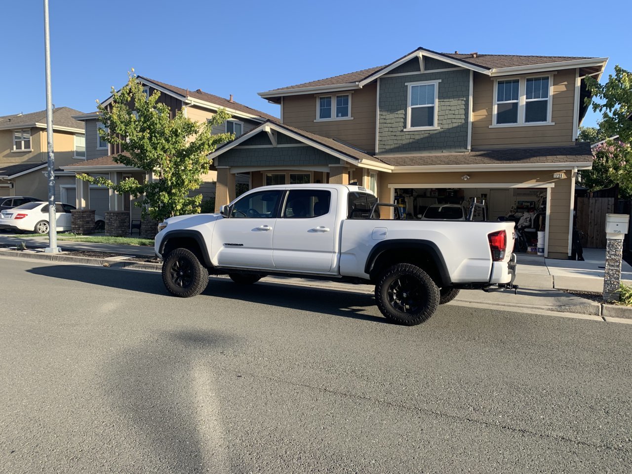

    Kings 2.5” front and rears from Accutune / ICON RXT LEAF PACK black badges doors and tailgate / method 315 / 255/85/16 Yokohama G003 / magnaflow exhaust , axle dump / meso int delete kit / meso led map lights / dome lights / wheelers front super bumps / accutune Flip kit with spacer and new bumps / Cali raised fog light pods / Cali raised ditch lights / RCI FULL SKIDS / SLIDERS / RCI rear bumper / rigid backup lights / tuned on 4.88’s
    5100’s front 1.5” / rear 1.5” aal factory rake or close to it. No complaints 265’s still look good imo

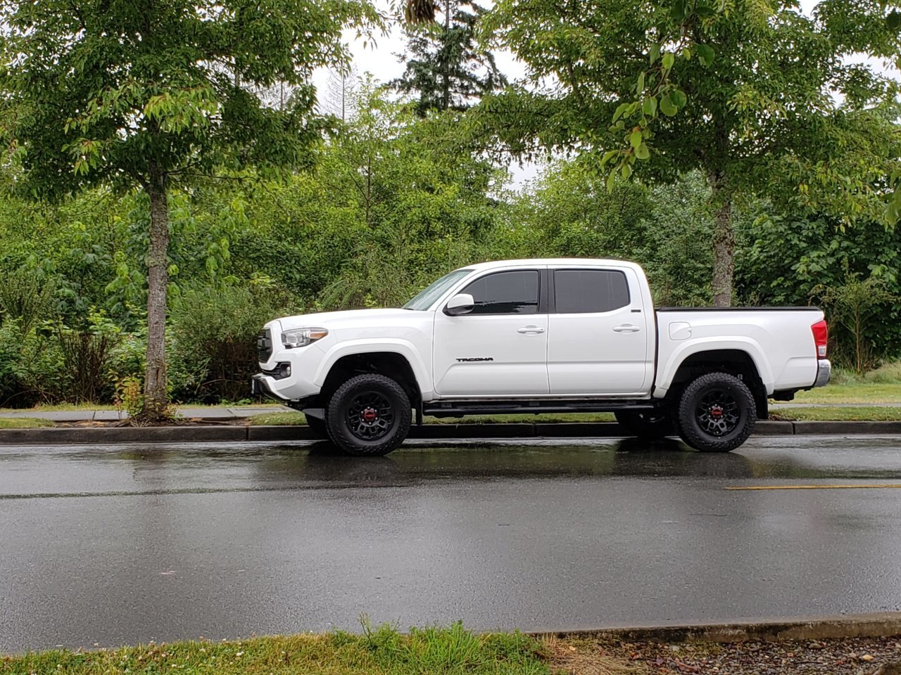

    4,475
    Issy, WA
    2017 White SR5 DCSB V6 4x4
    885 coils on the bottom perch.
    AAL in the back
    245/75/16 tires
    Gained 1.8" on all 4 corners. I'm a metric guy, so had to measure in mm and conver to inches.
    ~22 1/4" hub to the fender lip in front, ~ 23 5/8" rear. Before, I had 1.1" rake, now it is 1.4"
    I'm expecting to settle a bit more, but I drove almost 1k miles and yet to see changes.
    D-FENS, FJ to Taco and 71tattooguy like this.
    885 won't give you 2 1/2" of lift with 5100 on 0 settings.
    Headstrong revised their OME coil numbers some time ago.
    885 will get you somewhere between 1.5 to 2 w/ 5100 0 setting.
    ezatnova likes this.

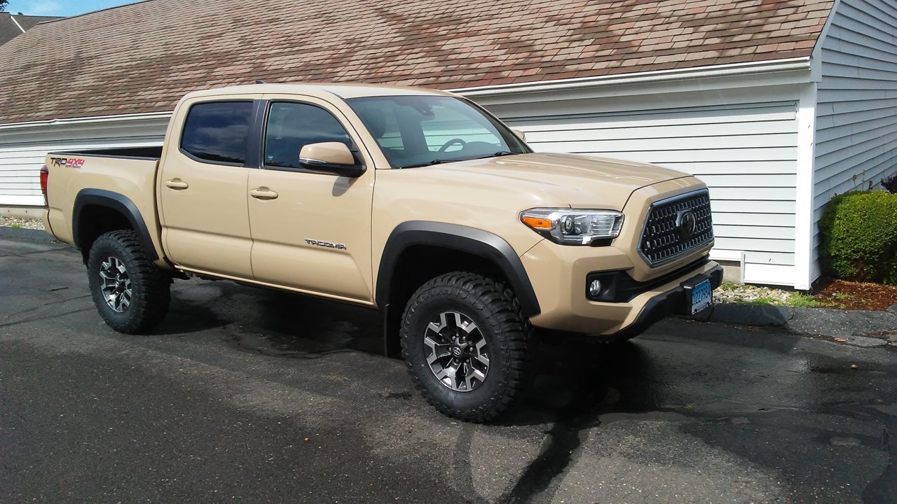

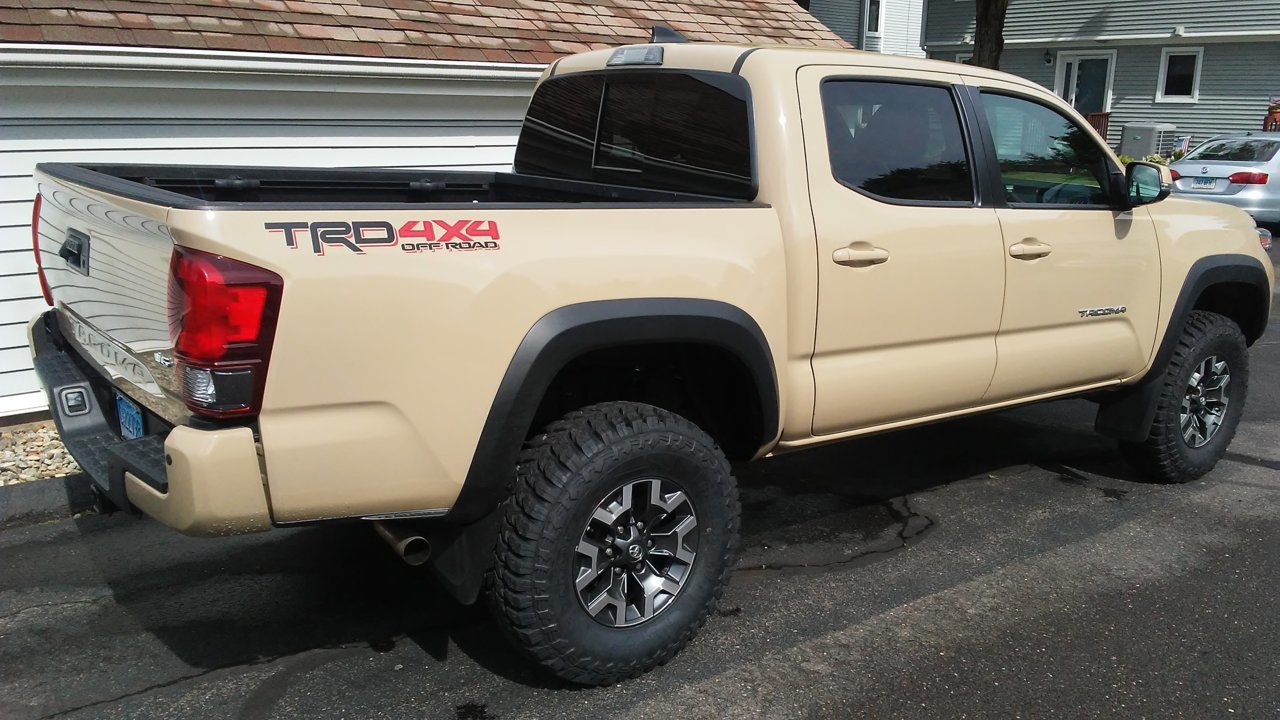

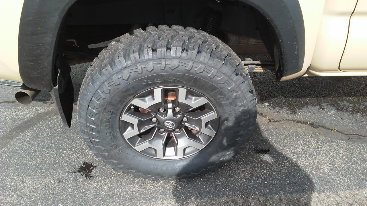

    Bilstein 5100's OME 888's JBA UCA's Torch Off Road AAL Cavalry Mud Terrain 265-75-16
    5100's all around
    OEM springs on the 4th notch up front
    2" Torch Off Road AAL out back
    265/75/16 Cavalry M/T tires
    The front rides a little mushy so I ordered a set off OME 888's and UCA's in anticipation of adding a bumper
    71tattooguy likes this.
    I went up a notch. Imo ride has not changed at all. 3/4” -1” of rake. Also spoke with bilstein direct about 5100’s very helpful.
    Burns, Ranger357 and 02Duck like this.
