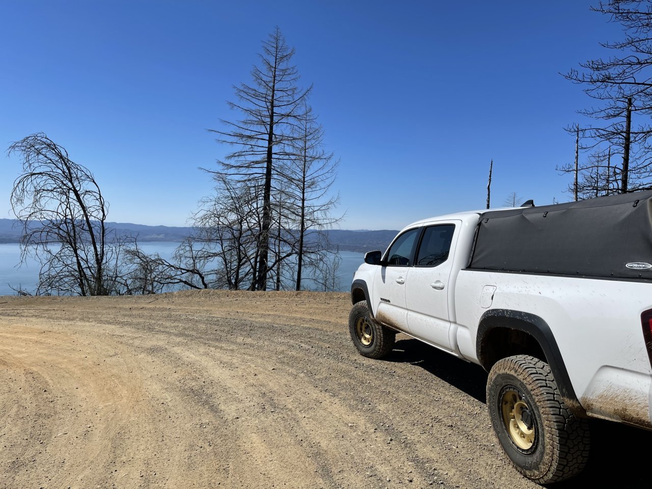

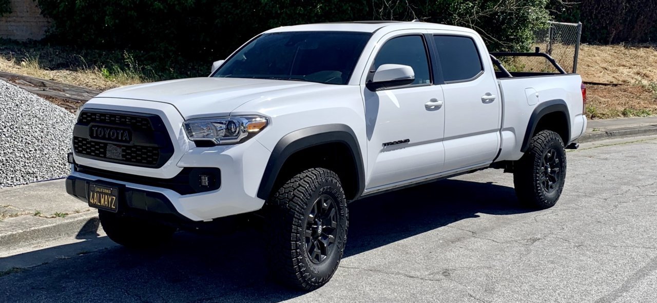

    Looking sick :thumbsup:

    Is this on stock springs 4th or 5th notch?

    I think he is on top setting.

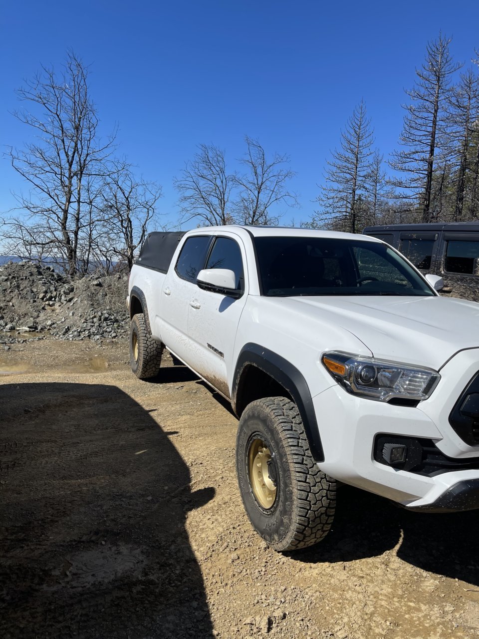

    I’m on top setting. No complaints here :thumbsup:

    Truck going in Monday for same lift! Did you do the ECGS bushing? Any Wheel spacers? Looks good with the 265s.

    Thank you. In this pic yes I used spidertrax for a little extra poke. Since this pic got new wheels. Also I have ECG’s bushing on hand if and when needed. So far so good :thumbsup: I also have gone up a notch and no ride difference

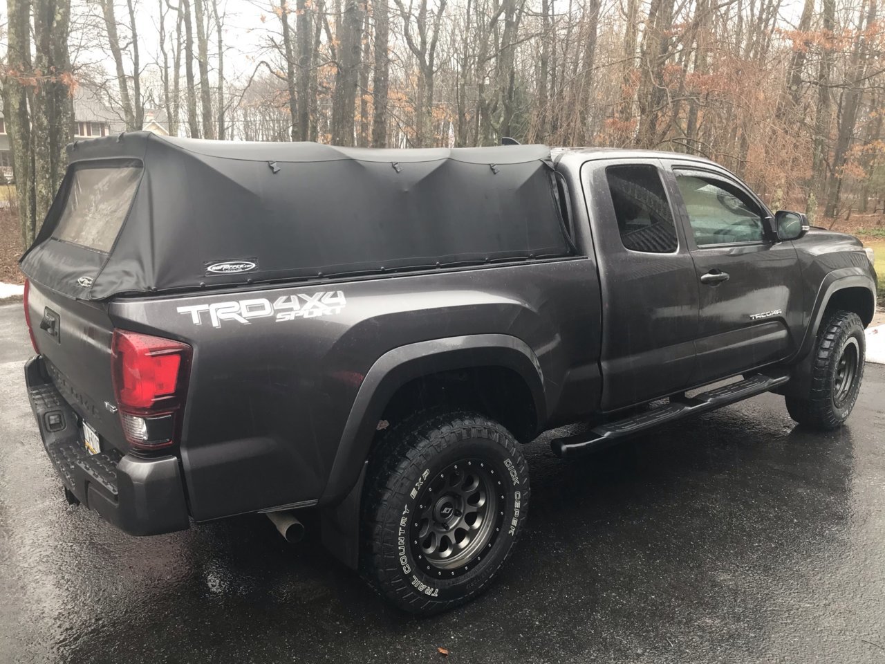

    1.55 setting, 2 inch AAL, 265/70/17 ,Stock springs. Slight rub on front mud flap.
    Easy fix with heat gun.

    Looks great

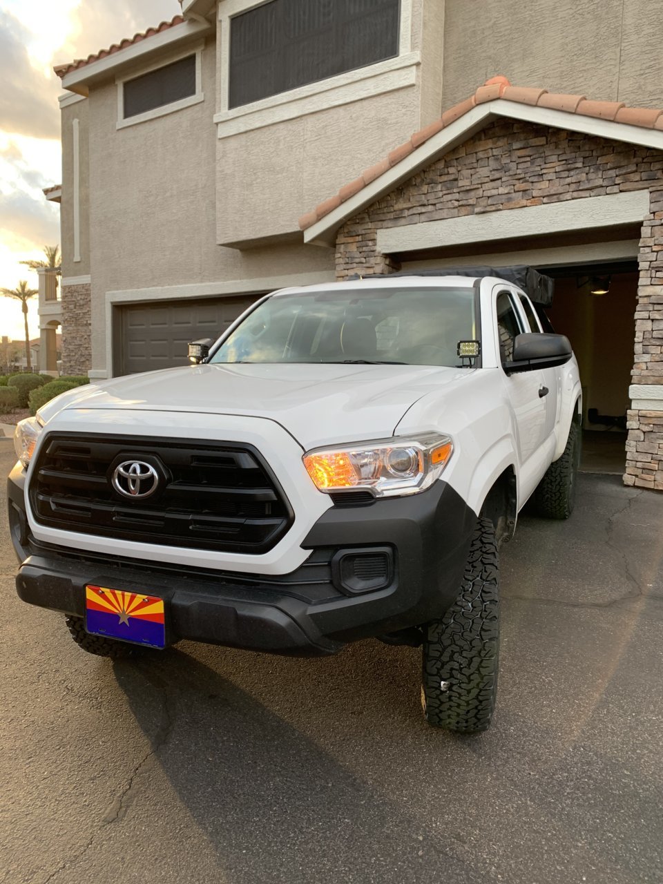

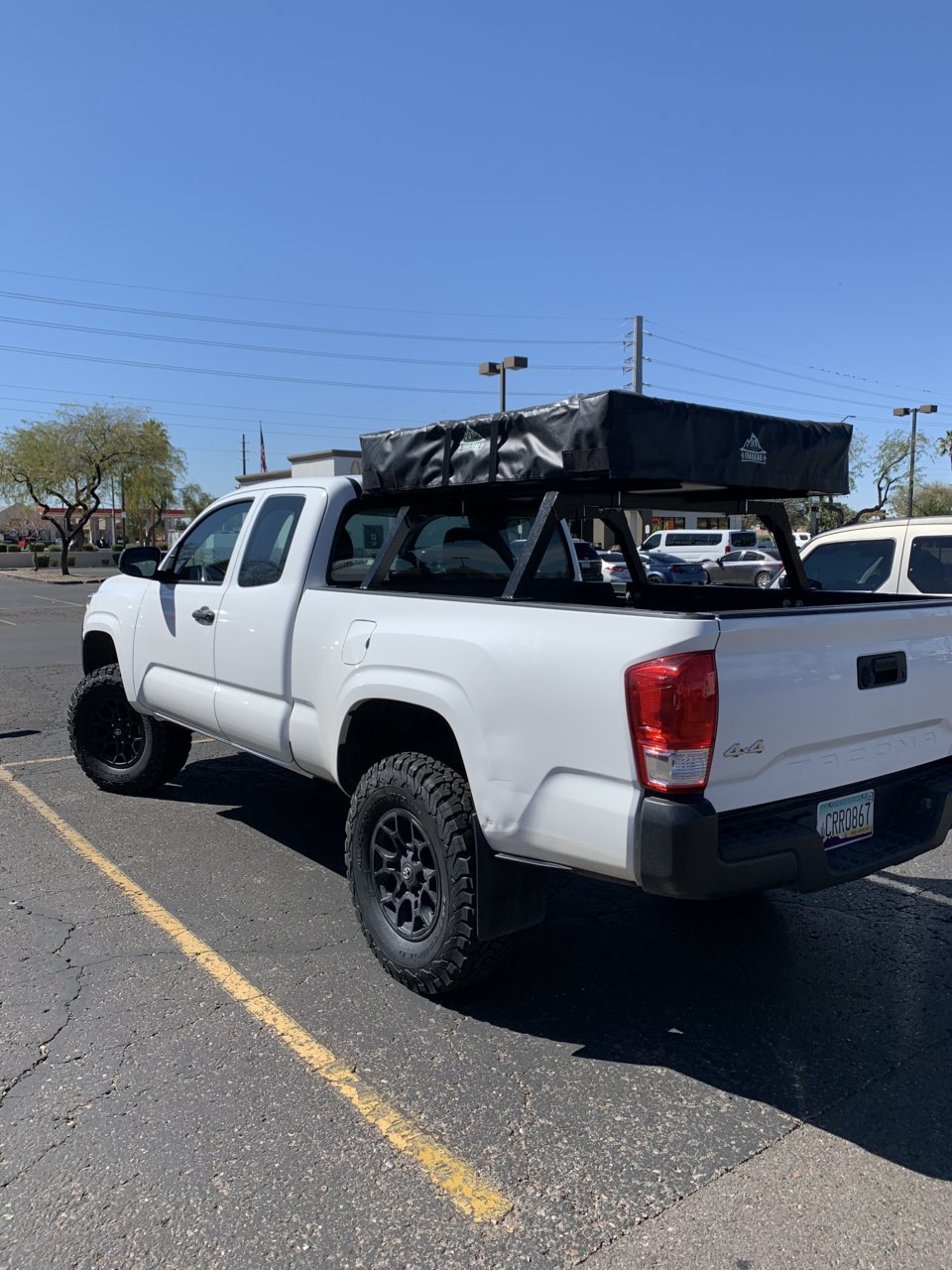

    5100 all around ome888 headstrong aal
    265/75/16

    My needle bearing went out pretty fast! The ecgs upgrade fixed her right up.

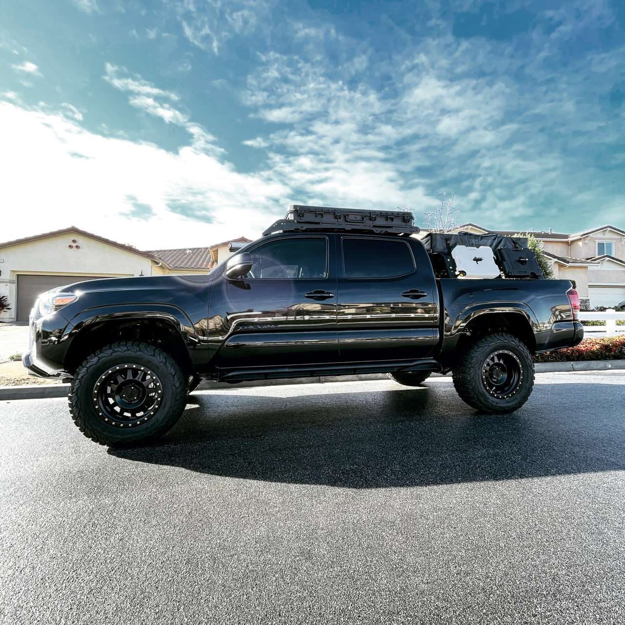

    Front: 5100s 5th notch. Stock coils. Stock UCAs
    Rear: 5100s extended, HeadStrong 1.5 progressive AAL
    265/70/17 KOs

    Hows the ride with this set up?

    Great. I was stock in the rear until about a week ago. Now the front feels planted on the road again and doesn’t wander. I can also accelerate better and stay at freeway speeds better. I’m very happy with it. 1” of rake even with all the weight in the rear.
