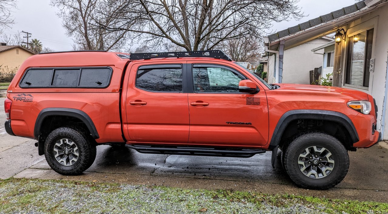

    Nice! What height did you set your 5100s to? I ask because I bought 5100s and a AAL and Inwill install the lift in a couple weeks before I get a shell installed.
  2. Feb 18, 2023 at 8:07 PM
    #622
    Atowns40
    Atowns40 Well-Known Member
    Jan 18, 2016
    #175341
    195
    Redding, CA
    17 DCLB TRD OffRoad Inferno
    2nd highest notch I believe. Since the top notch is a no no lol

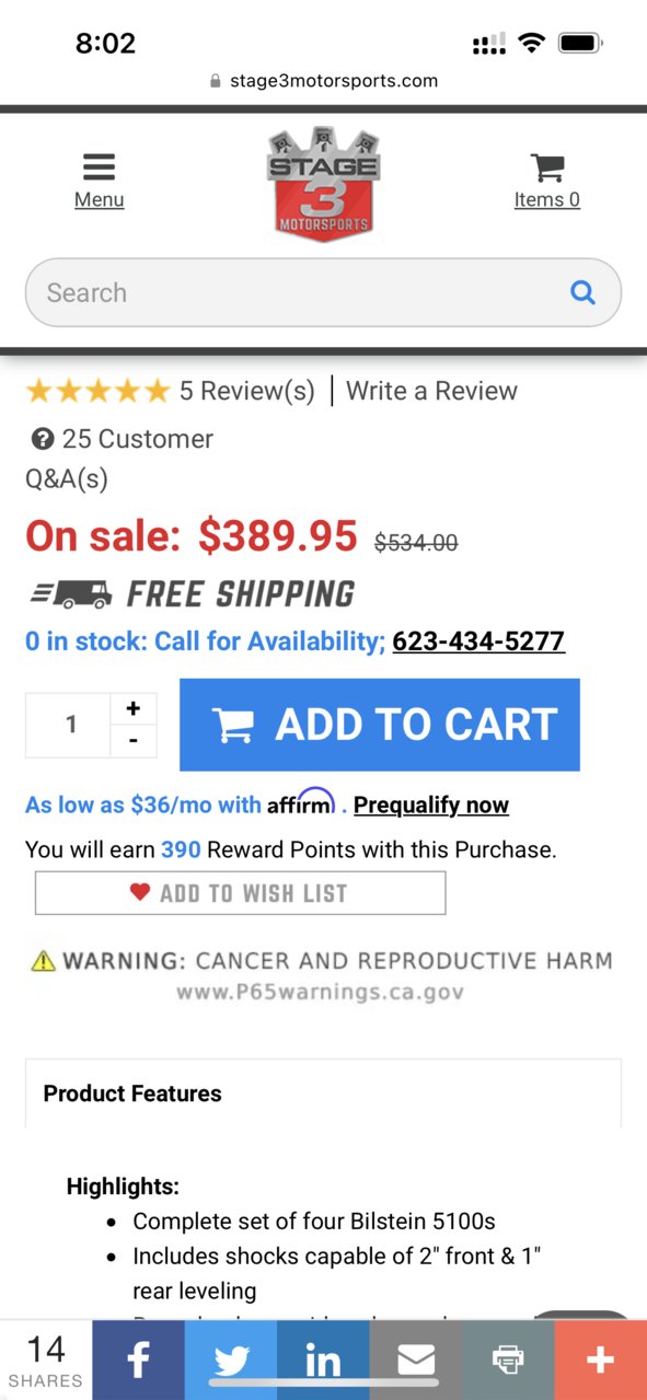

    Thinking of what you use your truck for, generally people on here report the 5100 are a better ride than the stock sport shocks (I've spent way too much time reading different threads), though that's not universal. The 5100s do have longer travel length than the stock shocks so that would be a plus on rougher roads.
    I'm personally going this way because:
    1) I'm upgrading the leaf pack because I'm getting a camper shell and also commonly haul hundreds of lbs of rocks in the bed (I'm a geologist). The upgraded leaf pack will lift the rear suspension, so I'm lifting the front to maintain the factory rake.
    2) I also want my SR to be a bit more capable on rough dirt roads and two tracks that I drive on occasionally for work and more commonly when we go out camping.
    If you go this route, the least expensive place I found the full set of 5100s at was Stage 3 Motor Sports and I got them in under a week.

    I saw the link posted but it said 0 products in stock. :(
    I’ll check again today. Under $400 is a damn steal

    Yeah I bought them about a week and a half ago. Two weeks before I ordered them, they were in stock and the week before they were sold out. So they seem to restock fairly quickly. My front shocks actually drop shipped from Bilstein.
    They are by far the cheapest at the moment that I could find... I have a spreadsheet with prices from 20 different suppliers that I was monitoring.
