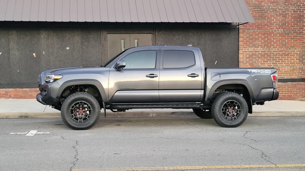

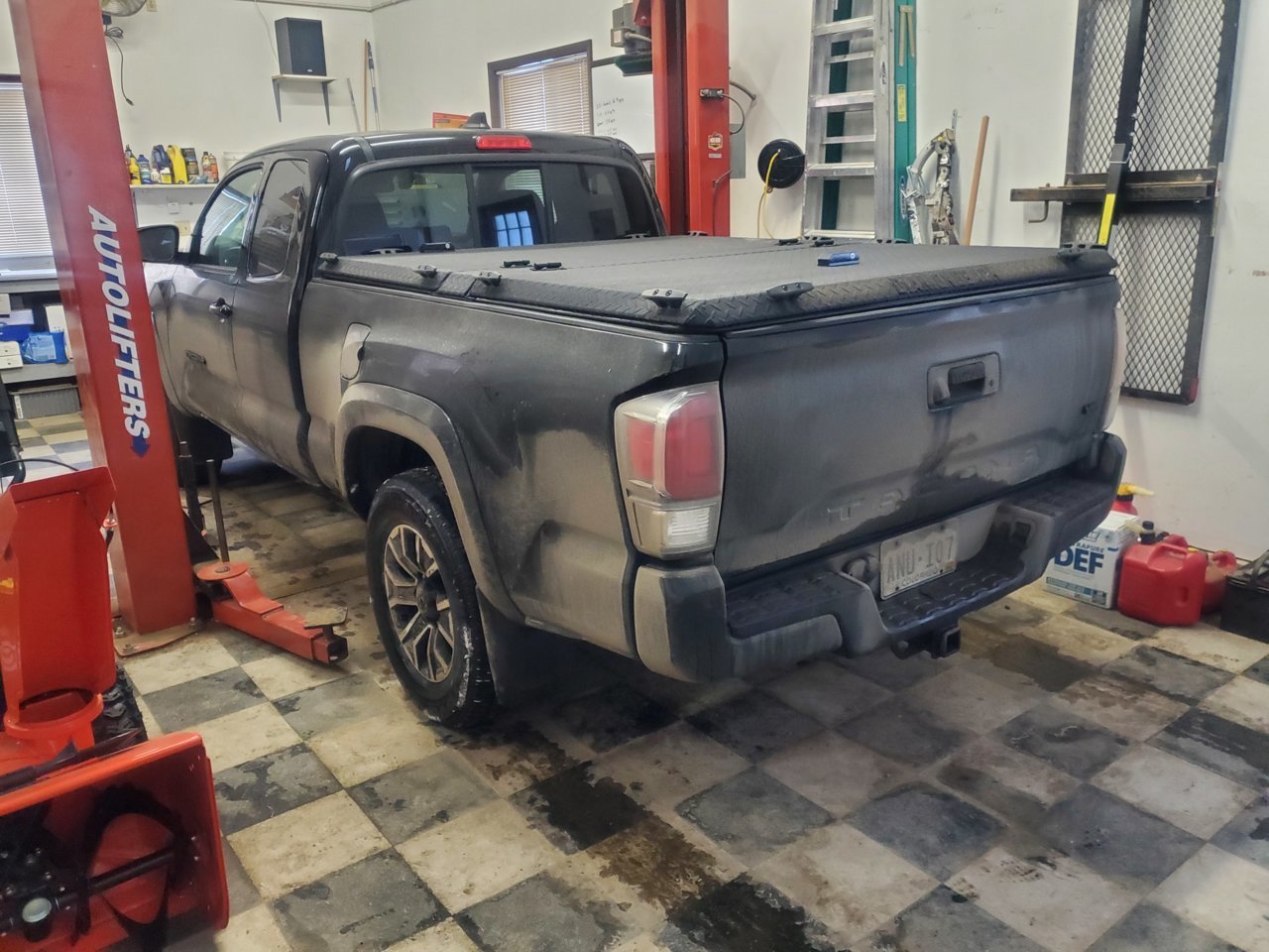

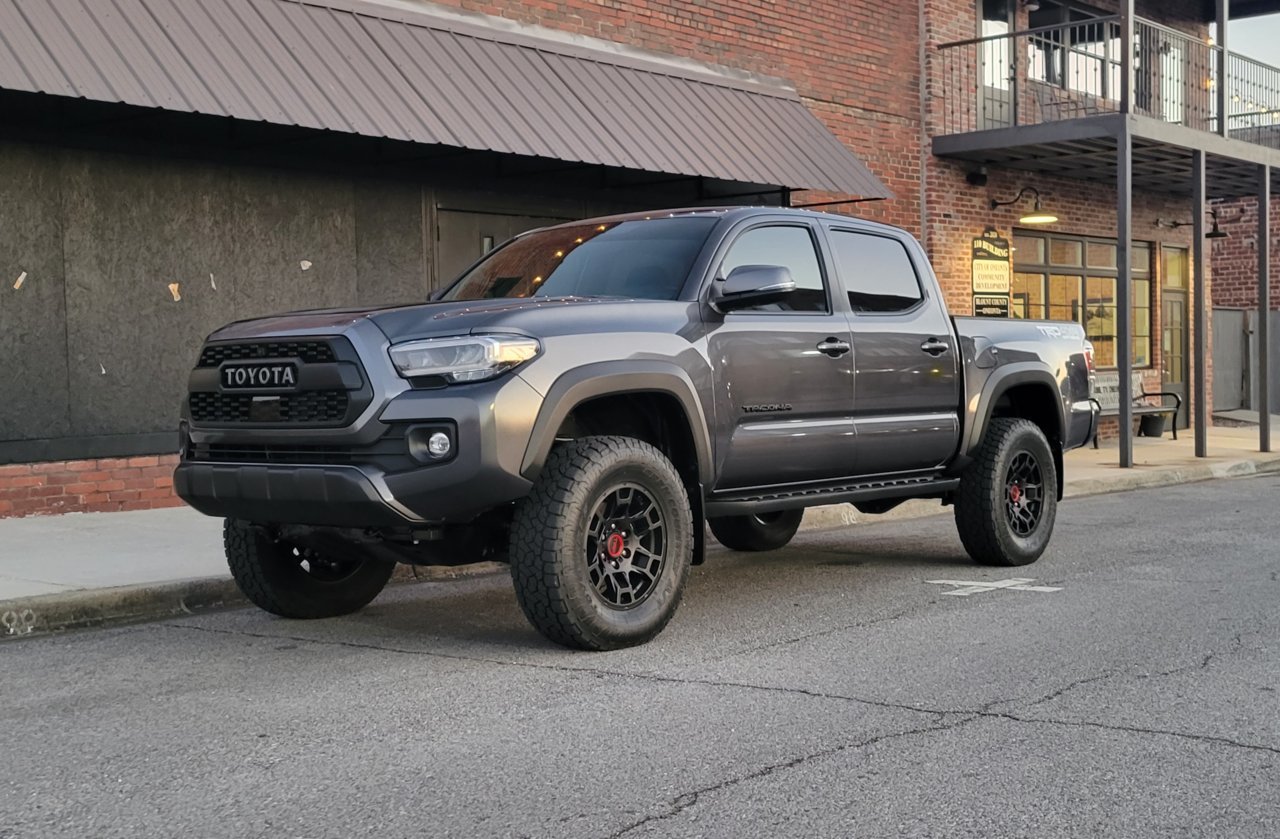

    Just finished my lift. After and before pics. 5100s all around. 4th clip on the front gave me about 1.75" and a Torch AAL in the rear is sitting at 2.25". I carry about 300lbs in the back all the time so it restored my rake.
    It rides really nice. 100% better than the stock sport suspension. Even my wife noticed it. Rides firm but controlled and cushioned.
