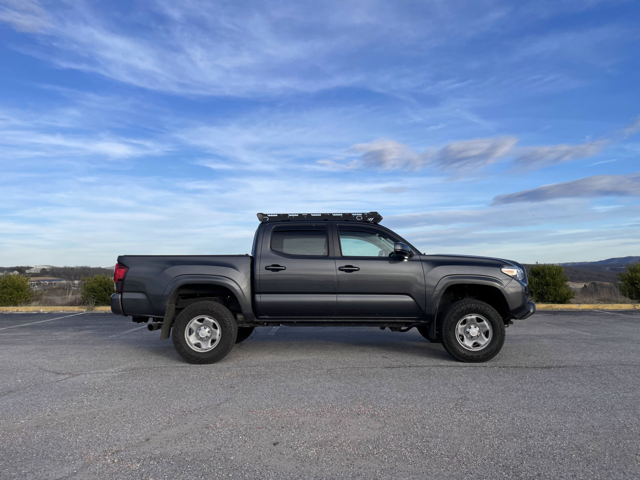

    My picture on post #682 and above are the stock wheels and tire size (245s), but the tires are Falken Wildpeaks

    Ah, that's why it looks like more than 1.1" lift. ;)
