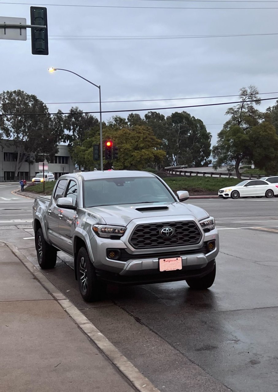

    This is the only picture I have post 5100 installation. I did not add a spacer, tbh I did not know about the whole Taco Lean thing when I installed them. I didn't measure before or after and I'm not too concerned about it. It does sit a little higher than my old mans 2021 Tacoma SR5, but I can't say for sure if my trim level already sat higher than his to begin with. I assumed they sat the same. Regardless, the ride is fantastic and I completely endorse it. I've seen your truck in other postings. Your wheel selection has really encouraged me to follow suit with the AGP's. It looks really good. Instead of Wildpeak AT's tho, Ithink I'll go with the Wildpeak HT's. I drive a ton.

    Thanks man! Your truck looks good. I think i’ll be going that route as well.
    If you need any info on the wheels/extra photos w my tire size Im running lmk.

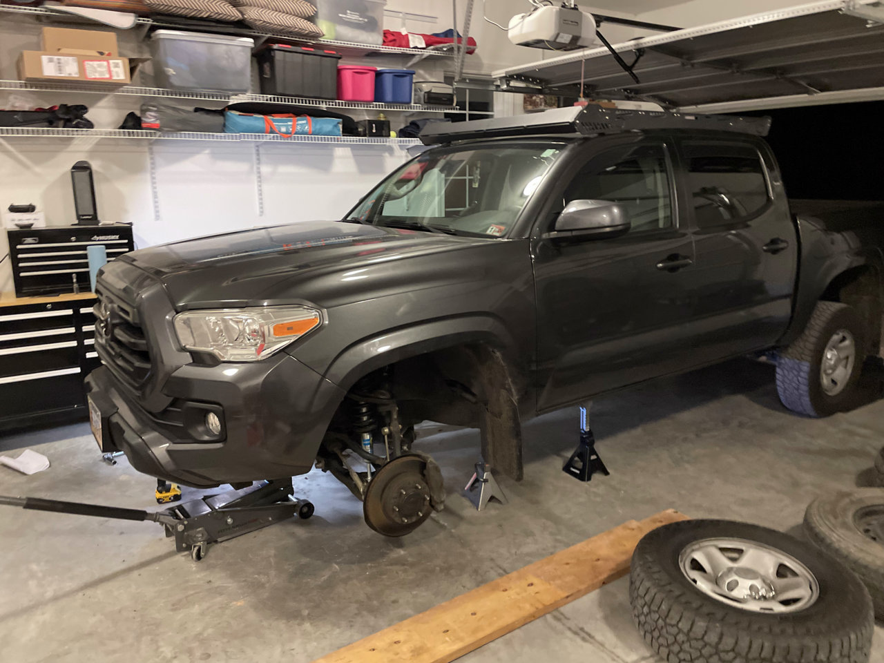

    Its performing well and I'm happy with it. I put it through its paces yesterday: hauled a couple loads of gravel and also took it on a long drive on basically every type of road (two tracks to interstate).
    I like to think of the SR as a blank slate I can add to it however I want.

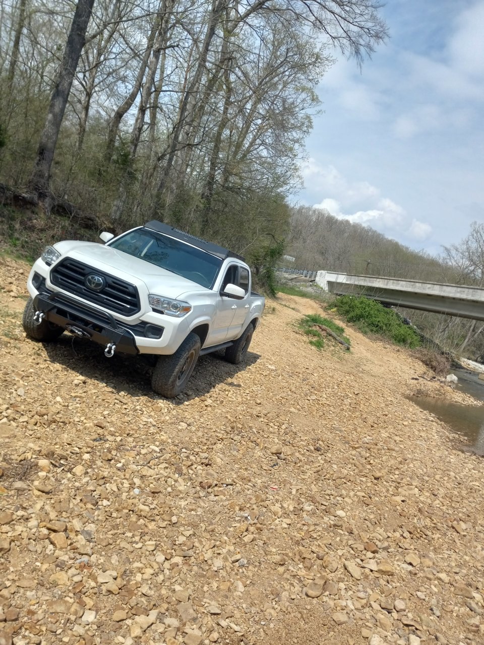

    5100s and 265-75-16
    5100s all the way around. Stock coils set at 3rd notch. Winch and bumper On 265/75/16. Rides really good

    Did you have the bumper before the 5100s or after? Have a similar bumper to install and am curious about the weight affecting what notch I set the circlip on.

    Installed bumper cpl weeks after. Haven't noticed any change in height.
