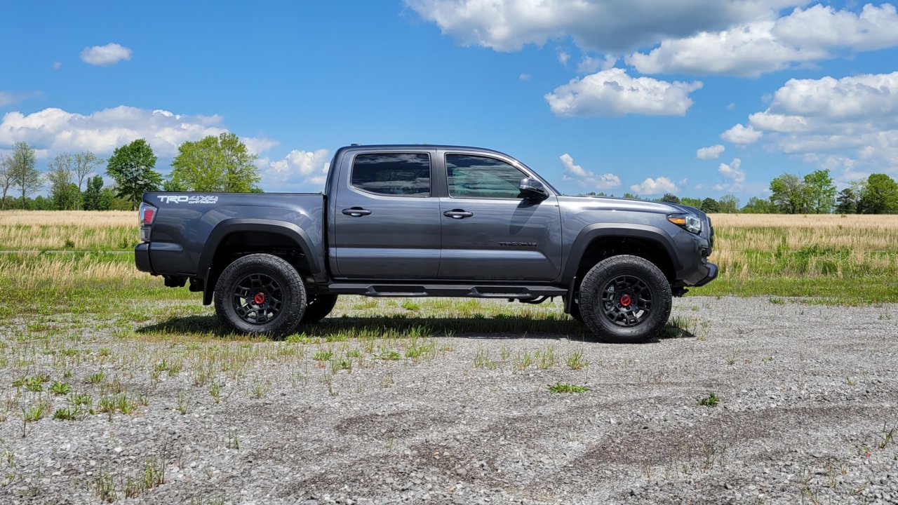

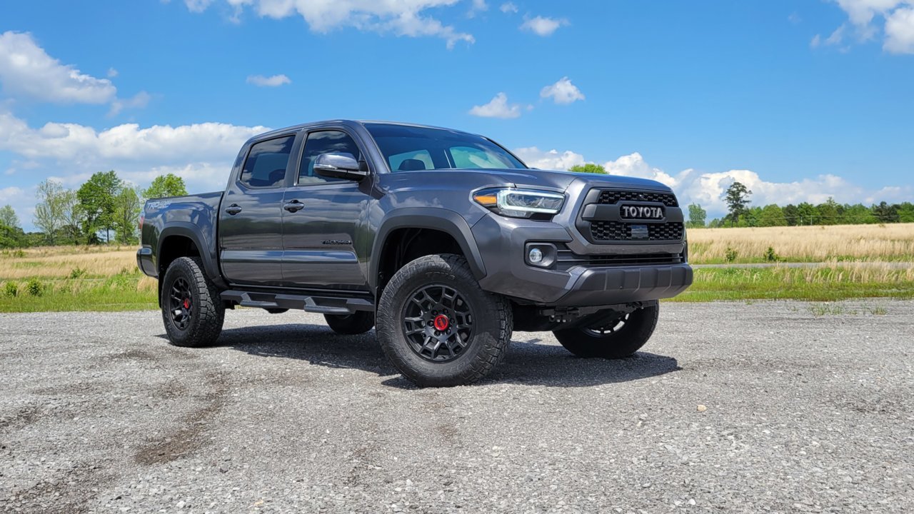

    I just made a 390 mile trip to Savannah Ga yesterday and I'm very happy with the 5100's. We were mostly on the interstate at 75mph and up to 85mph a time or two. Truck feels very predictable and confident. I can't emphasize enough about how happy I am with my set up compared to the TRD OR shocks.
    Truck is a 2023 TRD OR.
    Front: 5100's(24-263108), 4th clip (1.55") along with factory coils, ECGS bushing.
    Rear: 5100's(24-186728), HS progressive AAL, OL removed, plus a homemade 3/8" block(this maxes out the length of the OEM U-bolts).
    I'm considering going to 5th clip up front. 265/70r17's

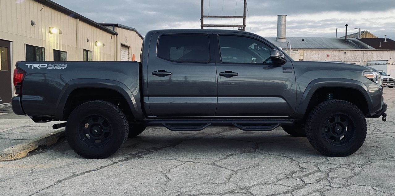

    5100’s w/AAL, Dobinson's 314 coils. 285/70-17 BFG KO2's, 17X8 Pro-Comp 89's 0 offset, BA Highline Front Bumper, K&N FIPK CAI. N-Fab Podium steps, Gatorz Low Profile Hard tri fold Bed Cover.
    5100’s on 2nd .65 to compensate for bumper
    Dobinsons 314 coils 2”coils
    BA slimline Bumper
    Headstrong AAL
    265/70-17 (for now) on 17x8 O offset ProComp 89’s

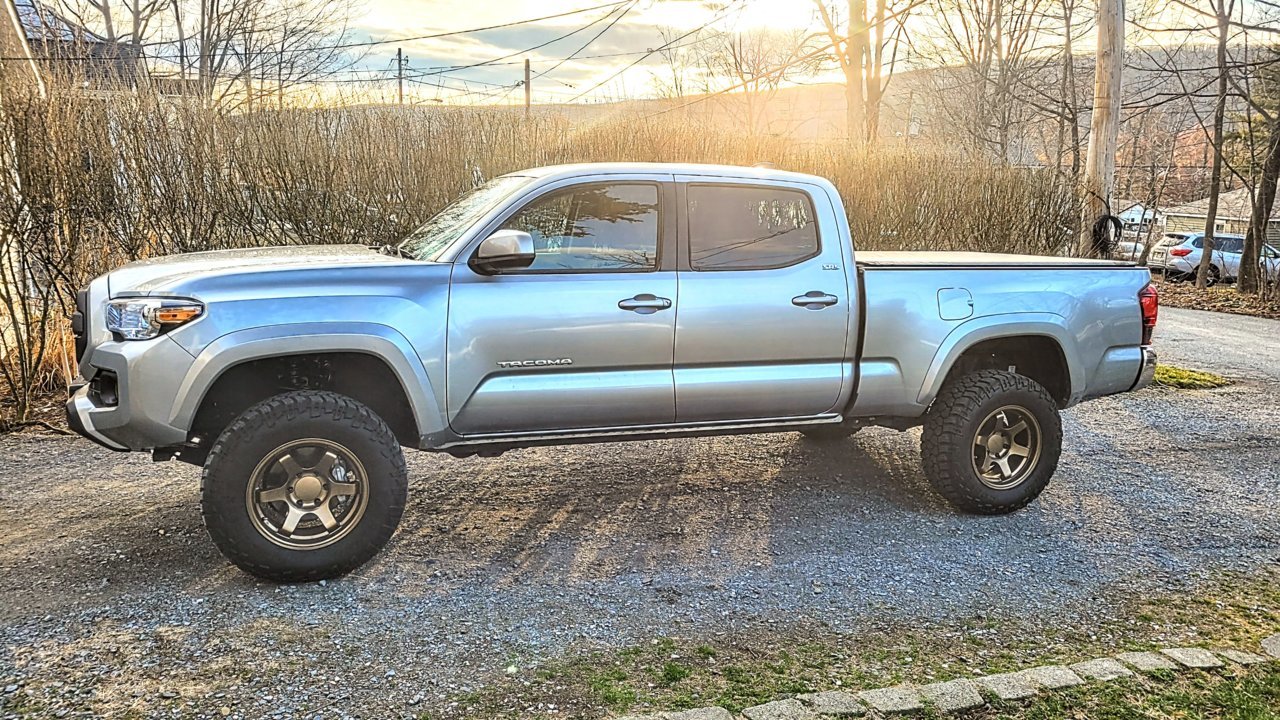

    Have a question, finished up installing a 5100 with 2inch lift coils last night. Went to put the wheels/tires back on and I'm contacting the UCA before the rim is even sitting fully on the studs. Running stock TRD sport wheels, 17x7.5 with +30.
    Spacer size to move the wheel out enough? I know less than zero about spacers.

    Nice looking rig! What size tires are you running?

    Thanks. 265/70/17.

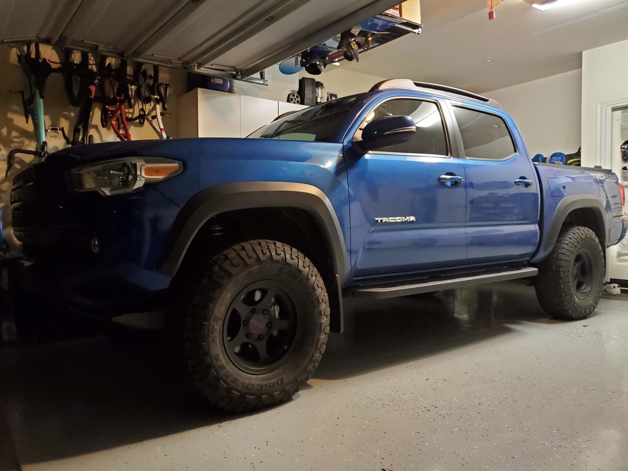

    5100s on highest setting w/ AAL from ICON. Wheels were 16x8-0 wrapped in 285/75/16 Cooper Discoverer AT3s. Had the setup for years. Rode comfortably on the road and handled the dirt just fine (not bouncy compared to stock). I was pleased w/ the setup until I installed Icon RXTs at the stiffest configuration and road became rather stiff on the road. Tires did rub on the mudflaps at full lock - but that was it.
