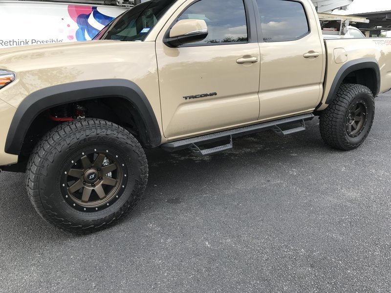

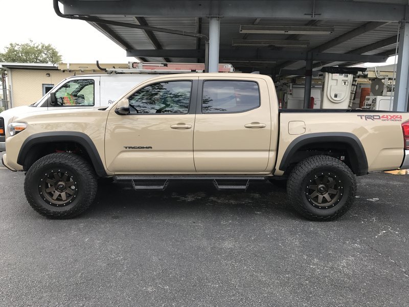

    IMG_0044.jpg IMG_0046.jpgThis is how it sits with 5100s set at 0 with 888 springs and aal in the rear with 285 tires

    UCA's and any CMC?

    Yeah I went ahead and changed them after I got the alignment and it rubbed like crazy but it didn't do it before the alignment. I bought some jba OffRoad upper a arms. Just need to go back to get the alignment done with new arms
