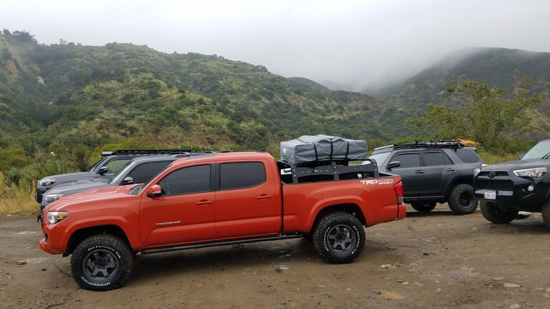

    #176
    MikesTaco06
    MikesTaco06 New Member
    Aug 7, 2017
    #226201
    2
    2017 Black quad cab TRD sport
    @vei1side Are those the 3rd gen bilsteins or 2nd

    Looks great from your profile pic! Can you post a bigger picture? You have the exact same truck that I just ordered.
