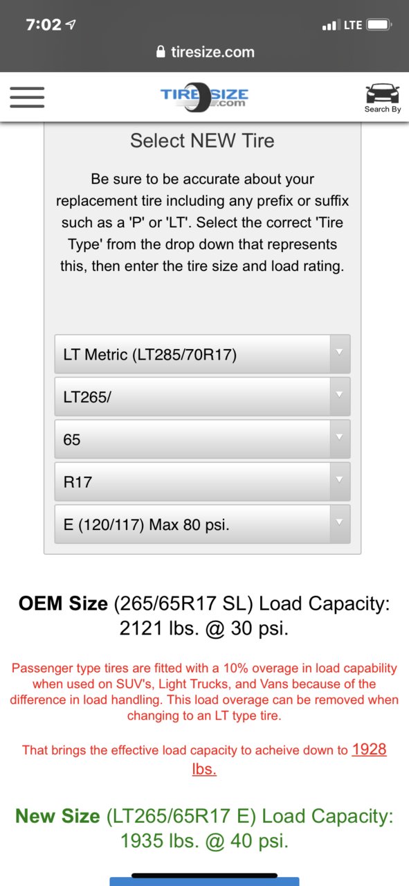

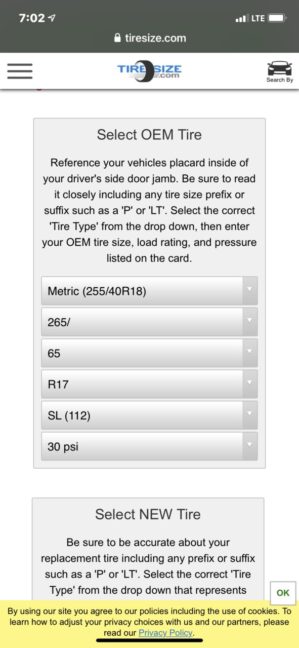

    Yes, it does need to be adjusted accordingly. Here’s the tire pressure calculator for a stock trd sport:

    That’s probably where they should be at, check out tire pressure calculator.
    E loads ride very stiff, this is why I prefer C load.

    E load tire will require more psi to support Tacoma unladen.
    If you look at my screenshots, you will see SL supports 2121# at 30 and E load 1935# at 40 psi.
    Yes, e loads ride very stiff, this is why I avoid them. And it will not burn the center off, why would it? It’s the correct pressure for the weight.
