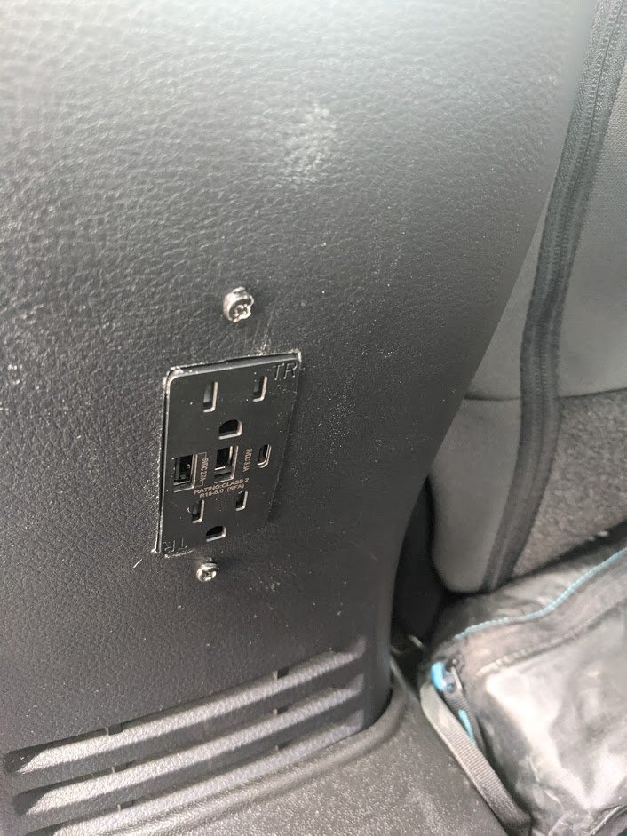

    Looking into doing this mod, but reading the reviews for the power grommets at Amazon, the same sold at ebay, seems like lots of people report poor quality and USB ports not working right or failing after a short while. Wondering about how it is working for those of you that installed them a while back. Thanks.
    I guess if the 120v outlets work well, I can always use a power strip to plug in chargers for the tablets, cell phones and walkman and camera battery chargers. The USB port or power point with USB adapter on the dash with cables plugged in gets in the way. Thanks again.

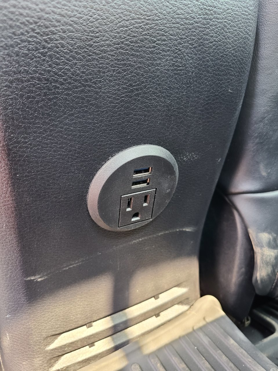

    My 120vs are holding up well. I installed one single in the front next to the cup holders and one combo 2 plug + usb in the back. The USB plug didn't supply as much power as the stock USBs and couldn't charge an iPad faster than it could drain it with the watt limiter in place. I ended up doing the 400W anytime to get the power up and it's OK now. If I did it again I'd get a separate USB plug to tap into a 12V source (to not loose extra power in the conversion) and add the 120V plugs separately.
    Also, tamper proof plugs keep stuff from falling in. I put a kid plug protector on the front one because dust and crumbs were falling in, or I keep my kid's reading light plugged in. The back one is tamper proof and auto covers the plug holes. That back one is in the perfect spot to get kicked out if your kid crosses back and forth. Not sure of a better alternative.

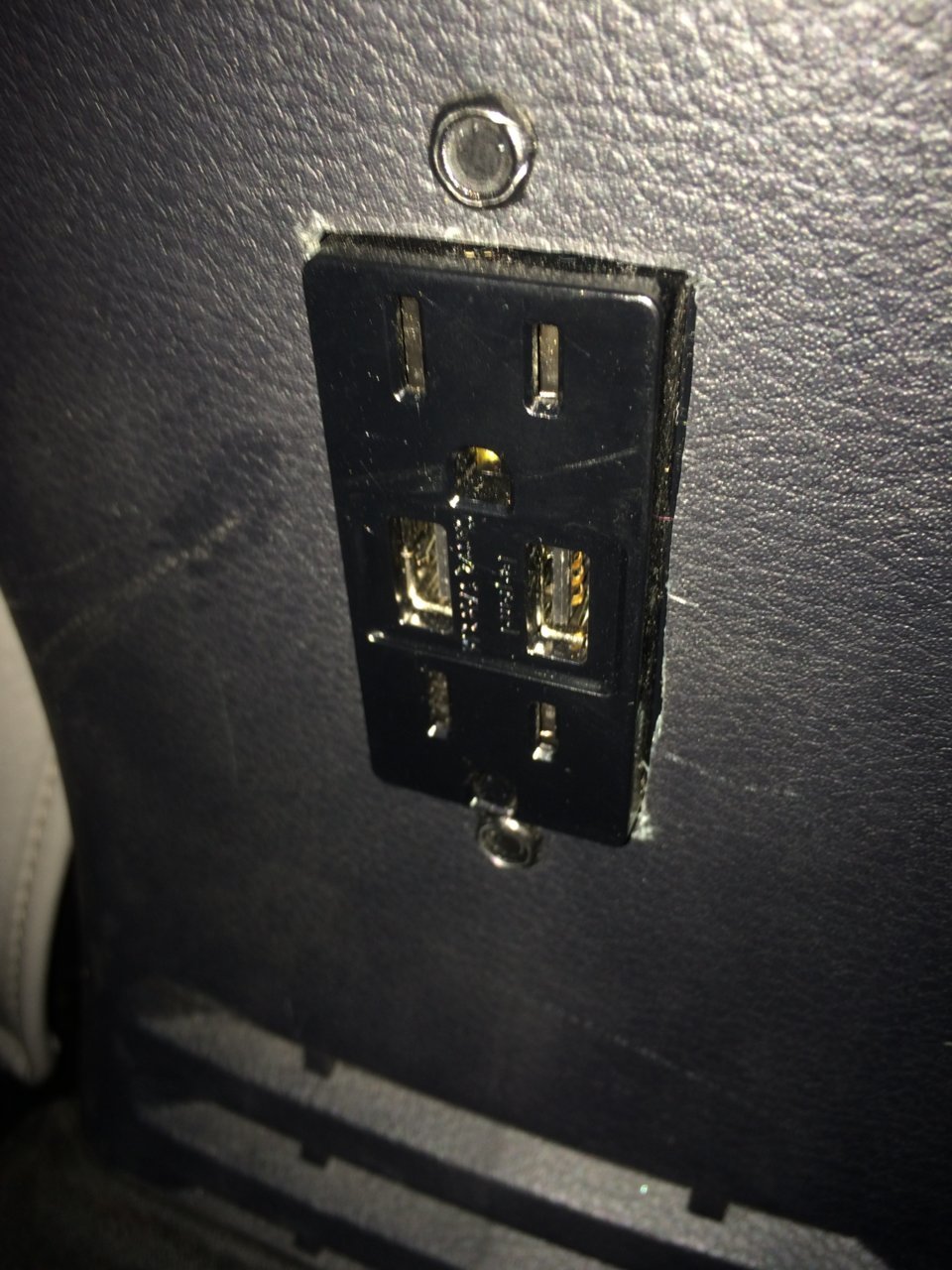

    Stock...for now. GFC Camper pending
    I added the same mod as well. This was very helpful!
