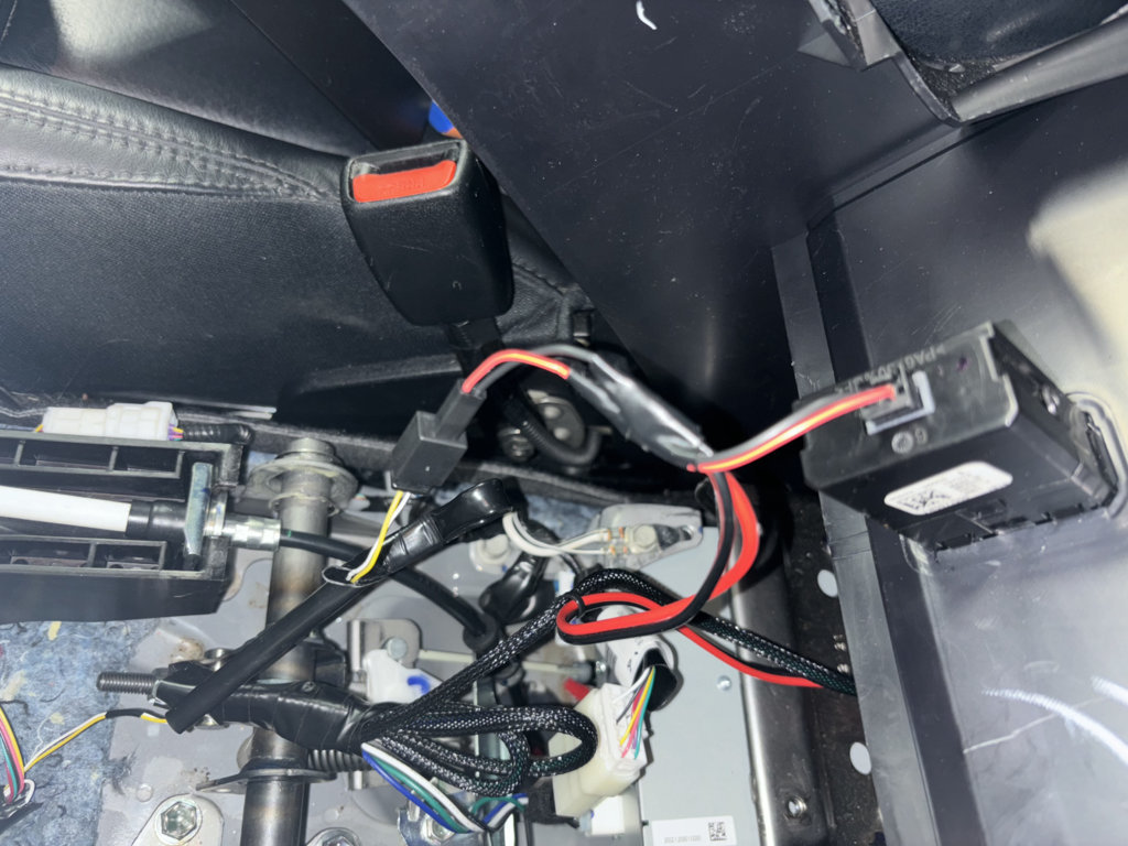

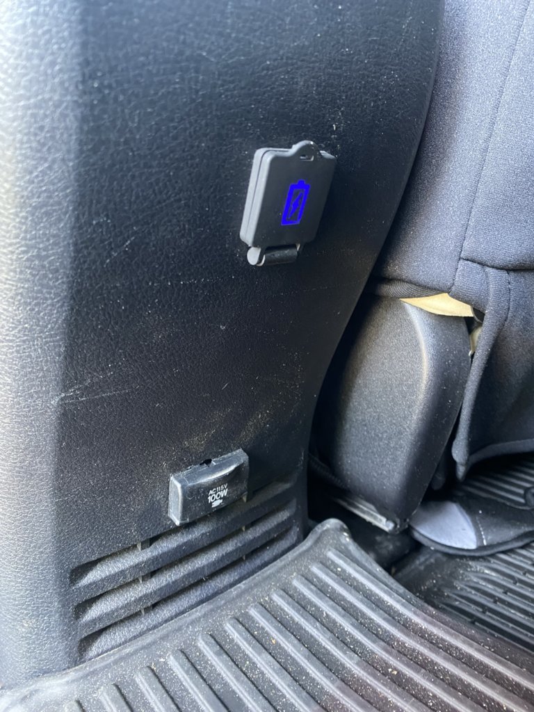

    I finished this up myself today. Did the 400W anytime mod with interior outlet from Guild Outfitters, and added a combo (1) USB-A and (2) USB-C charger. I thought I'd make the USB charger cool and plug-and-play so it was removable and so it used the stock wiring/fuse for USB. I bought the plug that goes to the OEM USB port in the center console storage area (the female plug is 90980-12D25 and can be bought with the corresponding male plug on AliExpress for insanely cheap) and made a short extension, cut off the in-line fuses that came with the new USB charger, and then soldered in the wiring to the new USB port. That way, should I decide to swap out the USB I just installed with something else, I can do it without having to de-solder anything.
    JST connectors: take your time. I recommend ordering two sets of the plugs, as they come with pins that you might mess up on your first attempt, or you might put one into a connector and then break another, so having back-ups is handy. <ahem>
    If you want to keep all of the pinstriping on the outside of your vehicle, I recommend setting these trim pieces on a towel or carpet while you work on them, not on the garage floor like I did.
    This is the tap I fab'd up. Solder connections taped and leading back to the new USB port. Getting all of the wiring tucked away safely so it didn't rub on the moving hand brake parts was a bit of a hassle, as there's what appears to be a lot of room in this area, but not a lot of places to easily secure something. I recommend lots of wire tape.

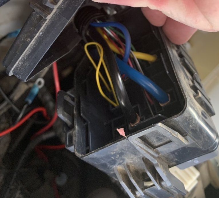

    There are to connectors to the OEM inverter. The one connector (2 spot) supplies fused juice via relay and the other ground. THOSE aren't tiny at all.
    Now the other connector which supplies various signals to the inverter and the 3 that provide A/C (3.33 Amps Max) are small gauge indeed.
    Engine room aux relay box, showing wires of Inverter Fused power Relay...
