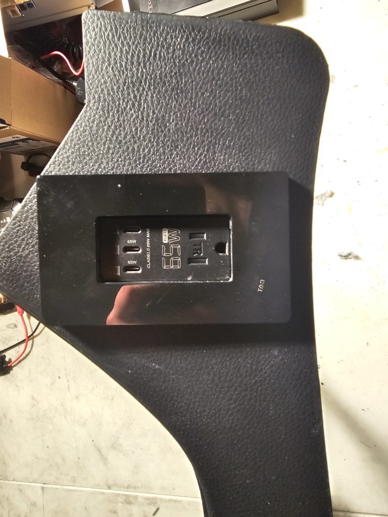

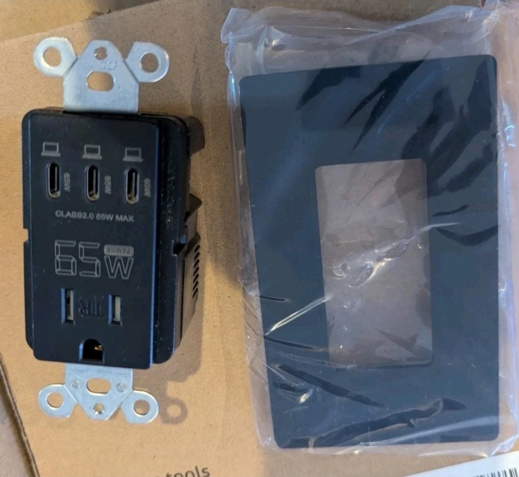

    EDIT:
    DO NOT GO WITH THIS ONE!
    It looks like it doesn't like the dirty sine wave coming out of the thingamabopper. tested with two units neither of them worked. same wiring to a USB c adapter from the house and it worked fine. I think we can safely rule these outlets as not working unless you upgrade your inverter
    here it is on my second center console

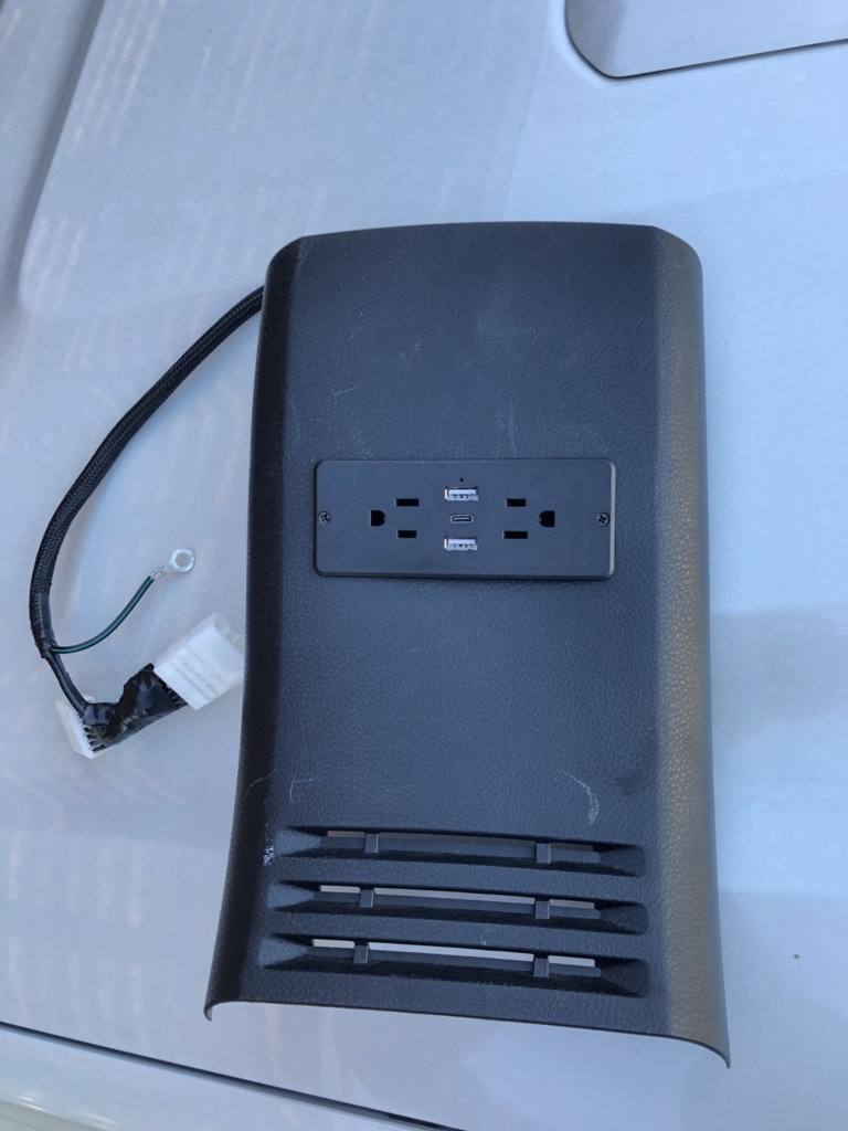

    Sideflare,
    Wanted to share an in cab version I make with everything already attached. Here’s the link: https://www.tacomaworld.com/threads/in-cab-ac-outlet-plug-and-play.829246/page-2#post-29844272
    If you’re particular to that outlet, I could make a custom version of the harness with flying leads so you could use the one you’ve already bought.
