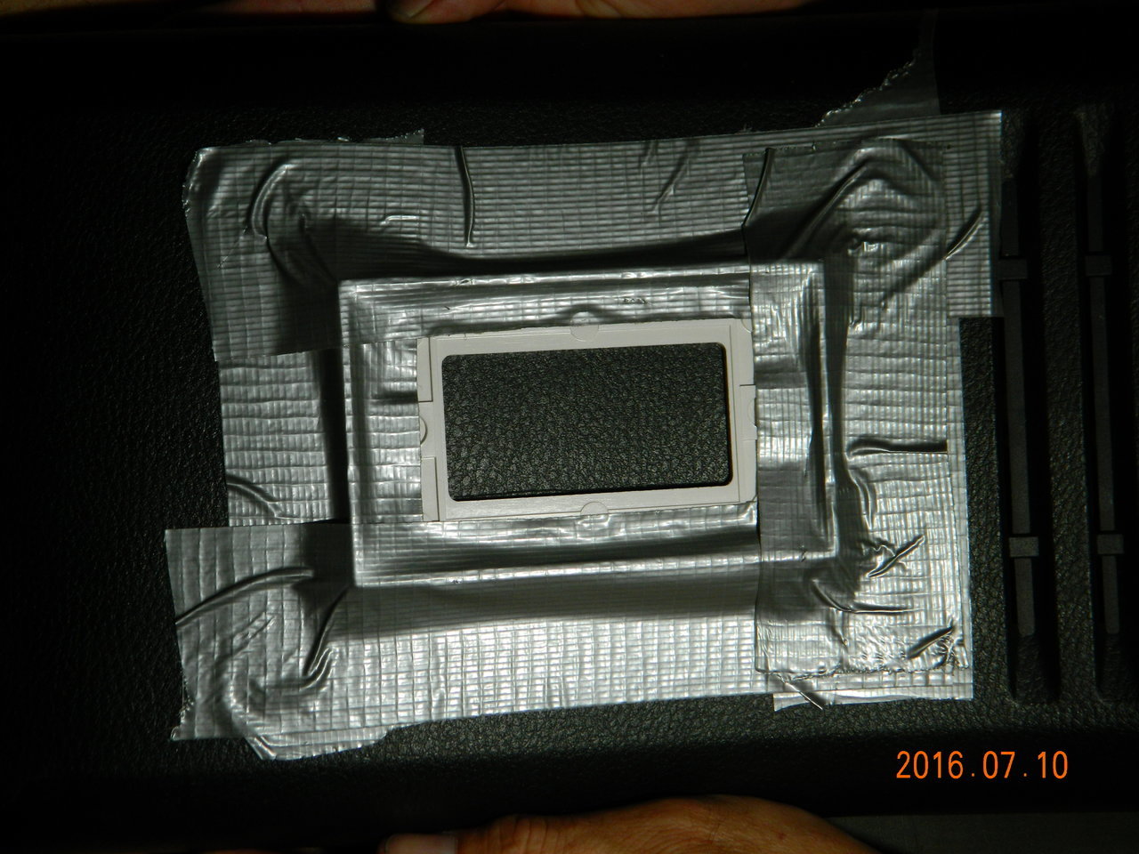

    looks a lot like what i posted last year .
    my kids charge everything in the back, the usb for the phone and the 112v for the camera battery or laptop for trips.
    And i needed the 400w while driving to run a slow cooker in the bed for a 2 hour drive to cook dinner along the way.
    and yes the black blends in good in the back, and you can tape a face plate to the inside for a templet

    Face plate for the template is a really good idea. Wish I had seen your post before I did this. I like how yours turned out.
