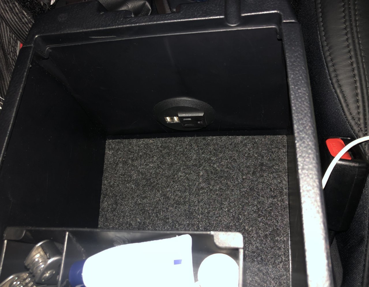

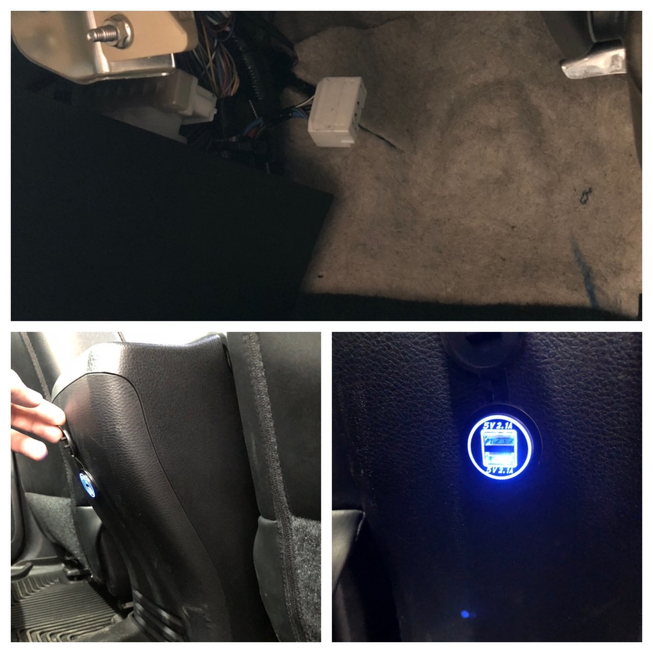

    0B4186B2-4175-4206-8ECA-87683335729B.jpg Nice write up. I followed it and worked great. I removed the factory 12v charger from the center console and installed an outlet/usb combo inside the center console. I also installed a double USB (always on) port in the back for the kids. I wanted a usb port that was alway on even when the truck was off just incase i needs to charge my phone.

    Looks good! Gonna tackle this mod next! Is that this grommet plug? Or a similar 2-2.5” plug?

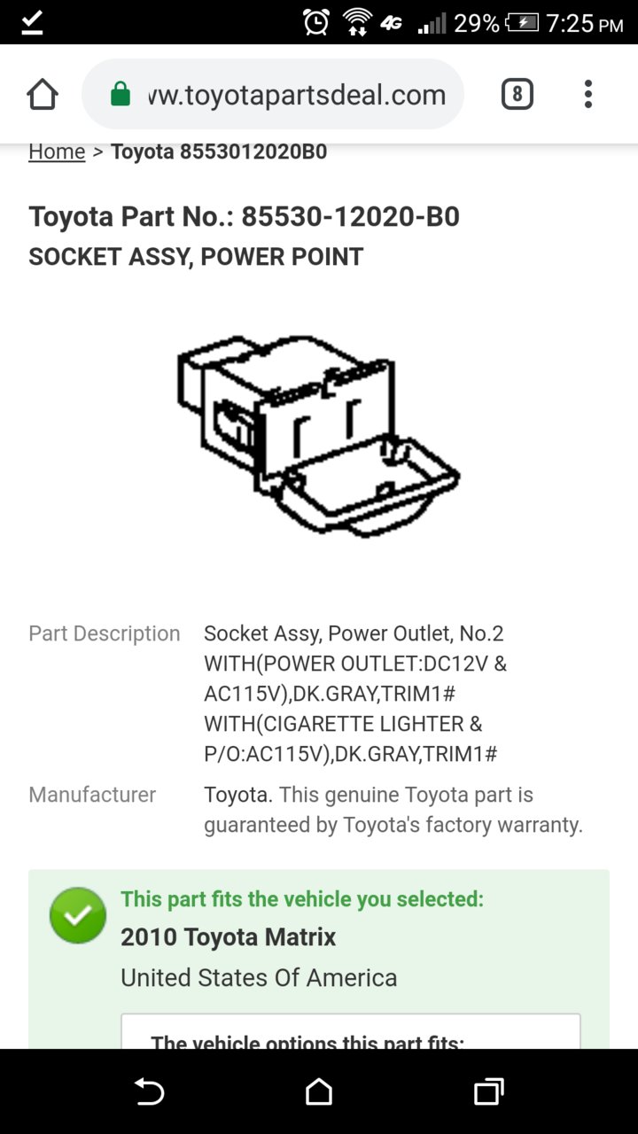

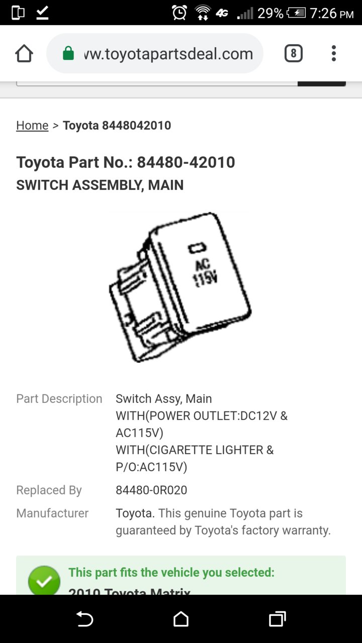

    Here's the part numbers for a factory Toyota style switch.

    Thanks! I did this write up over a year ago but it just started getting views. Happy to see it’s helping other people, that’s what TW is all about.
    Hey I’m really curious, where did you run the 12v from for your USB port to be always on?

    Right behind the drivers kick panel there is a wire harness that is not used. The blue 10awg wire is constant hot so i tapped off that. I have no idea what that harness is for so I bought a USB charger that came with an in-line fuse just to be safe.
