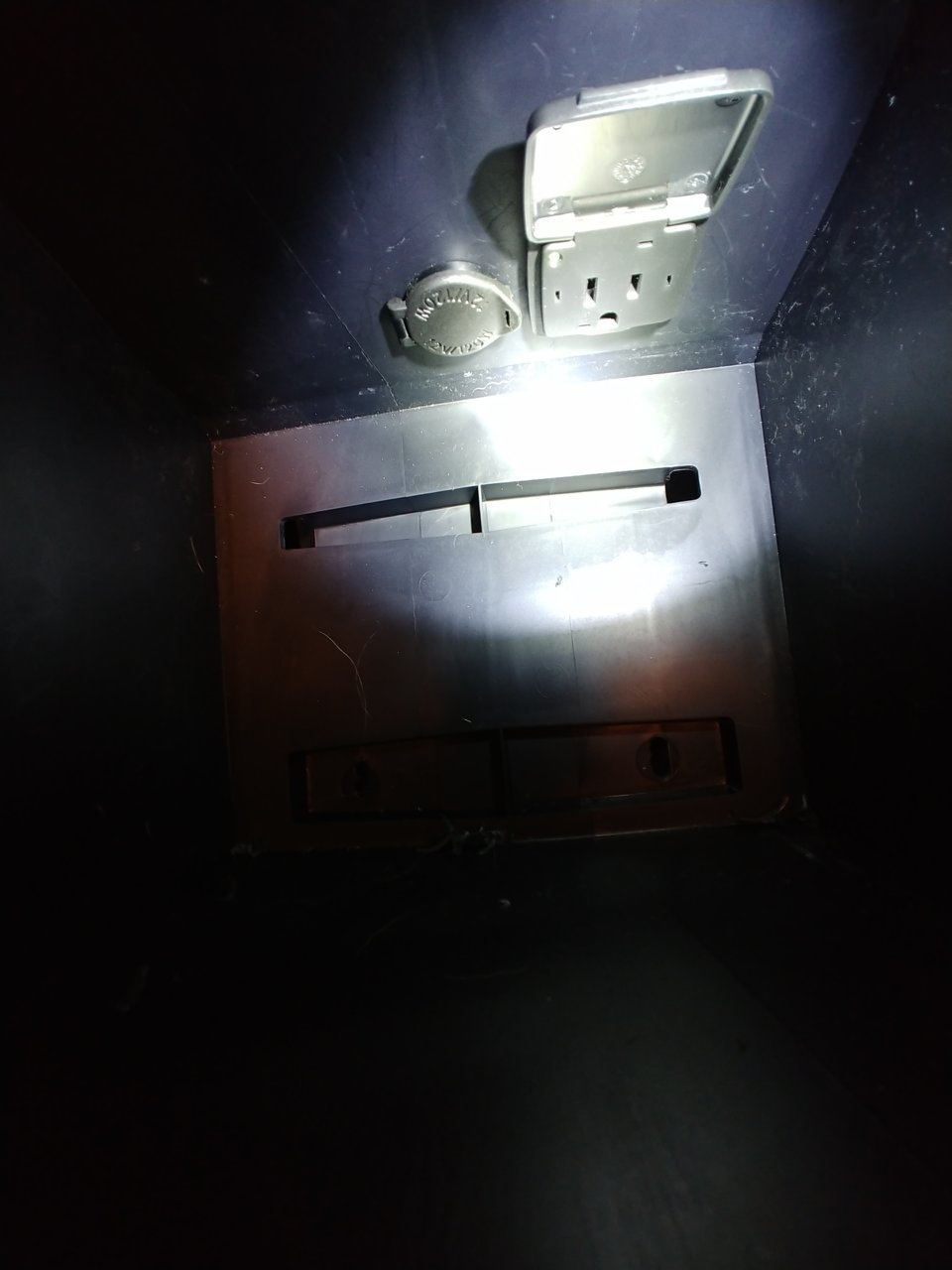

    I did this mod in my 2008 Tacoma several years ago and used a standard household electrical box with a standard faceplate. I wanted this one to look a little better for my 2016. I used a piece of Lexan to construct a small box to hold the pop-in sockets mentioned at the first of this thread. Thanks for the all the information in this post.

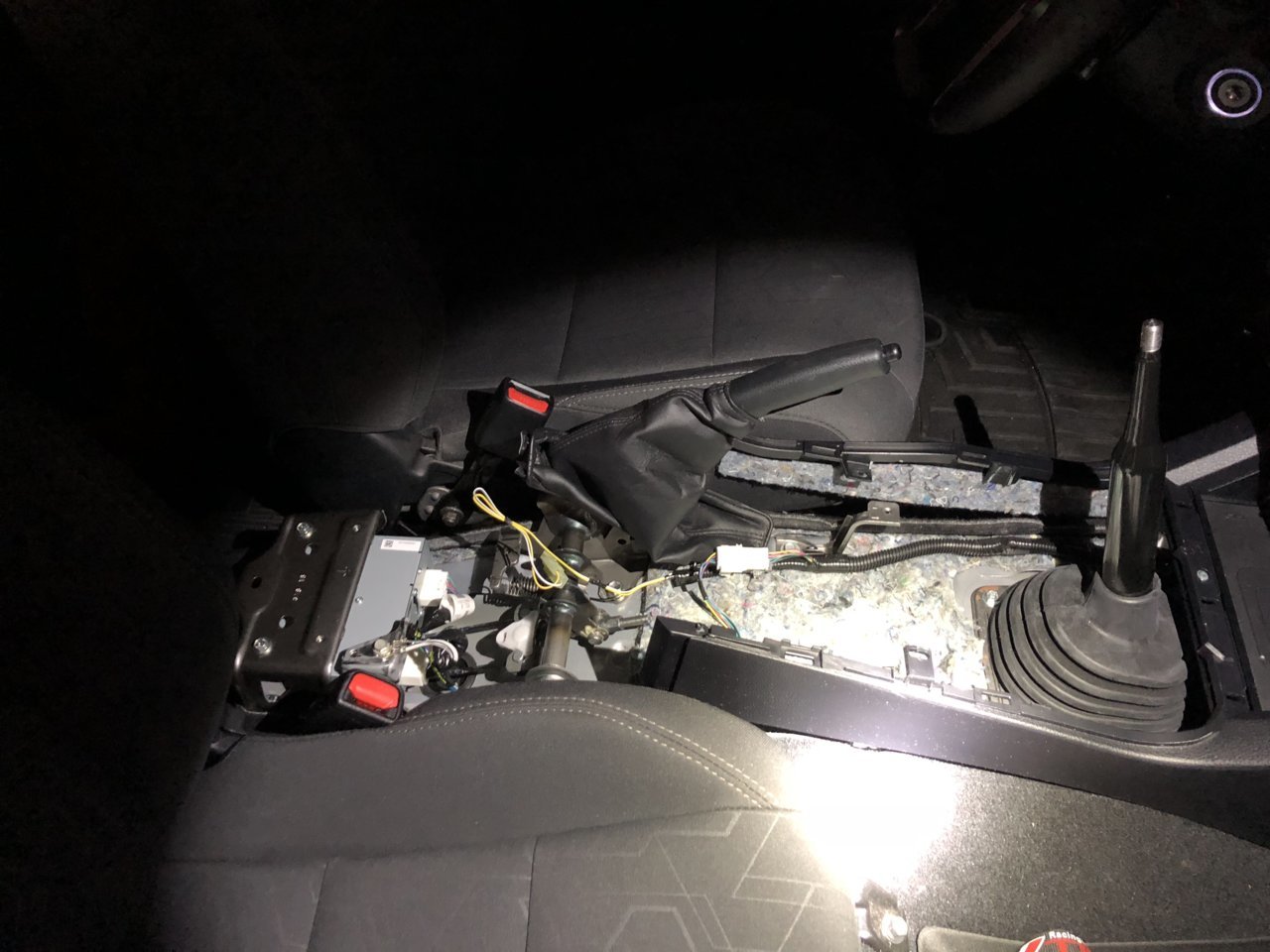

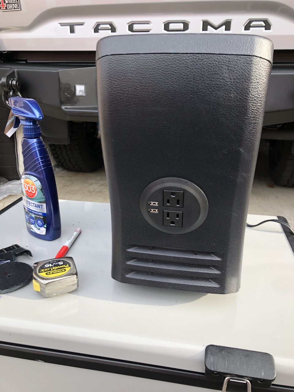

    Ok I’m in the middle of this and followed the other thread with the MT write up. Got the 400W anytime done.
    Now trying to figure out the AC outlet in the cab for the manual trans. Already have everything together, just have to wire it. Really just need the one wire figured out, already know the hot and neutral coming out of the converter.
    Anyone do this AC outlet for the MT? The AT version says ground the pink wire, but the MT is different.
    Any info is appreciated.

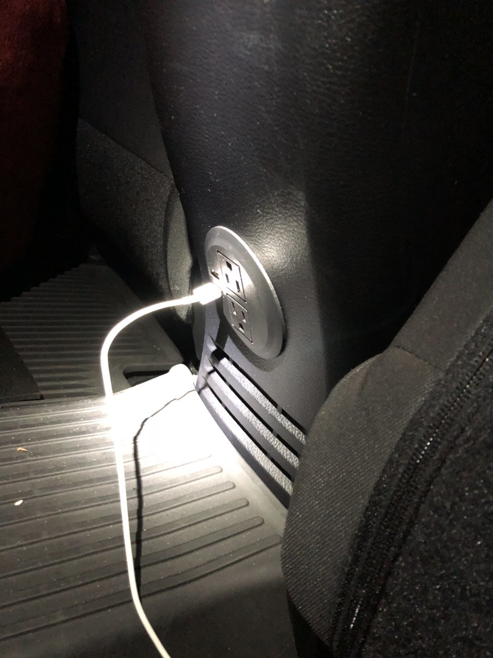

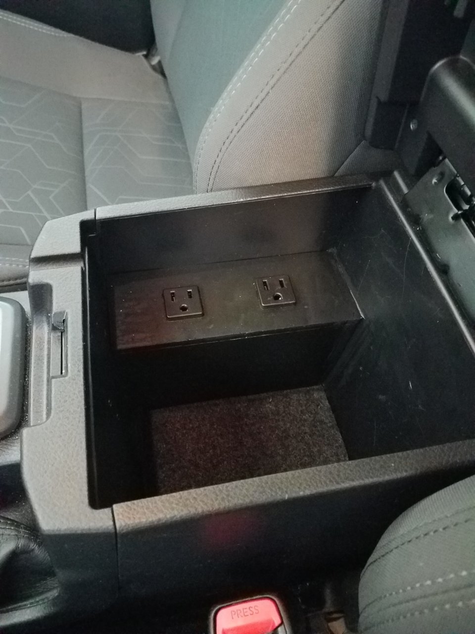

    Update all good to go, just wired the AC wires hot to white and neutral to blue and grounded the outlet, all works both outlets and both USB ports, phone is charging

    Looking good. Where did you get that outlet?

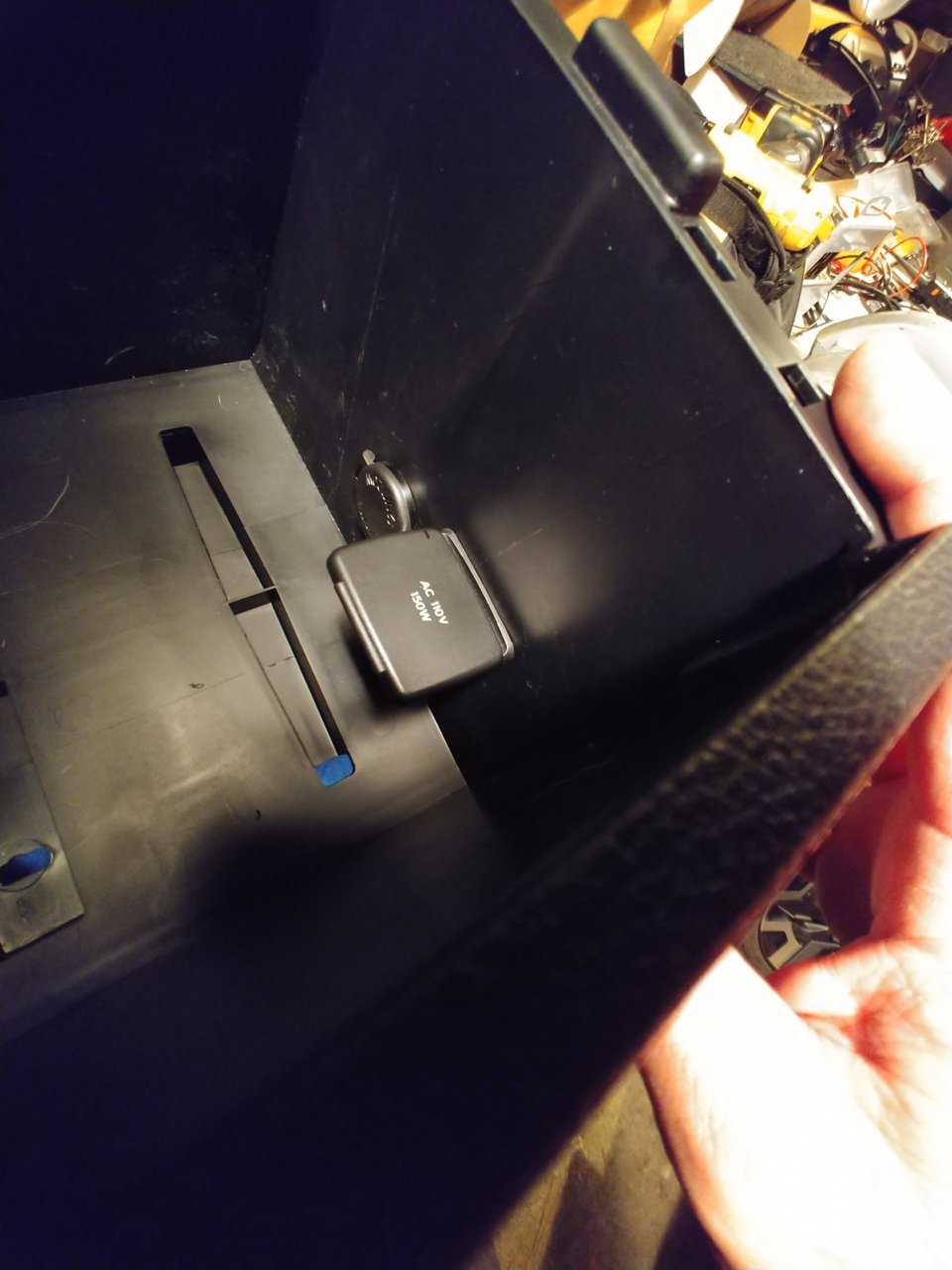

    I found this one on Amazon. It has Quick Charge USB. If you're gonna do this mod, I'd suggest using Quick Charge USB. It never actually says whether it's Quick Charge 2.0 or 3.0 but it does say it's Quick Charge.

    It doesn’t open up it’s flush with the console and wired to the inverter underneath.

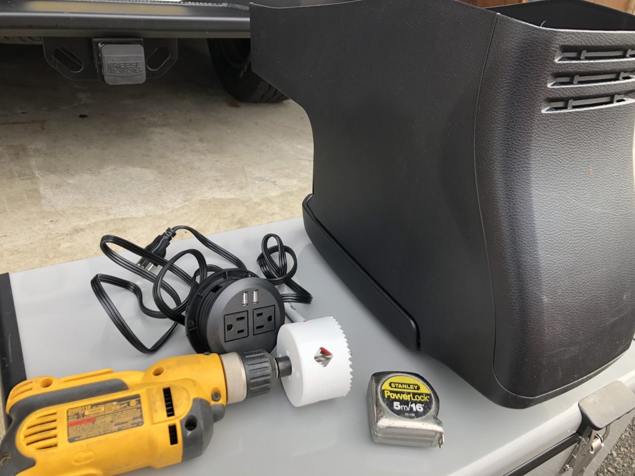

    What I was really getting at--
    I assume you cut the power cable that comes with the outlet and wire to the factory inverter like OP's post-- and I am wondering how you were able to match hot/neutral/ground. Can you see the connections on the back of the outlet to decipher which is which?
