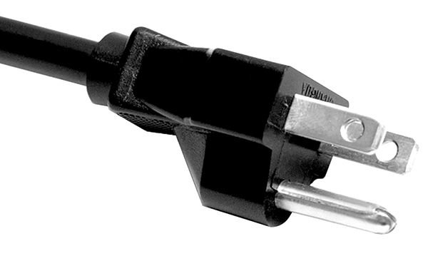

    Yeah I cut it, just use this for reference and keep track of the wires on the back of the plug before you cut it. The smaller prong on the other end is hot.

    If you mark the wires before cutting them you'll be fine. I thought of the same thing when I cut the head of the cable off. I ended up using a mulimeter to check continuity from the outlet to the end of the wires just to make sure.

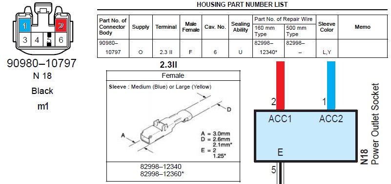

    I had my console disassembled for something else today and I made a note to investigate what these larger 8 gauge wires are for. I tested with my voltmeter and they’re the 12v in from the battery that power the inverter, in case anyone is still wondering.
