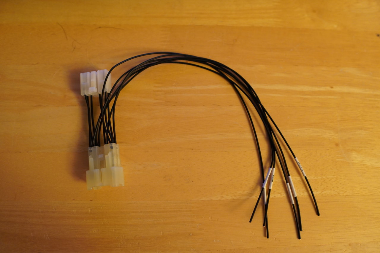

    Oh man, turns out there's many threads for people whom are asking the same things.
    So I bit the bullet and ordered one of these harnesses. I'm hoping they have all the necessary wires, so that I can tap into the one I want to trigger the fader I'm going to use for footwells.
    @caribe makaira - I really learn a lot from your posts. Question: is there 1 source for all the wiring in the vehicle?
