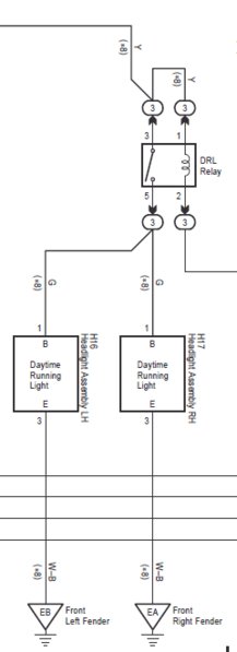

    DRL - ECU controls the ground side of the DRL relay (pin 2)
    DRL Circuit - 10A (factory)

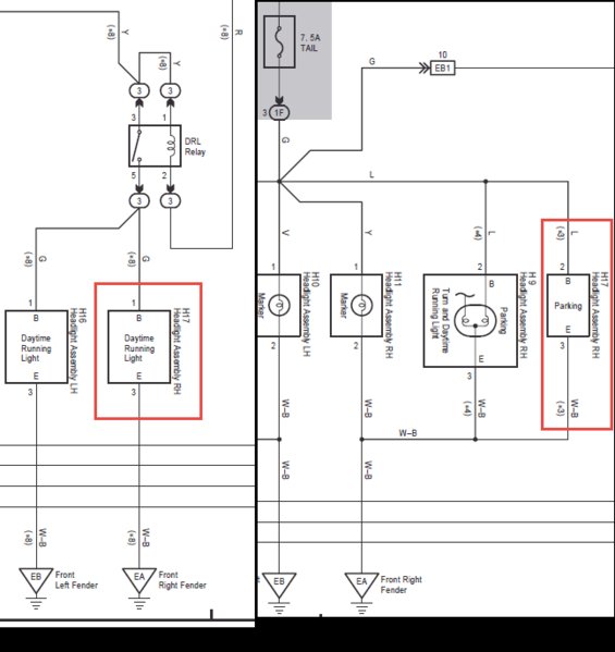

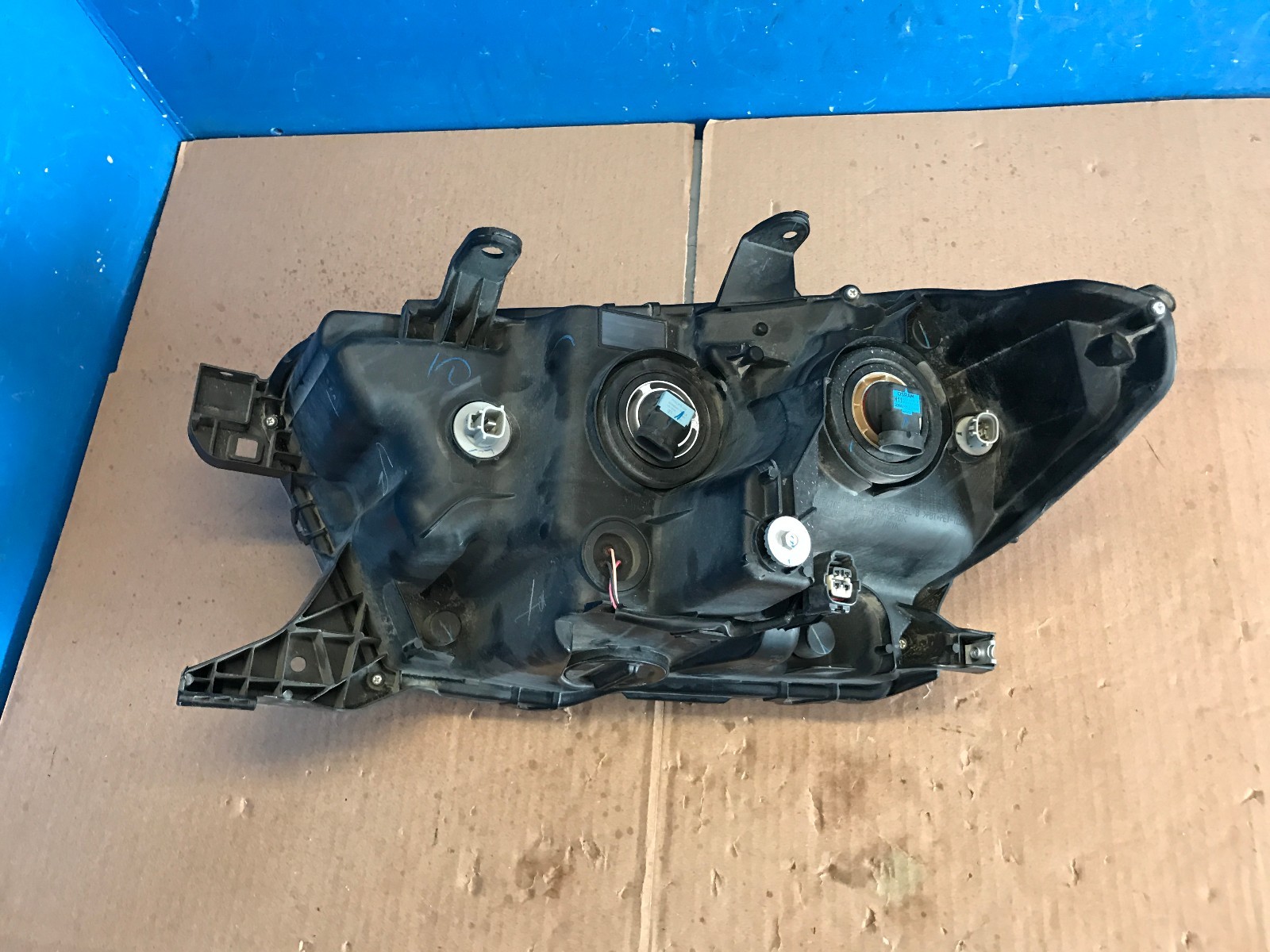

    Thanks to @fergyz post, I think I've finally figured it out.
    Here is a picture of a 2016 non-LED bar headlight:
    Here is a picture of a 2016 LED bar DRL headlight:
    Notice the additional 3 wires coming out of the light through the rubber grommet in the middle? And the 4-pin plug directly to the right of the silver screw/washer? That is the DRL plug/relay that was posted before.
    Seen here:
    Then I found this wiring schematic in an instruction manual for an aftermarket kit for a 2016 Tacoma that does not have factory DRLs. The schematic shows that pin 2 (which is the same thing @fergyz said) provides +12 VDC when ignition is on, with DRL switched on.
    PDF here: https://cdn.shopify.com/s/files/1/0176/5842/files/00016-35054_toyota_mcdonough.pdf
    (page 12, see Connector C-4 description)
    So basically, you have 3 wires going to that plug. Red, yellow, and black.
    Judging from the the wiring diagram provided and this other picture found here:
    It appears that the red wire is the Pin 2 wire. I will test with my multimeter to confirm before tapping the wires. I'll post my results once complete.
    Thanks again guys!

    H16 & H17 Connector wire pinout
    1 = Green or Gray / DRL positive - powered by relay (ECU/BCM controlled)
    2 = Light blue / powered by parking light circuit (Tail)
    3 = White with black stripe / Ground
