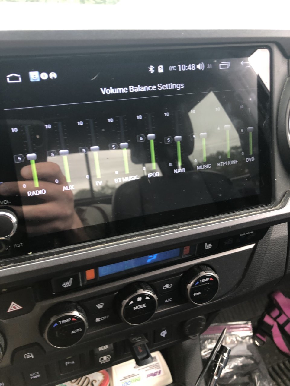

    I got the joying and can only get very low sound out of the tweeters, rear speakers and sub. Have the jbl in the truck. I've had two other vehicle with android headunit and upgraded oem audio and was plug and play with factory amp. Hitting the amp button in the settings doesn't do anything. Says not available. Think it's not triggering the amp. Anyone get anywhere with these

    I got it working with the jbl system and without any other add-ons, trimming. Turned amp on and started working. Weird cause yesterday was grayed out. Everything works, steering, vehicle info. Now to get rid of that dot and figure how to switch on the video in for front cam

    All working just still low sound, at max 36 is like oem 36. Changing input volume in settings doesn't do anything whether on one or ten, in any input. Get no sound until 10 then it does work. Sounds clear. Just not loud. Also can someone link the right mcu update. If you change the input settings, you have to restart the headunit. The px5 chipset ones used to restart as you exited the settings. Have to manually do it on these
