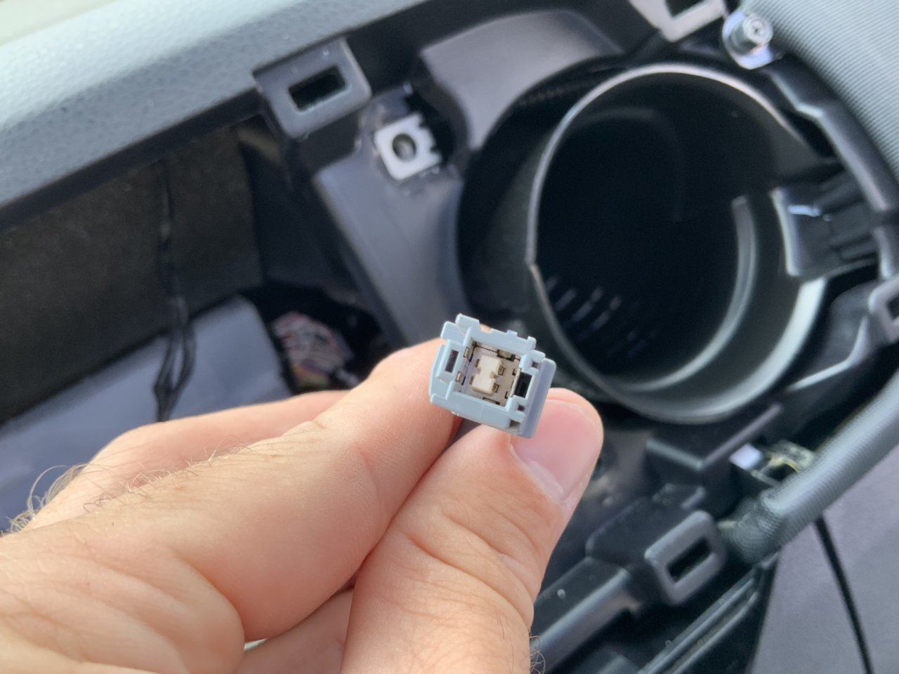

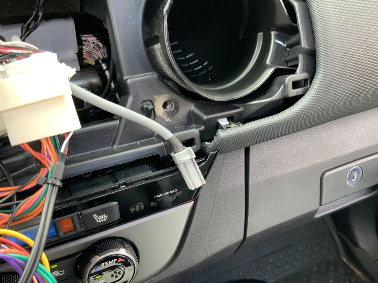

    Does anyone know what this is supposed to be plugged into and what it does. Can’t seem to find out where it goes.
  17. Jul 25, 2019 at 4:07 PM
    #217
    BEAR_KNIFE_FIGHT
    BEAR_KNIFE_FIGHT bearly famous
    May 21, 2016
    #187524
    2,628
    Alex
    Minnesota
    2016 TRD OR 4X4 DCSB Slowsand, 2017 WRX WRB
    Pretty confident that's the stock GPS antenna. Not necessary for the new HU.
