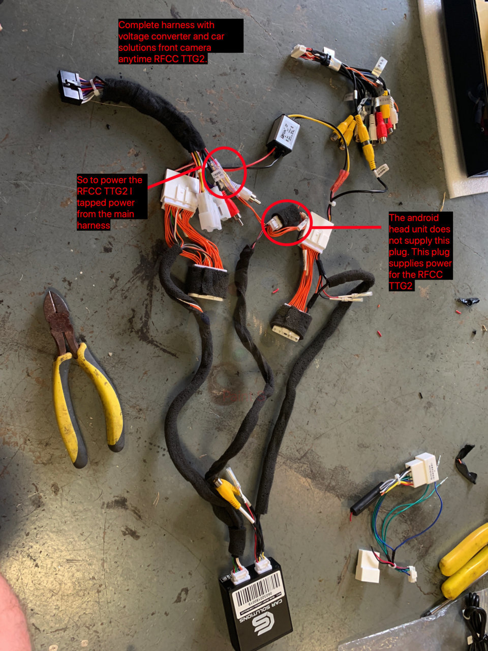

    Maybe I missed it it but were you ever able to confirm this to be working? Did you get the Car Solutions Anytime Front and Back Camera that is activated with double tapping the Mode button on the steering wheel?
    Since it uses the same wire that goes into the entune and with canbus all steering wheel options seem to be retained, I would assume that this works.

    Yes it works with the Anytime Backup Camera kit(https://www.anytimebackupcamera.com/). I do not know if the Car Solutions kit will work but from what I gathered, it is only compatible with the Entune radio.

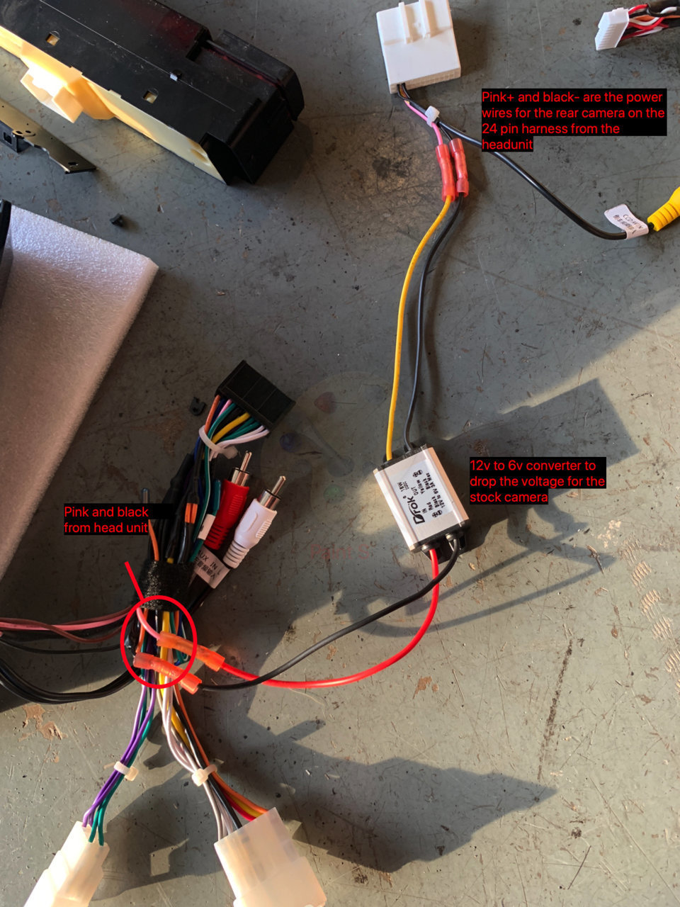

    I have a 2nd gen with an android unit and the car solutions kit and it works great. I did have to modify one plug as shown in the photo.
    I needed a voltage converter for the 2nd gen. I'm not sure if its needed on the 3rd gen.

    I believe the camera on the 3rd gens are 12v so the voltage converter should not be needed.
