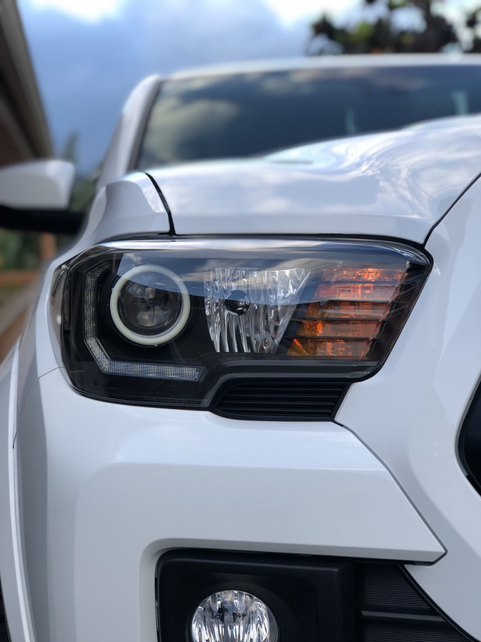

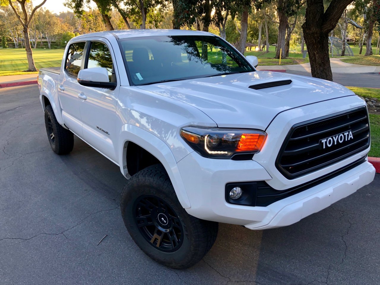

    Got everything put back together and I must say that I am very satisfied with the results. Being that this was my first time opening up a headlight, the project was not very difficult but I will admit very time consuming.84DAE343-C77F-4C3A-9B44-443973CDFA04.jpg

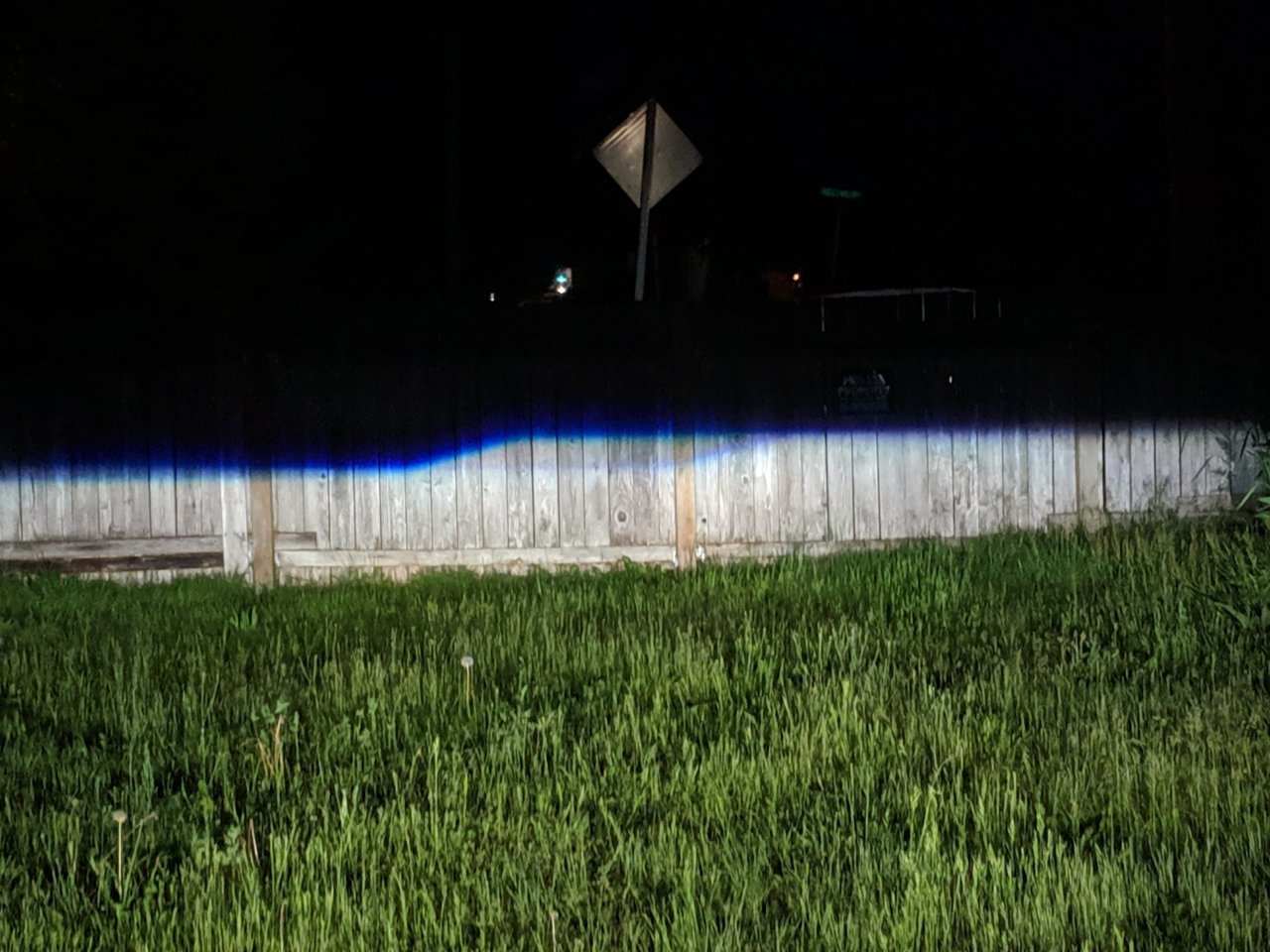

    Nice. I have considered trying those because they took care if that giant step from the 4.0s. If you can snap a pic up close by chance, that would be great :D

    Let's see some cutoff pics too. I want to upgrade projectors already lol

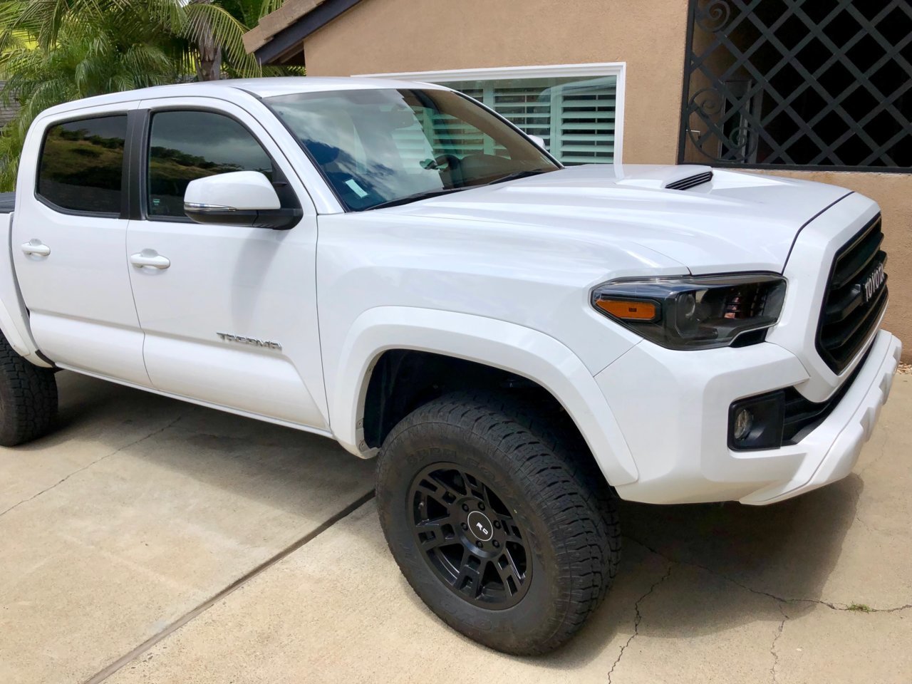

    I used the Krylon Matte Black spray paint and made my own acrylic amber inserts (got a couple extra pm me if you need one). Also I'm running LED turn signal bulbs.
    Also I wanted make the reflector bowl of the brights look as dark/smoky tint as possible without having to harm the light output. When I opened up the headlights I found a couple of extra spots you can black out that won't harm the light output but will help darken the reflector bowl as the reflector bowl picks up the blacked out spots.

    Done. Worth every minute spent on doing this job. 522643AE-9452-48CB-A83B-2DB7B6E62A56.jpgEBA542DB-7D21-4706-B229-391DC31C3C24.jpg

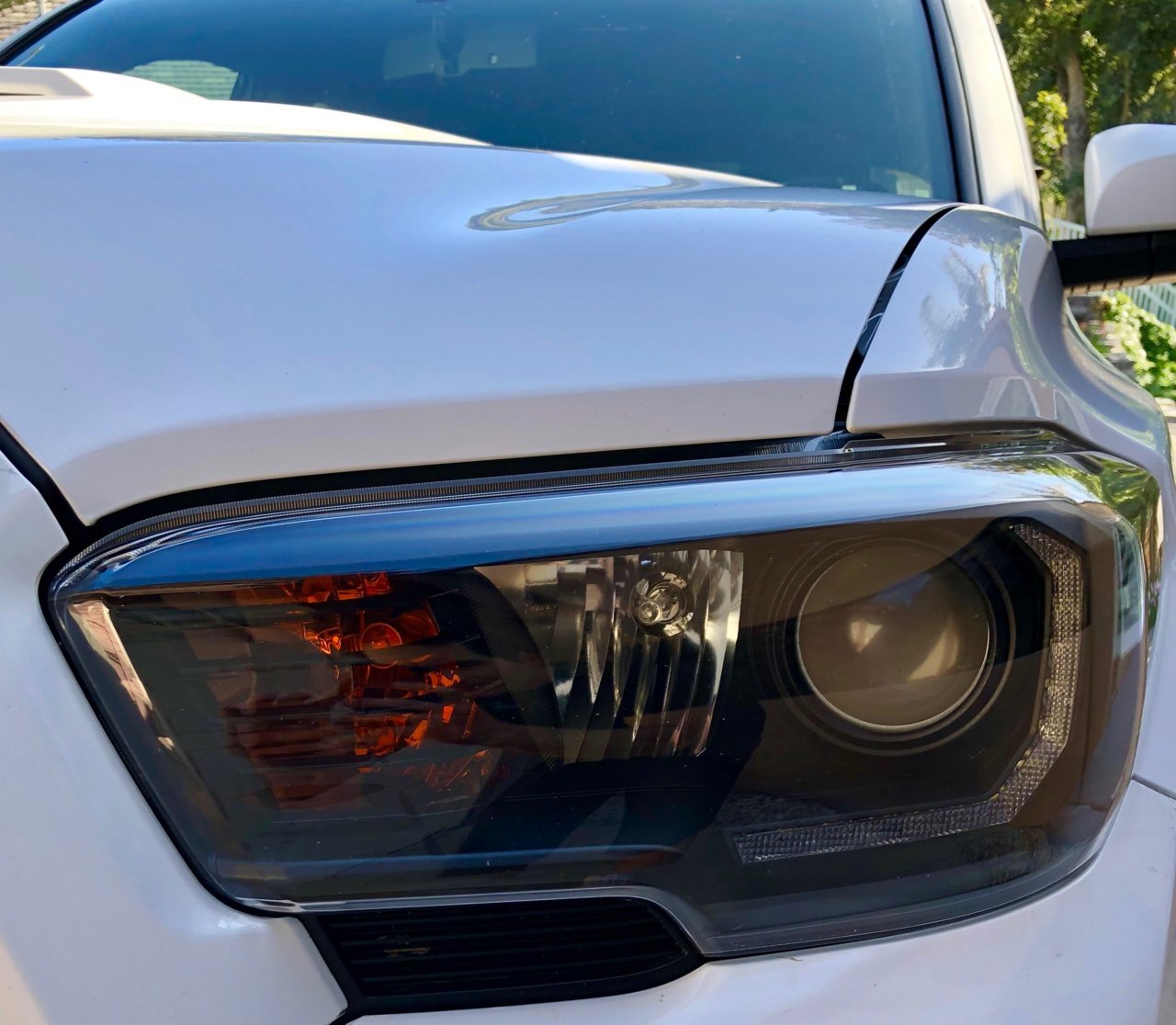

    Ok here are some crappy photos. You can't see the gap in person, but my camera is able to pic it up. I'll probably have to tear them apart and fill the gap now that I know it's there:bananadead:

    Looks good, and I love that AR coating. What bulbs are you running?
    The gap isn't quite as noticeable as I thought it'd be.

    Yeah, I'd never have noticed it I wasn't looking for it. In fact, looking at other photos on here the stock projector has about the same gap.
    Those are just Morimoto xb35 5500ks.
