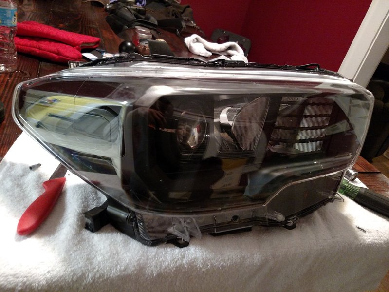

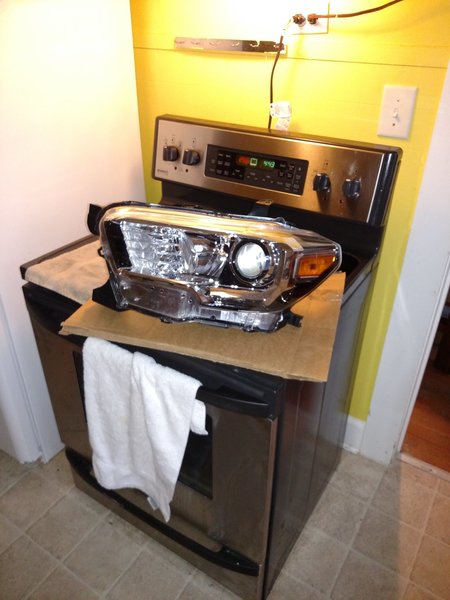

    The first ones in the oven.... I'm terrified

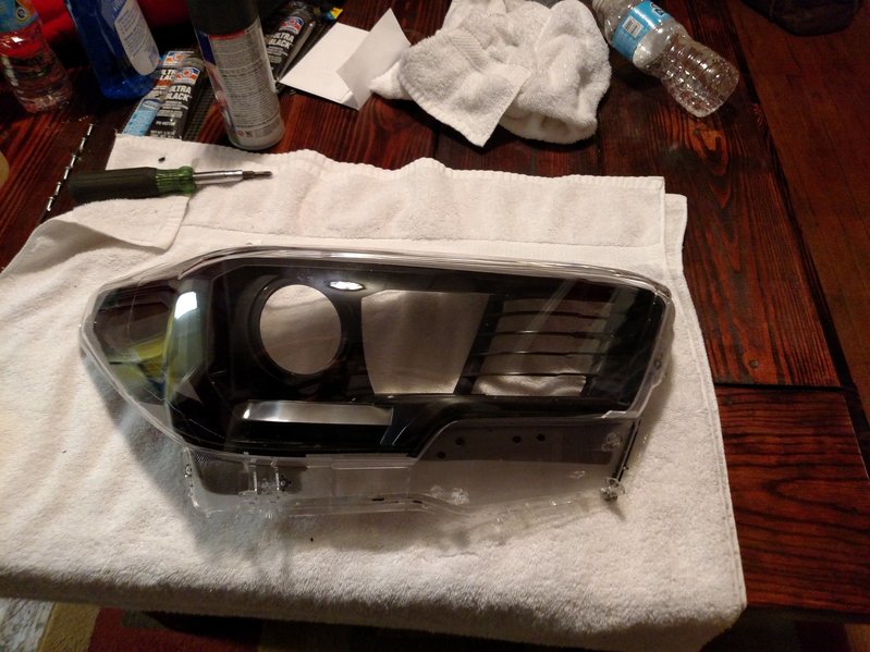

    Got one opened... Working on the second one while the paint dries

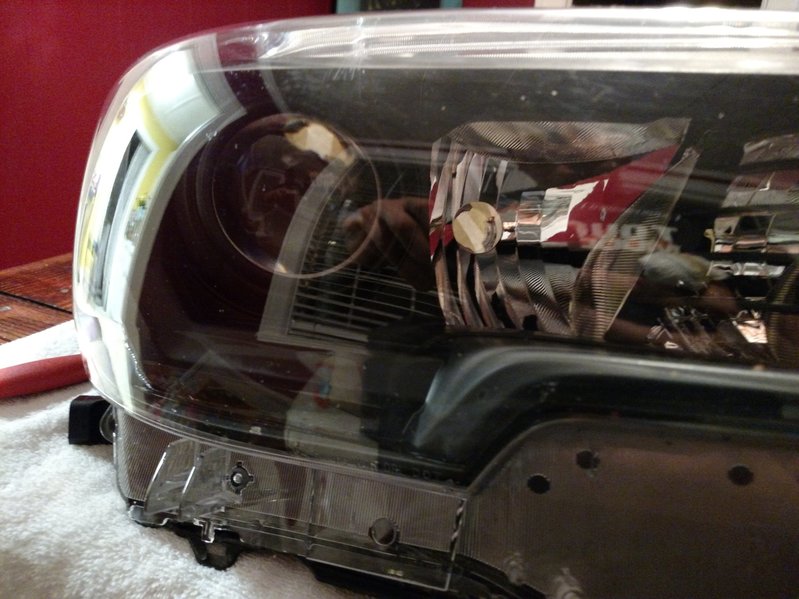

    It wasn't easy, that adhesive is like rubberized concrete. Toyota must have invented it just for this... More pictures to come

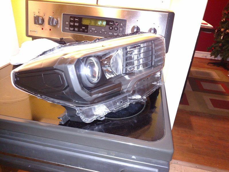

    I will be opening up mine too, retrofiting rx350 projectors. Is the seal melting at all or just becomes softer from being in the oven? Post picture of the glue it self if you still have them open

    They're done, will post pics on the truck tomorrow

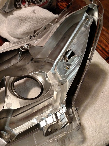

    The glue is extremely hard. It never really breaks down. It just finally pulls off of the lens or the housing in one piece when you pry..... And I don't mean ONE piece altogether. It just stays on one or the other. It's hard to explain. Kinda like they glued a piece of rubber in the seam

    Permaseal, unlike regular butyl they used on older cars. A huge PITA!
