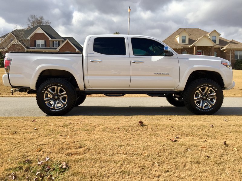

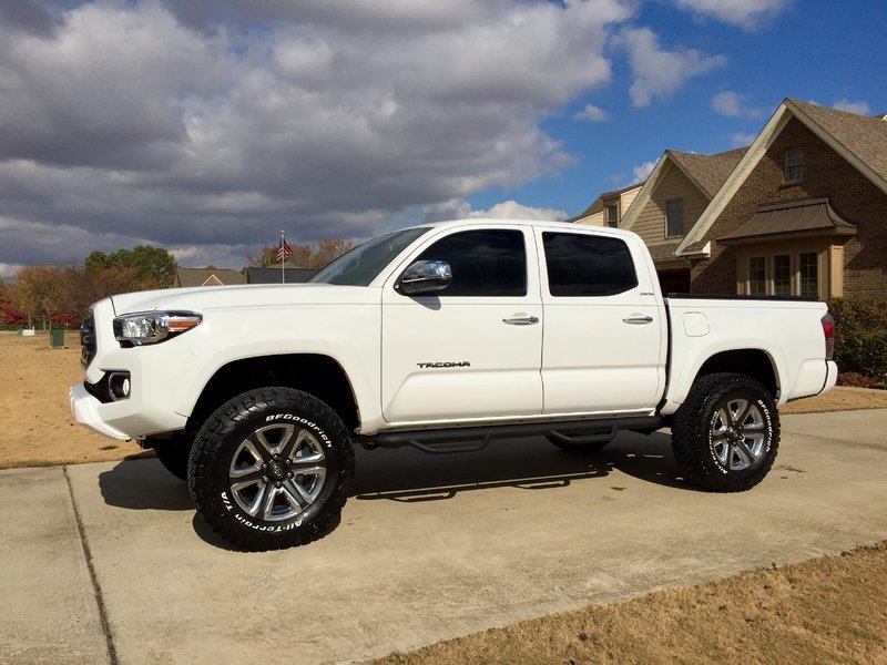

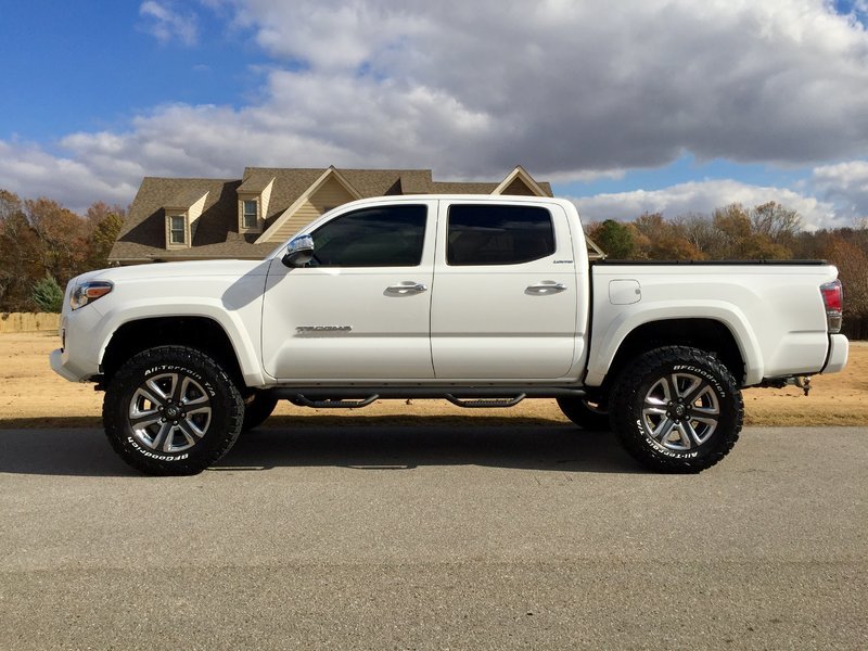

    3rd Gen 5100s all around. Fronts set on first notch (0.65") with OME 887's and HS AAL in the rear. Drivers side lean spacer installed and rear overload spring left in. Diff drop installed. Tires are 275/70/18 KO2s on stock limited wheels, 1.25" spidertrax spacers. IMG_5113.jpg IMG_5109.jpg IMG_5104.jpg

    Moar pics please!

    Beautiful setup ! functionall but yet elegant .

    @ReidBoehm Great setup!

    Damn, that looks clean. Nice ride.
