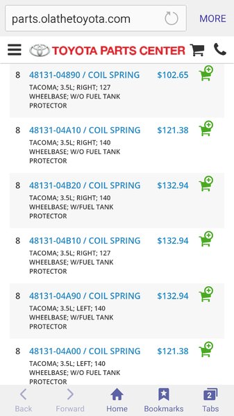

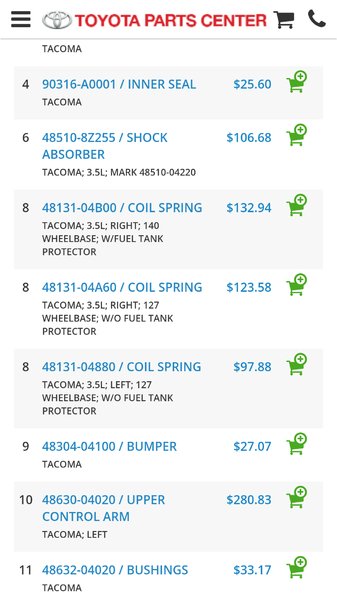

    All four of those are for a sport because that's what you selected. 127 is the access cab it has 2 sets with or without fuel tank protection. (4x4 vs 4x2) The other two are for dc with or without fuel tank protect. (4x4 vs 4x2) different coils for different amount Tacoma lean.

    Yet one shock to rule them all? And wrong again, they were the 6 v6 options because thats how their catalog is setup. All based on weight... and since the heaviest 2nd gen is heavier than the lightest 3rd gen, the "must redesign because 3rd gen" arguement is wrong.

    There a total of 9 coils list on the page you attached. 6 in the top set and 3 in the bottom set. They are sold by individual side, wheel base length and fuel tank skid. I looked at all the models and these nine coils are the only ones available on this website in v6 and 4 cylinder. They must use the same coils across different setups unless the catalog is not complete.
