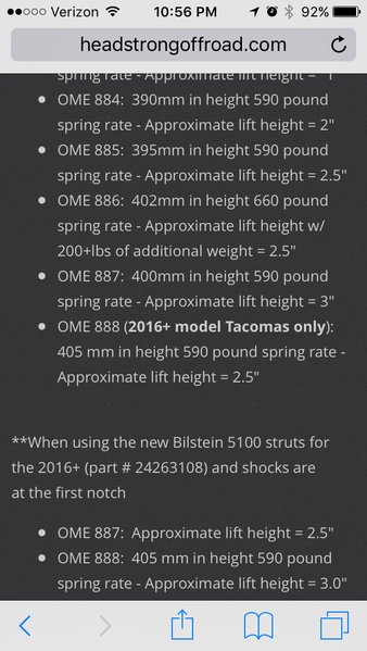

  10. Oct 11, 2016 at 8:14 PM
    #90
    RBfastback
    RBfastback It's Got Electrolytes
    Jul 26, 2016
    #193004
    401
    mike
    FL
    16 mgm TRD off road
    changed

    I think what youre seeing is the top 887 is info for the 2nd gen. Bottom is 3rd gen. Both 888 are 3rd gen.

    I agree sees funny the way they wrote it.
    Bottom 888 is for 5100 set at first notch giving the extra .5 inch.
    Stock 3rd Gen comes 1 inch taller than stock second gen. 887 lifts 3 inches for 2nd Gen vs 2 inches for 3rd gen because of the different stock heights. Both come gens come to about the same height with the 887 or any of the lifts.
    Toytec has a good write up on the 3rd Gen section. I believe it's in the sticky section.

    So we do plan to put together a chart so its easier to follow, for now we are recommending people call us. What you guys need to consider is the ZERO setting on both 2nd and 3rd gen shocks are speced out differently, I think this is what's causing confusing. The 3rd Gen Tacoma 5100s will provide more initial compression thus yielding more lift over the older 5100s despite the shorter extended length. In the description the first portion describes lifts for both 2015 and 2016 (the shocks work for both Gens) using the older 5100 shocks. The second portion will provide the anticipated lifts for the 2016 + Tacomas using the newest 5100s.
    But yeah note taken and I'll see if we can provide a little more clarification on this until we get that chart complete.
