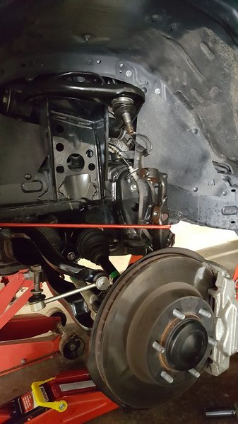

    I just wanted to make a really quick review of my experience with installation and functionality of the Bilstein 6112/5160 combination on a 3rd gen Tacoma. Others' experience may differ.
    What I have:
    2016 TRD Sport 4x4 DCSB
    products purchased
    -Bilstein 25-242379 (Rear Left)
    -Bilstein 25-242539 (Rear Right)
    -Bilstein 46-241627 (Front R&L)
    -Heastrong Off-Road 1/4" spacer
    Background
    So first off let me make very clear that I am NOT a mechanic but I enjoy learning and thought of this as a challenge to put myself out of my comfort zone to learn something about my truck that I didn't know previously. I did have help from a neighbor and I could not have done this without him.
    Review
    I decided on the Bilstein combination because I think it's a great value and a great introduction to the world of suspension. My wallet couldn't afford a higher end kit such as Icon but I didn't want to go cheap with just spacers and lift blocks. I did my research and the 2nd gen crowd seem to love this setup so I pulled the trigger. Before I achieve total lift I am separating the process into 3 phases. Phase 1 = shocks & struts. Phase 2 = UCAs and Leaf springs. Phase 3 = A/T tires and stainless steel brake lines. Today I am just talking about Phase 1.
    Going into the install I had (still somewhat do) very little knowledge of how suspension works and what I was getting myself into. I followed this youtube video to remove the old struts and it was pretty much a breeze.
    https://www.youtube.com/watch?v=bbsTJgb6S_c
    That was the easy part. Everything else pretty much fought me the rest of the way. The biggest problem I ran into was the assembly of the 6112s. After disassembly of the Hitachi coil-overs, I realized that the set of spring compressors I rented from the local Autozone were too fat and would not leave enough room for the strut to slide through after the spring was compressed. At this point I was faced with the dilemma of either putting it all back together or using the compressors, I could get them to work they just wouldn't have a perfect seat onto the spring. Well I'm not proud to say that I voted the latter option. And while I was lucky enough to not have an incident, I strongly recommend that you have a shop assemble the coil-overs for you unless you have access to commercial equipment. Better yet, spend the extra $$$ and save yourself the hassle by having the shop you ordered from assemble for you. I do not endorse my own stupidity, the situation could have been life threatening if went wrong.
    So I assemble the 6112 on the lowest (1st) notch. I read that this would give me approx 3/4" lift on the front just enough to level the front and give me a bit more clearance. I also used the Headstrong Off-Road 1/4" spacer on the driver side to account for the "Taco-lean." The rest of the front strut isntall went pretty smoothly. The 5160s I thought would be the easiest but even those threw me off. The brake line spacer they include in the kit does not fit very easily and the bolt they include IMHO is not long enough. There is maybe only 3 threads holding the unit down to the axle and I plan on replacing the bolt with a longer one as soon as possible. On top of that Bilstein forgot to give me the reservoir bracket on the right side and I didn't realize it until I was already half way through installation. Lesson of the story is: Take inventory before you begin to ensure you have EVERYTHING. So the right side reservoir is currently being held up with zip ties to the frame while Bilstein is shipping me the missing bracket.
    After all was said and done I got an alignment done and it rides great. There is no "Taco-lean" that is noticeable. While I'm sure the shocks are still breaking in they do feel like they absorb better than the Hittachi shocks but there is more body roll as well. I guess that is kind of to be expected. My only regret is it doesn't seem to have much lift on the front as i thought it would. Looking back I probably would have set to 2nd notch for a better level. I'll let you decide for yourselves with the pictures. I have not taken any measurements yet but I'll post those as soon as I take them.
    The kit
    Taking out old strut
    Old vs New
    New Bilstein 6112 installed
    New Bilstein 5160 installed
    Truck before Bilstein kit.
    Truck after Bilstein kit set to 1st notch. No lift in rear
