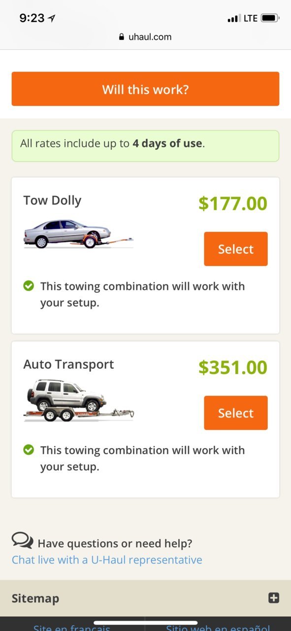

    Not sure yet about which trailer to use. I think a trailer would be ideal. It’s normally a 12 hour drive. Not too sure on the exact trailer weight since I’m renting the trailer, but 1,000 seems about right. Here is a reference photo for the two trailers.

    Do the tow dolly. I own both. The dolly is very user friendly.
    My car hauler is for vehicles that don't run or there is no way to disconnect the drive line.

    Use the trailer, not the dolly.
    I've used both. The dolly likes to tear off bumpers of smaller vehicles. It didn't work well on the Honda I used it with. It also has a swivel axle which means it's impossible to back up with it unless you grew up on a farm and have practice with grain wagons. The trailer probably weighs more though so if you're pushing the max GVWR that's something to keep in mind.

    The 4 cylinder tow rating is only 3500lb. The Uhaul trailer is 2200lb. That and a car is too heavy.
    The trailer is a much better way to go mostly because it has brakes. Surge brakes but brakes none the less. The dolly is fine but without the extra braking capacity it will take a fair amount more distance to stop, and panic stopping is non-existent.
    If you've never towed a heavy load before, just be careful before you decide to do anything. A Civic is not a big load for most trucks, but it is heavy for your tow rating. Good luck.

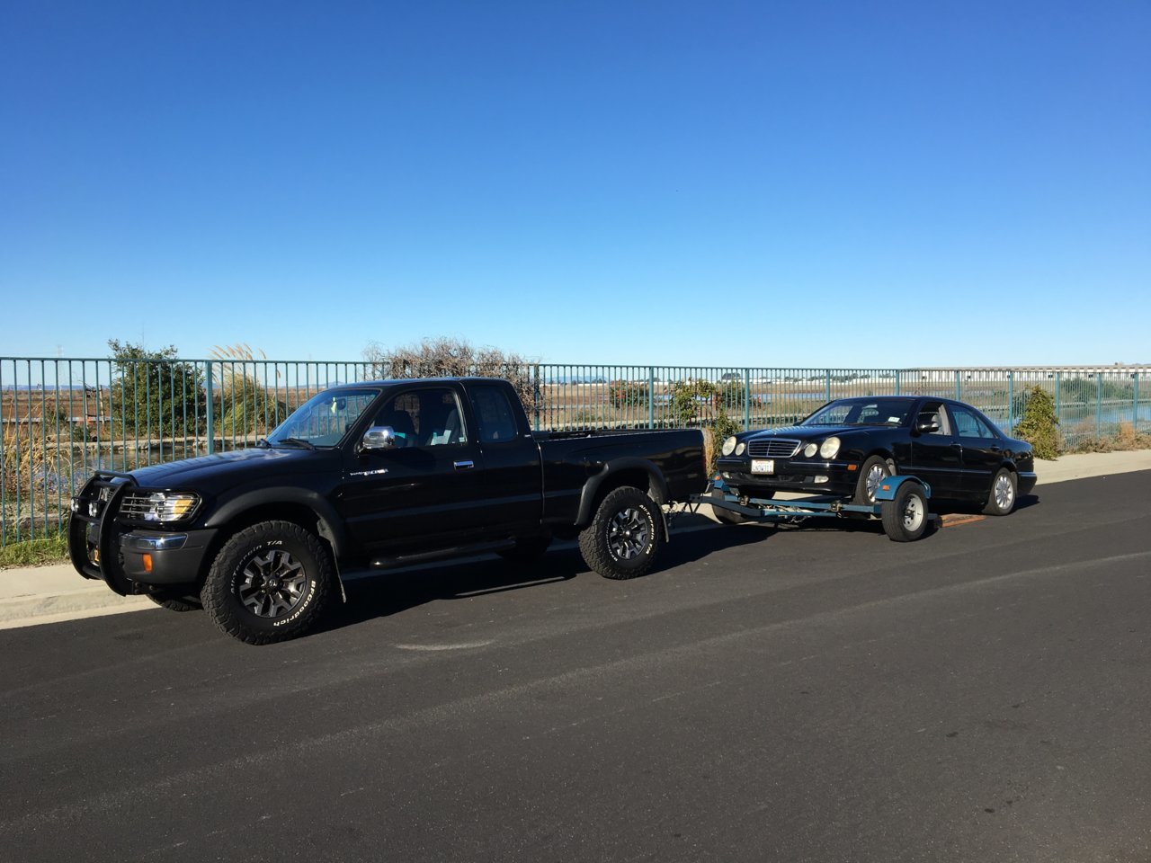

    I have a 1998 2.7l Auto and I towed my Honda Civic about 120 miles with it. No issue. Payload was about 3,600 pounds.
    Picture is my E320, I don’t have a pic of the Civic.
    You’ll be fine.
