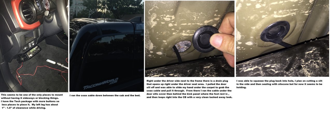

    Hey guys, I searched high and low and was not able to find a real clear picture or explanation as to how to route the coax cable from the outside into the cab. I eventually figured it out so I made this diagram to help. Hope this helps.

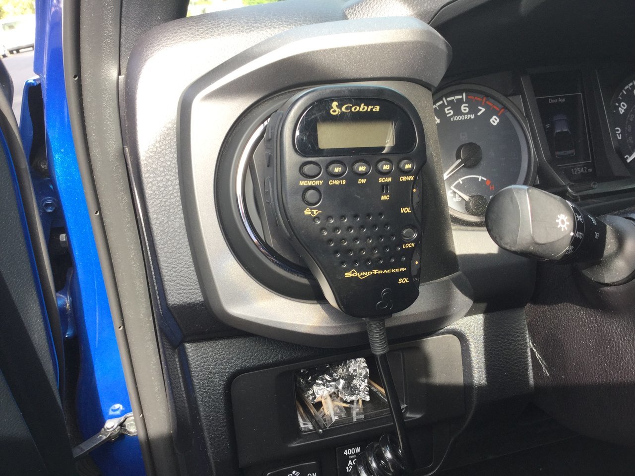

    Hey, so I’m a little late to this... but has anyone tried mounting it under the drivers side dash? i want to mount in a place that will be out of the way when i drive but the cord will also not be in the way of buttons and stuff

    . Like this maybe.

    yes! where did you mount it to get it like that?

    Now that is an elegant install mount for the "brain" of the unit. Nicely done. Will try to replicate in my 3rd gen which doesn't have the same switch placement, rather they are on the left of the steering wheel.
