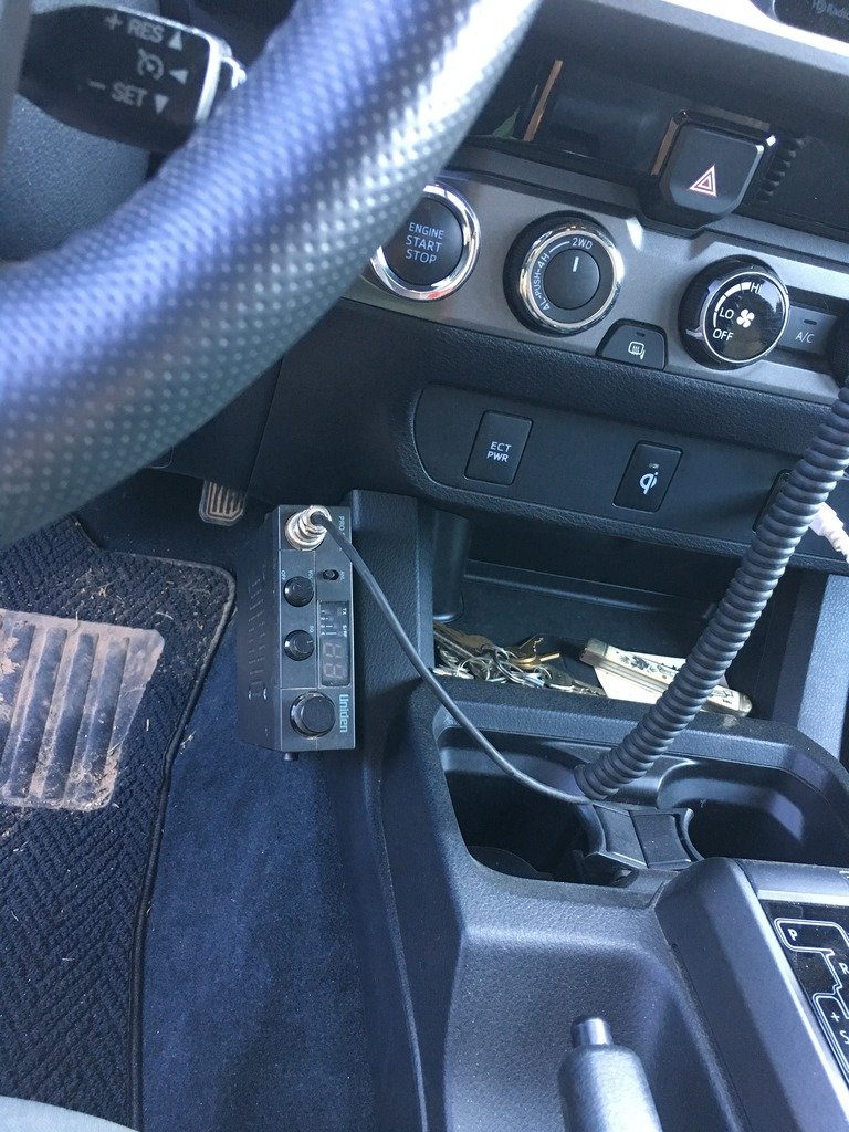

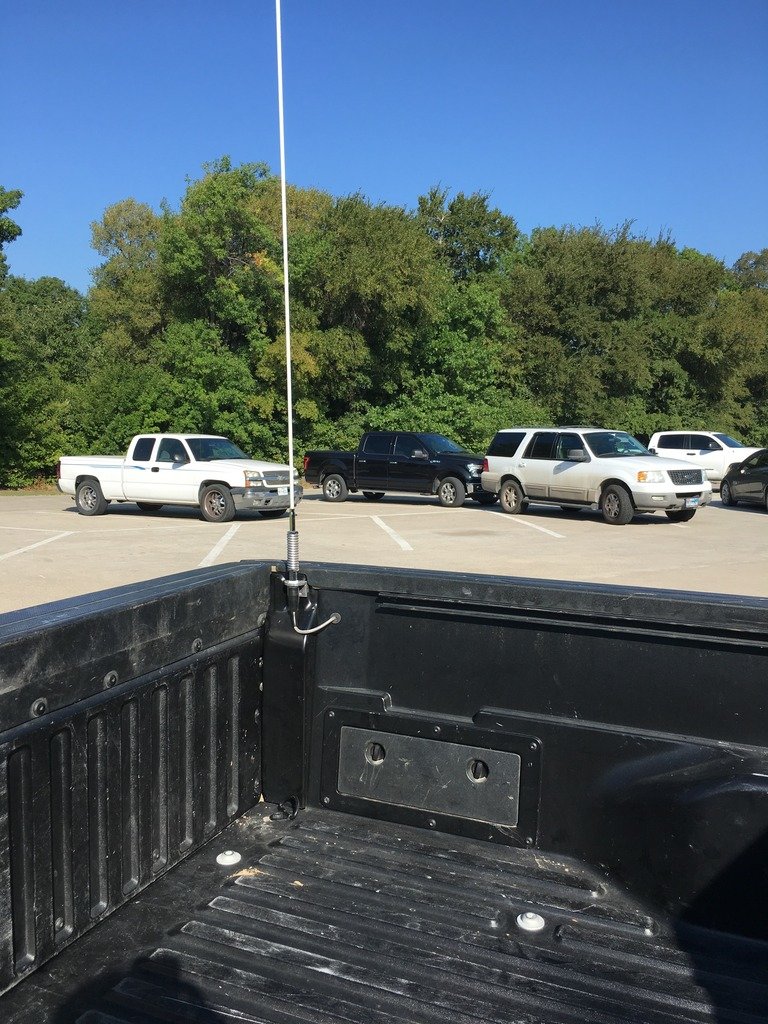

    I've installed uniden Pro520XL with a 3' firestick on a bracket attached to the bed rail. I mounted the CB on the passenger side next to the cup holders. I've also seen mounted under the button switches above the QI charger but it blocks the light under there. I have the wires running down the console and passenger chair to the center console 12v supple with wire cable to make it look a little nicer.

    They have mounts that run between tail gate and brake lights. No drilling, already a hole in the center console so just pried the side and wiggle the wire through.

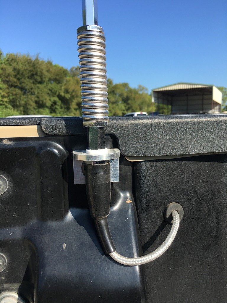

    I will be installing mine this weekend. Really wanted to go overhead mount with the radio but I have changed my mind. I Will be mounting my radio on the driver side of the console.

    I always had issues with the way they format the quick links.
    The antenna mount looks good.

    Thanks, I have never had an issue with Photobucket until now. I had to go in and fix the links on every image
