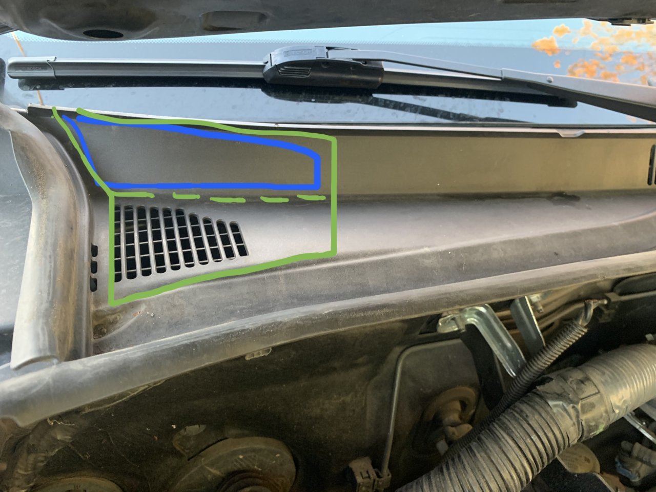

    I’m getting ready to do this over the weekend. Finished up moving my compressor, etc. Keep in mind I haven’t pulled off the cowl so there might be some ducting I’m not
    aware of, but has anyone cut the intake holes bigger? What’s there isn’t much and was only designed for the HVAC system.
    I’m thinking of either cutting the blue or going even bigger and cutting the green. Then replace with some sort of metal screen. The green would have a bend along the dotted line.
    Waste of time?

    I would say you are risking getting more rain in the cabin fan that way, as the opening is right where you going to expand it. Had this cowl for over a year, no loss of power etc. don’t think cutting it bigger is needed. :notsure:

    Ah okay. Figured there might be something under there. Worth a shot.

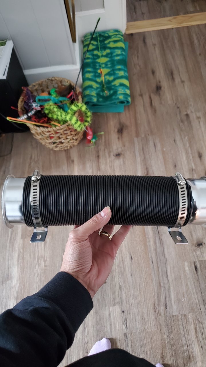

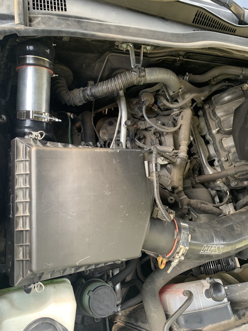

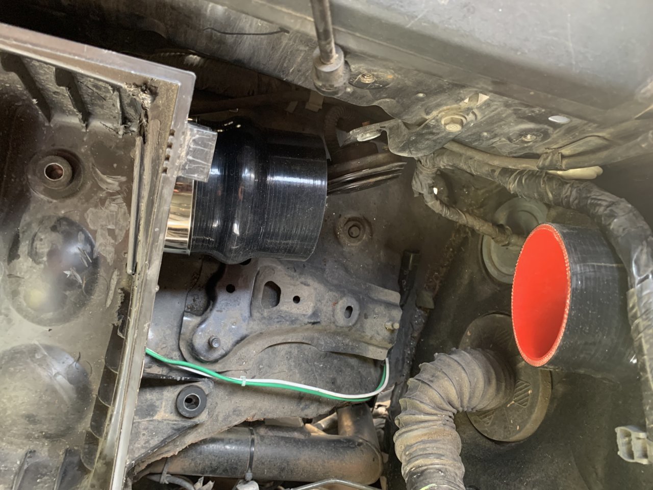

    Finished mine. Not that anyone needs more pics of this, but as a warning. A lot of the parts in OP’s post aren’t available anymore so I had to look for alternatives.
    First the tube mount. Went with plastic as that’s all I could find. Same company. Works fine. These arrived gray. Whatever. You can’t see them.
    Spectre Performance SPE-8148 8148 Air Duct Mounting Plate https://www.amazon.com/dp/B000BPUTL4
    Next the connectors for the tube to the adapters. Again, not available. I used these. Figured being hump style and silicone they’d be better.
    Ucreative 4'' Length Hump Black Silicone High Temperature 4-ply Reinforced Straight Hump Coupler Hose (3.0" (76mm)) https://www.amazon.com/dp/B08YZ1TXGH
    Do not use these. Try to find something like OP used that are really flexible and shorter. I ended up with a huge elevation and side to side difference (yes my engine is dirty - I live in CA and if I washed that in my driveway I’d probably first get drawn and quartered and then my dead body arrested).
    I eventually got it to work but the airbox isn’t mounted to anything. It’s just floating a couple inches from the wheel well. I’ll eventually get rid of those and build a new mount. Should be okay for now.
    And to anyone that has the idea to open up the cowl for more air flow, you can’t. At least not much. There is a little curtain thing that protects the fan intake. This blocks any opening up room.

    Ok, have to ask something unrelated... What are the green and white wires for? Also, it appears you have changed out the hose that leaves the air cleaner to the engine with something that I do not have on my stock truck. Or maybe that is just a change from your 2016 to my 2021.
    Greg.Brakes.Tacos and erok81 like this.
  13. Nov 27, 2022 at 9:51 PM
    #93
    erok81
    erok81 Well-Known Member
    Aug 15, 2016
    #194699
    5,708
    Imposter
    Green and white wire is for a driving light. I removed all of the aftermarket wiring to start over but missed that one.
    And yep. I have a different aftermarket intake hose. Doesn’t really do much except clean up the engine bay a bit. Maybe more noise.

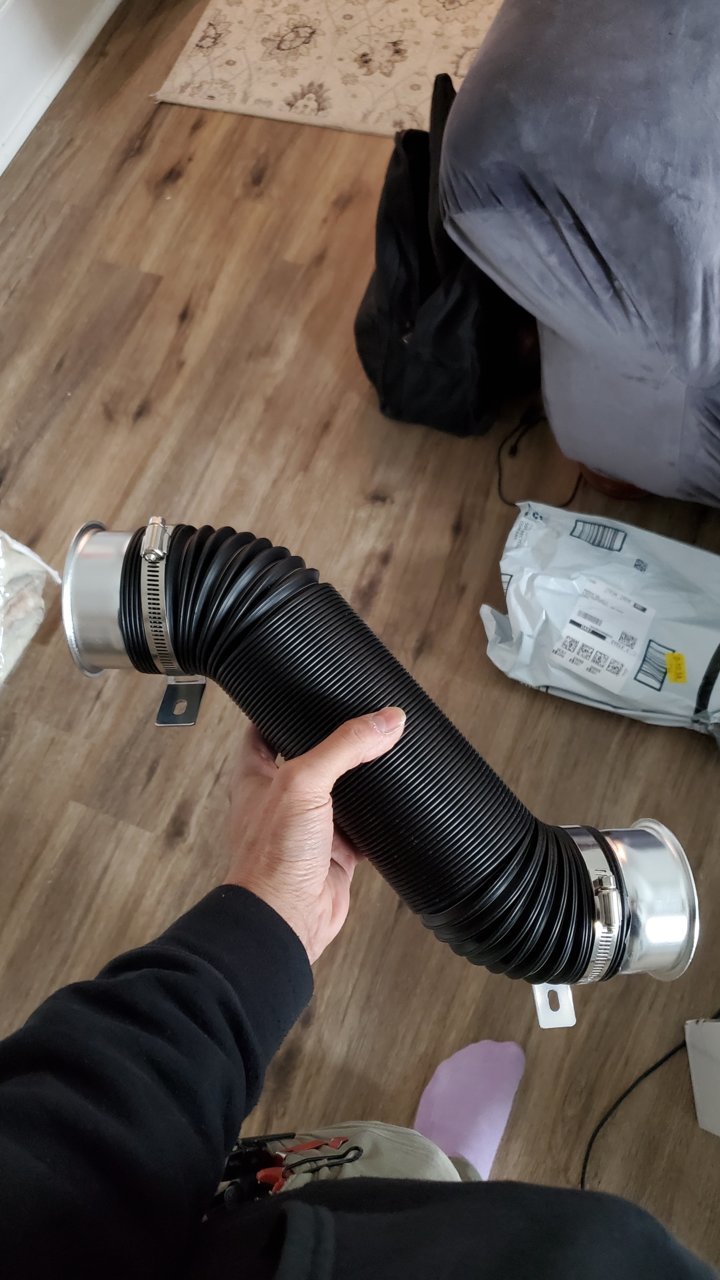

    Recently did this mod trying to use a 12" long piece of silicone intake pipe, figured it'd keep the air relatively cool coming in and look sick, ran into the exact same issue as @erok81 :bananadead: my air box is currently floating since the angle you'd need is way more steep than I was accounting for (this is what I get for not reading I guess lol), still can't find the couplers op used BUT this just came in the mail and looks promising, I'll post an update when I get it installed

    Nice. That’ll work better. I fixed my floating issue too. Accidentally removed the wheel well and mounted it off of the coilover. :eek:

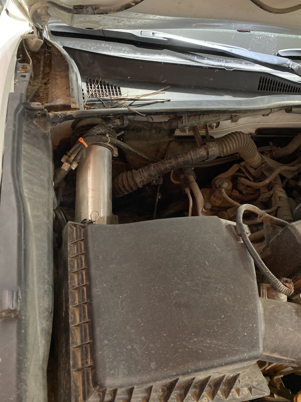

    I’ve found sticks and pine needles in my intake box after the mod.
