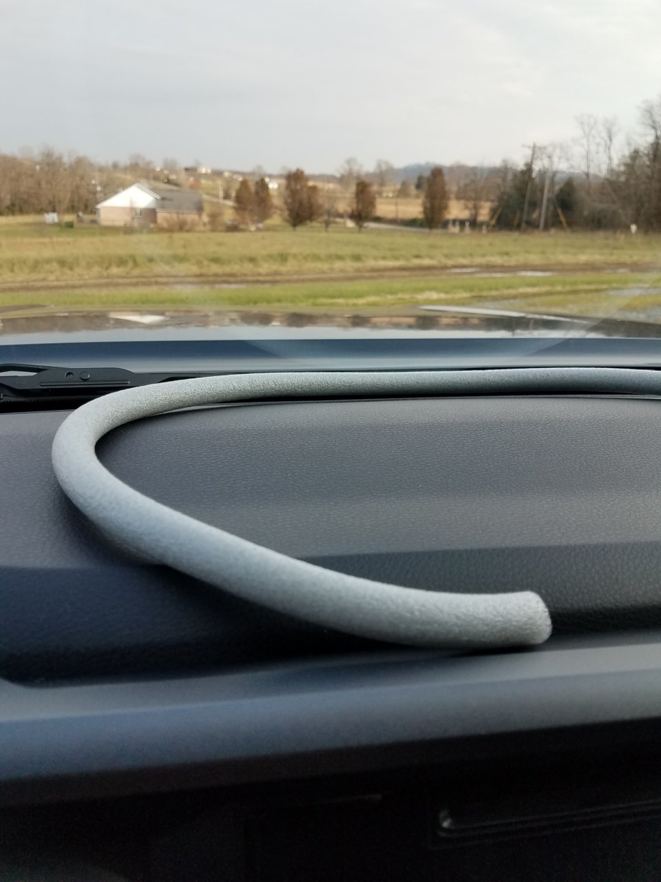

    My dash made all kinds of crazy noises beyond the passenger side speaker grille, ended up stuffing this rope foam down between the dash and windshield and it took care of it.
