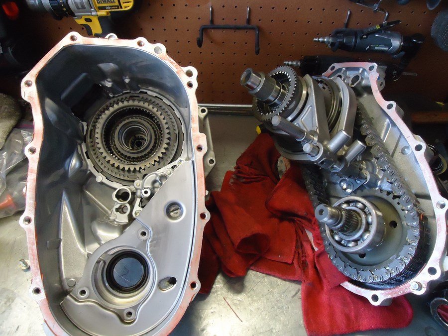

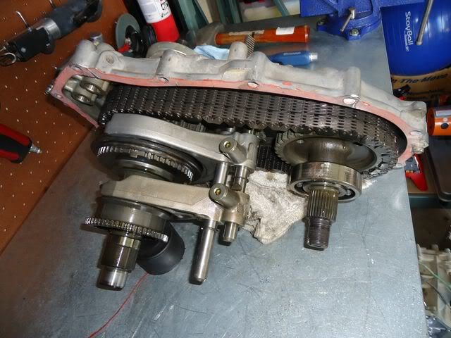

    yeah, not sure. I don't see a point in putting more fluid than necessary. was just curious. I just put enough so it drips out the fill hole.
    https://www.tacomaworld.com/threads/transfer-case-chain-can-anyone-else-hear-theirs.202533/
    http://www.rocksolidtoys.com/forum/showthread.php?t=731
    Don't see anything in there that could be brass, and it looks like toyota LF is a 75W but no other descriptor. Can't even find a damn MSDS sheet for toyota LF. Now, it's just an issue of principle that I don't want to use toyota LF.
    Our 2013 Audi t-case takes a non-sulfured 75w synthetic that ravenol makes for $15 a liter and is recommended as a replacement. We are up on 40k on the car and need to change that out soon so I think I'm going to order 3 liters of that to use on the car and hold on later for the truck. Leaves me with enough for both vehicles and my spill factor. If it's good enough for a lifetime fill on a questionable Audi t-case, thinking it should be good enough for a more robust tacoma t-case.
