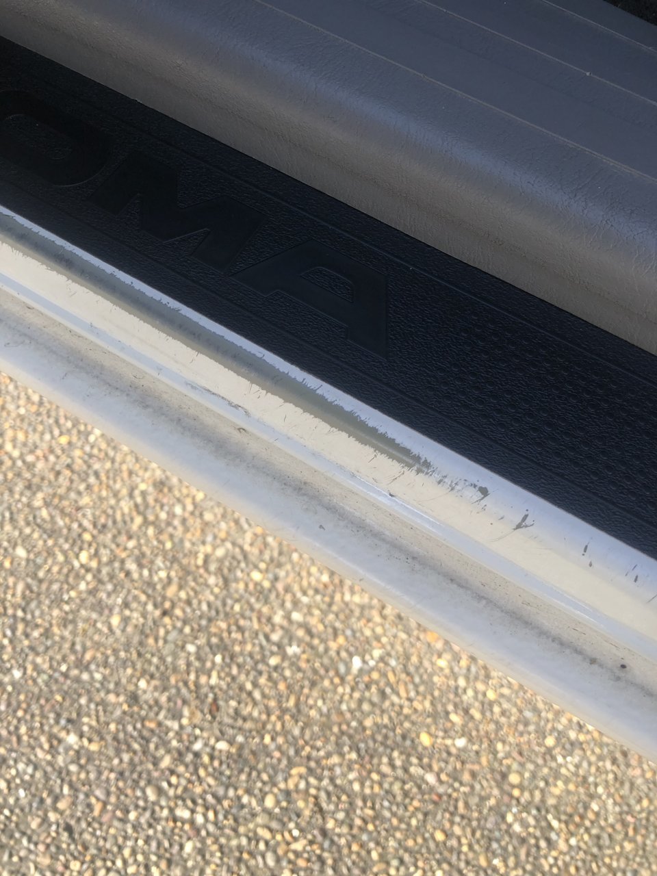

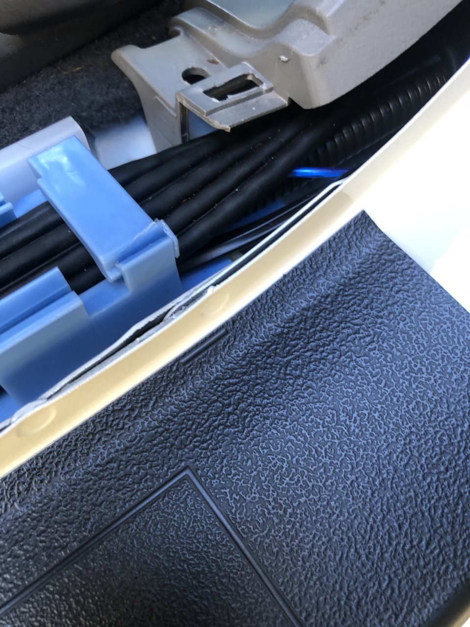

    So I am the second owner in this truck. The previous owner could not manage to get in and out without dragging his or her feet all over the door sill.

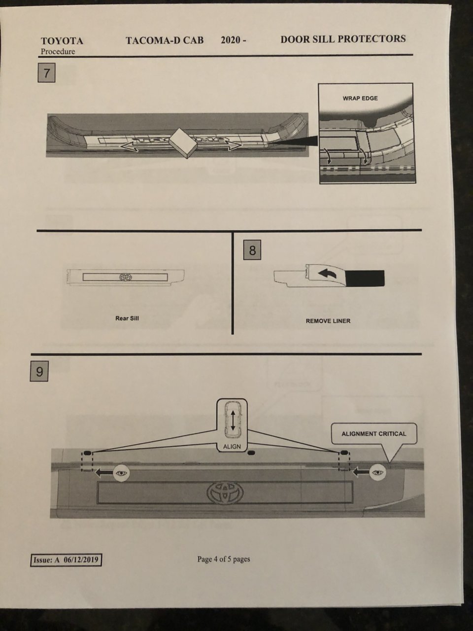

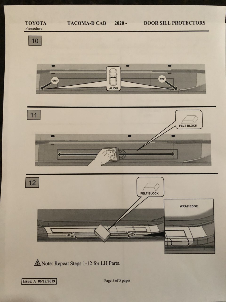

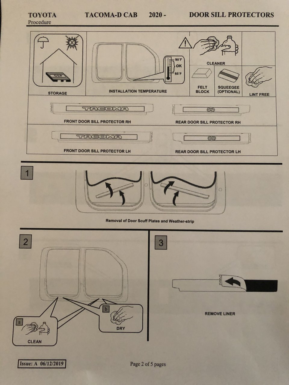

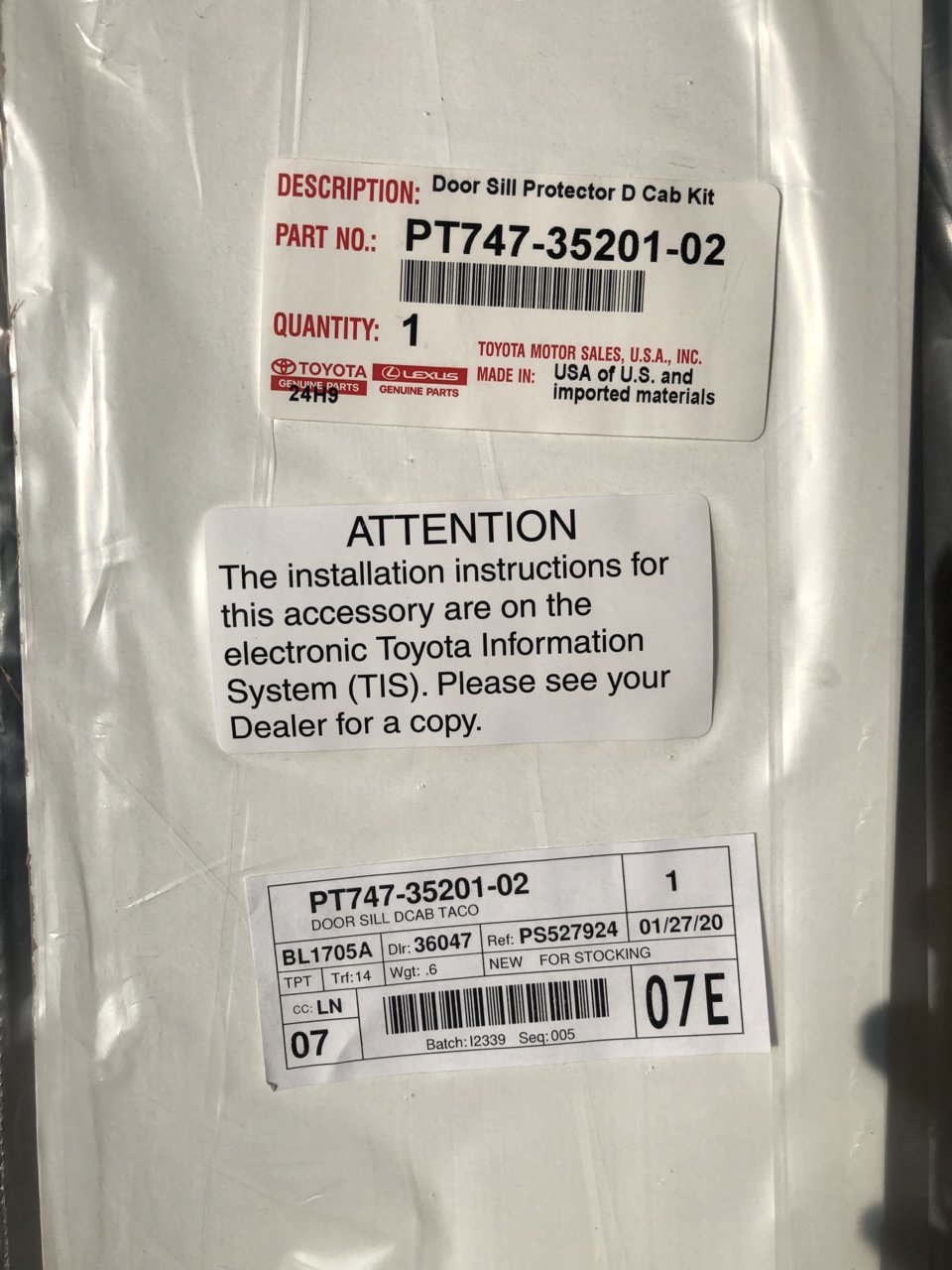

    This left me with a big ole eye sore and potential start point of body decay. I have owned a 3rd gen before going back to this truck. I remember that those door sill protectors wrap around. Before I jump too far into his let me put up part numbers and factory instructions on how to install.
    This is how Toyota tells you to install them.

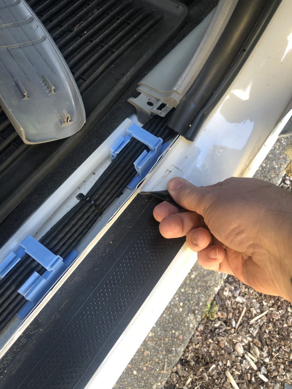

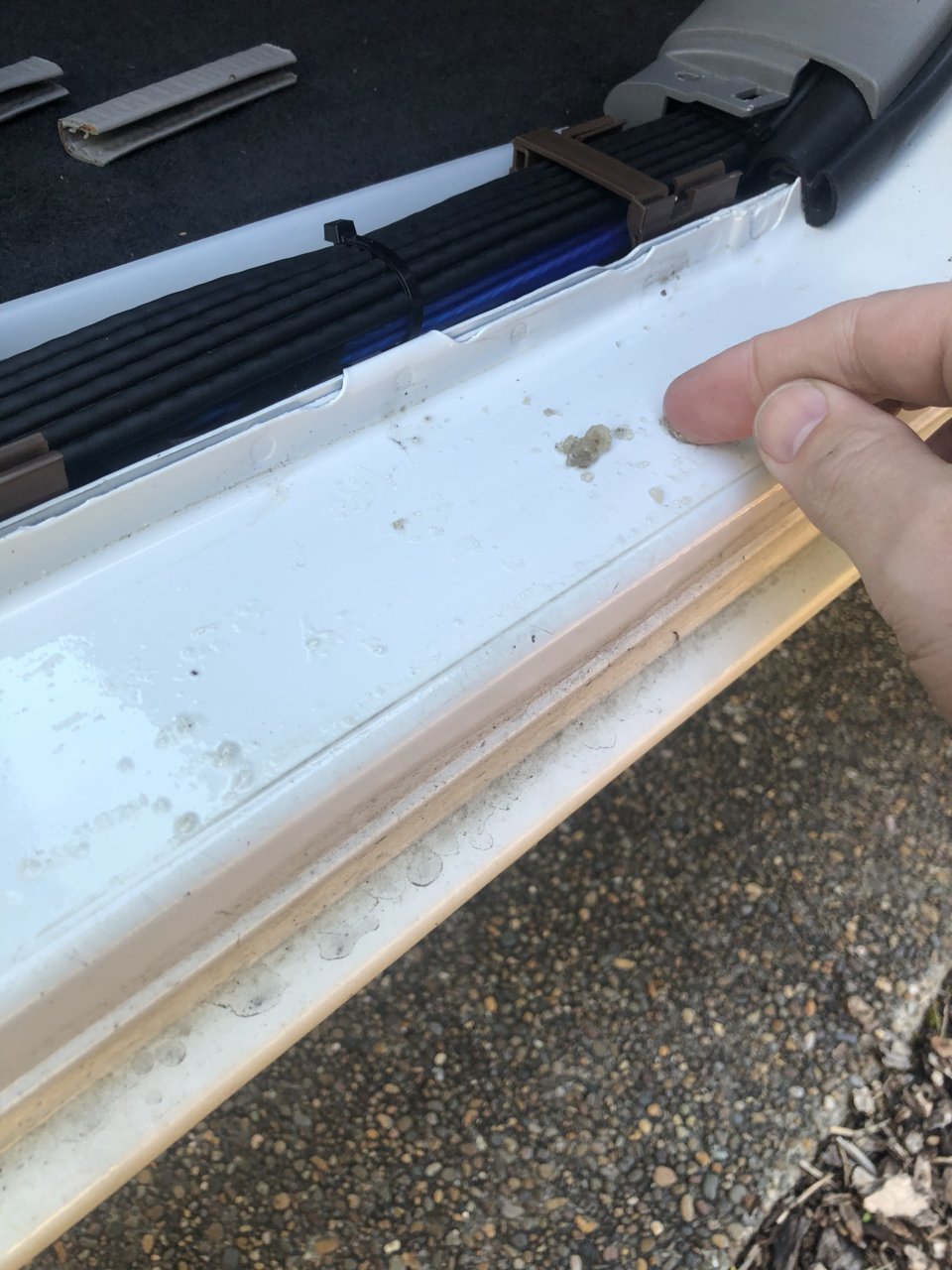

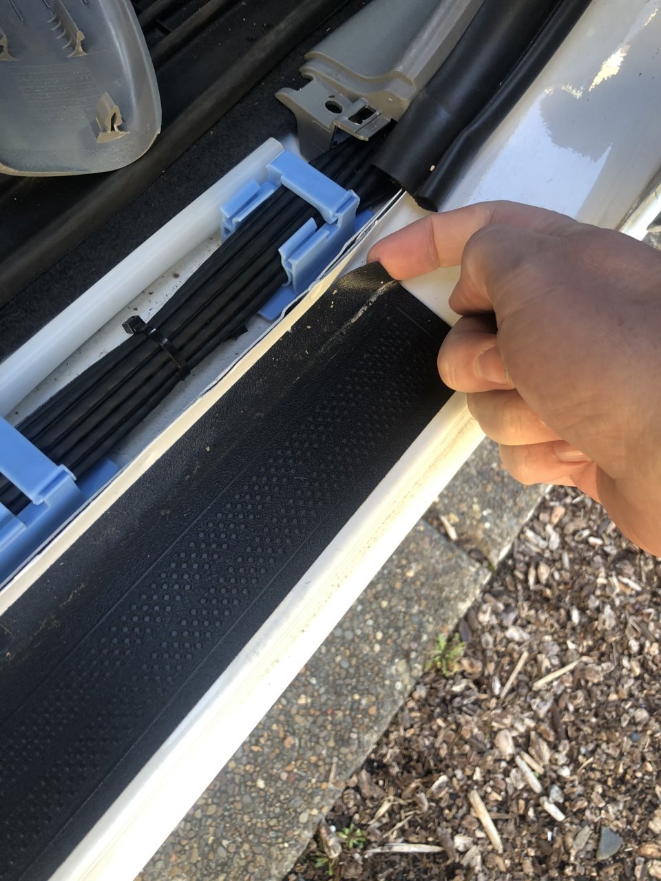

    Now that it’s out there let me show you what I did. My old sill protectors don’t wrap around and provide good coverage. This is how I started to peel them.
    Once they start I pulled steady and at a medium speed. This kept most all of the adhesive on the old protectors.
    The adhesive that was left I let soak in remover for about five min and used my fingernail to remove easily.

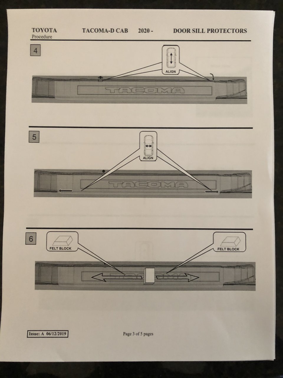

    Then I cleaned with glass cleaner to prep and applied dry. There are tabs to align that work very well. Thanks Toyota!!!!

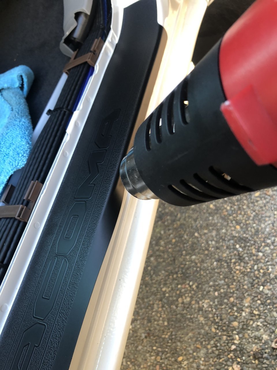

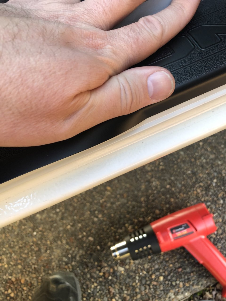

    I used a heat gun on low very, and I mean very, sparingly. Too much heat will blister/warp the protector. This allowed me to wrap the outer edge and ensure good adhesion!
    I would roll the slightly warm sill protector from the top down, from one side to the other.

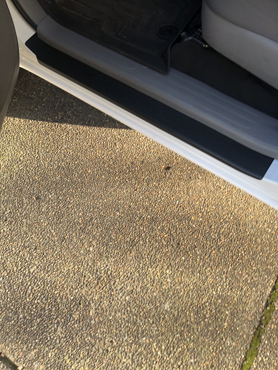

    everything went very smooth and now my scratched up door sill is protected and covered by the new sill protectors!
    I am always grateful for all the knowledge dumped on here for all to use. I hope this adds to it. With the way that these adhere I am not worried about water getting under there. This also kept me from having to paint it.
    Thanks all!

    I did forget to tell you all that these were $45 dollars retail and $36 wholesale at my dealership. They had them in stock and I am lucky enough that my work has a wholesale account there.
