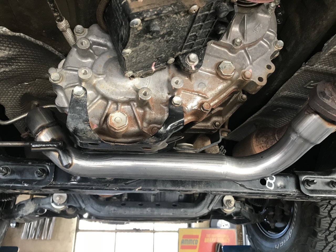

    For me they routed it behind the tcase, for others they have tucked it up closer to the tcase in the same location.

    Cool and thanks! I have seen the behind the case. I dont see any way at all they could push it up higher. Its already close and they had to flatten the dang pipe to do that.

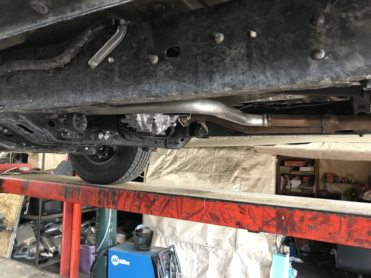

    Exhaust pros did mine last year $100. Straight off the cat then out away from the plastic box on the tcase.48B6B21F-E05D-4687-A49D-E27D66620BAF.jpg

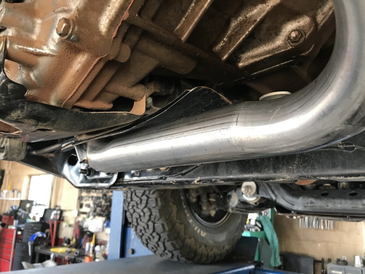

    I talked to AA, he said that they do both the around the case as well as the tuck it up closer to the case. He said that closer to the case is his preferred method but that it only leaves about a half inch to the skid plate. I have found that when rocks and dirt get in that space, they cause a pretty annoying vibration until they are removed so I was thinking I preferred the behind the case.
    Does anybody have any pros/cons that they can add to the conversation for one method over another?

    Ill have to ask him to leave me room to slide the case back if needed. I just dont want to recreate the issue of debris getting wedged between the exhaust and skid.

    I let them talk me into going under the case. I think it turned out pretty well.

    I have not hung my skid plate back up there yet to see how much clearance there is. The guy said that he likes to see 1/2" which I think I will have. I am going to hang it up this weekend so I will update with that dimension

    I just did the reroute. I had all intentions of going behind the case but Josh mentioned difficulty removing the case and then the guy at the shop was pitching the under the case route pretty hard. It makes sense since all the heat shields are there and you can stay away from the case computer.
    He originally quoted me $175. He only charged me $150 but I think it was because I showed him how awesome I am while we were under there. And he screwed up the first time and had to redo it. Could have been either reason. Either way, they were super nice and let me hang out under the truck and which gave me a chance to look at stuff from a better angle than I had seen it prior.

    I have the RCI as well. I had the one that dipped under the exhaust but that was clearly my low point as I bent it into the exhaust. I have the flat one sitting in my office, have just been busy doing other shit to the truck. I am going to put it on Saturday. The guy told me if it didnt fit to bring it back and he would fix it.
    The only "mod" you should need is the rerouted exhaust.
