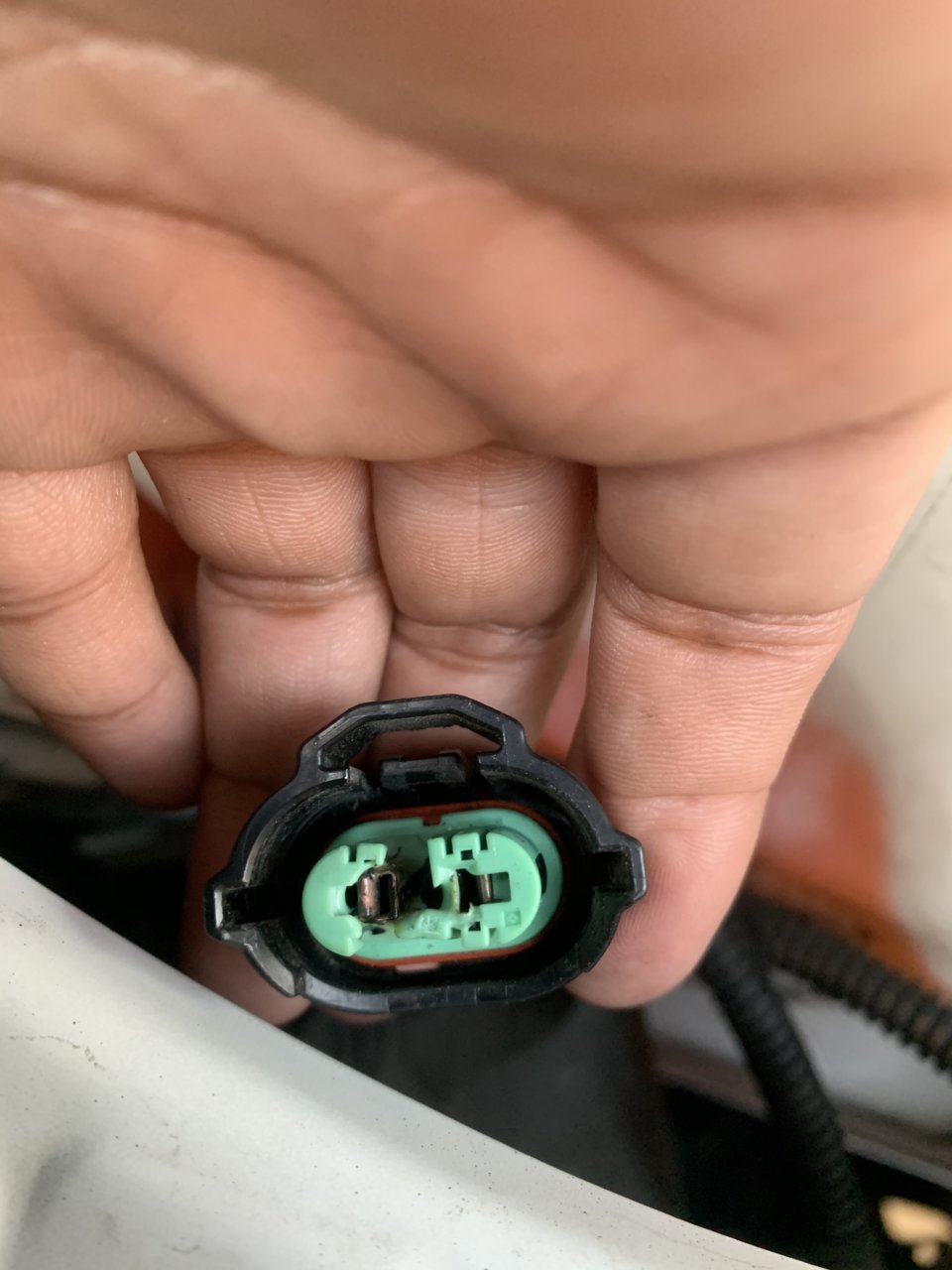

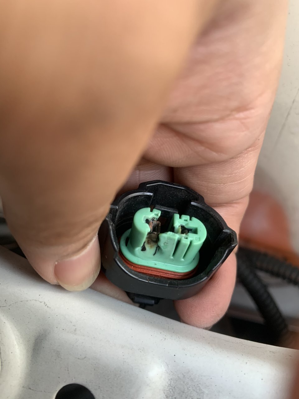

    Seeing that photo prompted me to purchase a set of the iJDMToy adapters in the links for my wife’s JGC. They look cheap compared to the Nokyas but they are available whereas the only Nokya set I found looking this AM was from a suspect third party vendor.
    I figure I’d rather melt the adapter harness instead, at least for testing purposes. I’ve seen very few people with the above issue but I don’t feel like taking a chance when her Jeep has the full Maxcare warranty and I don’t need to give them a reason to challenge me.

    Note that if that were to happen, you can replace just the connector. Again, I've not seen/heard this happen on any other vehicles, but encouraged him to share in here for others and see if anyone else had a similar issue.
    New replacement connector: https://www.amazon.com/Connector-lamp-Honda-Toyota-wire/dp/B075WRVN31

    Damn, that sucks. I just installed some H9 bulbs for my low beams. The difference is great, but your pics has me worried. I'm gonna go disconnect my harness to check. Did you have them plugged all the way in?

    Yup i did plugged it all the way. The driver side is fine.

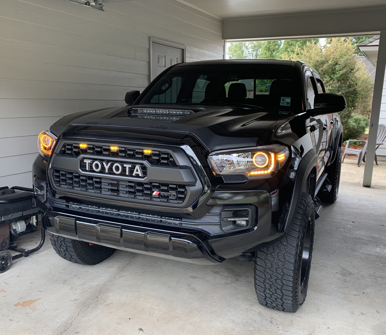

    Halos are switchback (but set to amber only), Meso side markers are switchback (but set to amber only) and the DRLs are amber only (they also blink amber with the blinkers).
    When you set switchbacks to amber only, they cannot be used as turn signals because you use the wire that you would normally connect to the turn signals. Diode dynamics made their switchbacks to where you could run amber all the time. They stay 100% for a second, then drop down to 50%.

    I just connected the red wire to the DRL/turn signal, white wire to parking lights and amber to rear turn signals. White halo DRLs at 100% brightness with the stalk at DRL, parking and headlights the halos are 50% white and turn signals switch the halos to amber. I just threw an amber demon eye in to my faux high beam projector to stick with the classic Tacoma amber lighting theme.

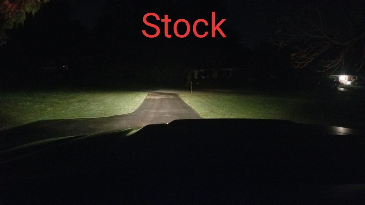

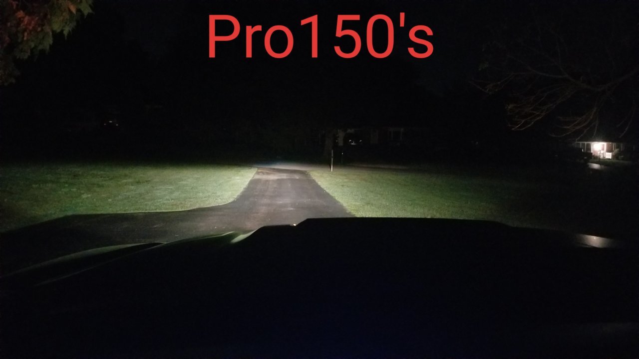

    I'll have to back track on my original impressions. I actually was out on the road last night with the Pro150's, and there is definitely a noticeable improvement over stock. Not sure why the driveway test was so disappointing, maybe they need time to warm up, or burn in? But they throw more light out to the sides, and it's a nicer white light, and I also notice more light right below the cut off. All and all I'm happy. Still think they are over priced, but if I get close to H9 performance in an H11 bulb that lasts longer then the H9, that's all I was looking for.

    Definitely a solid improvement over stock. My underwhelming comment was that I had hoped their performance would exceed the GE/Tungsrams, especially for their price point. They do appear have better light to the sides of the pattern, but peak intensity was less than I was hoping.
