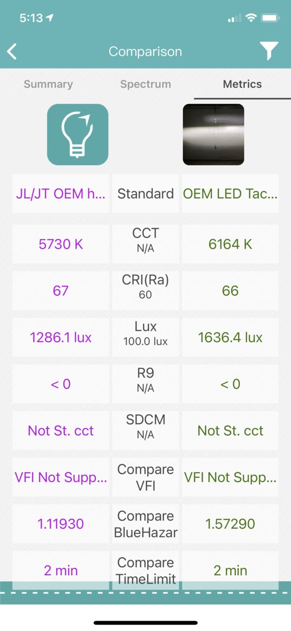

    And to keep it on topic, here is how the OEM JL/JT Projector LED headlights compare to the OEM Tacoma reflector LED headlights.

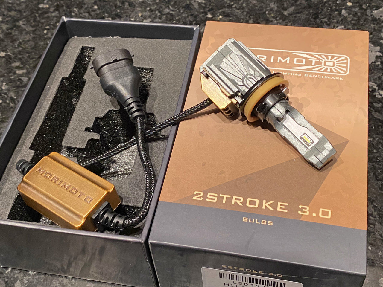

    Morimoto 2stroke 3.0
    Note this product uses different emitters based on being a single or dual filament bulb, this covers the H11 single filament model.
    This is one of the most innovative replacement LED products I've seen come to market yet and one with some impressive design characteristics.

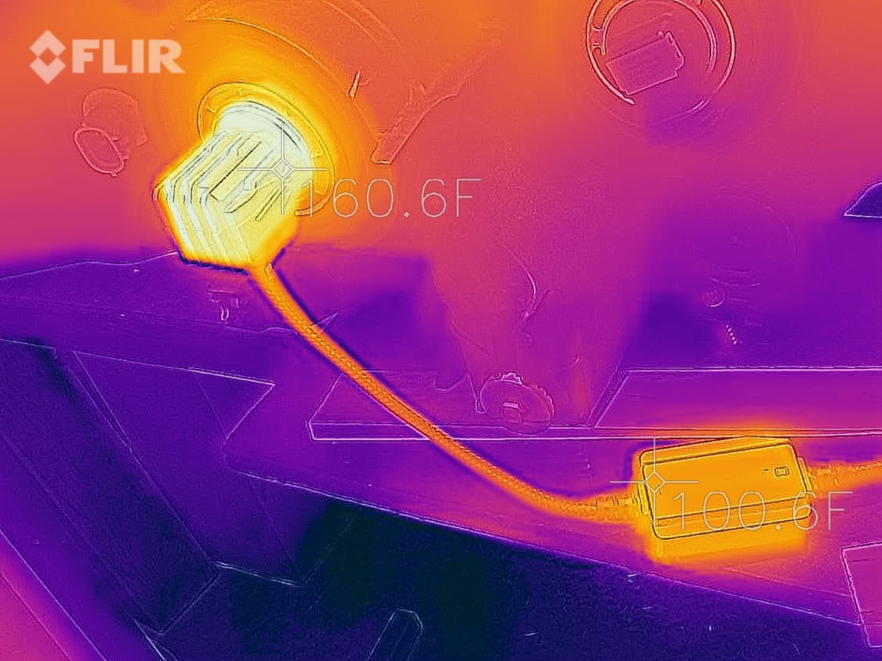

    Another unique innovation, is the fan system is completely sealed, drawing and exhausting air from within the headlight assembly through vents that flank the LED blade. One of the real challenges in building an LED PCB this thin is adequate cooling to maintain high output. Blowing air directly across the PCB to aid in cooling rather than only relying on radiated heat to the heat sink and fan assembly at the rear is cleaver. This also offers the additional benefit that the LED microprocessor cooling fan is sealed from the dirty/wet/dusty and unfriendly environment of an engine bay which should aid in product longevity.
    By having the fan as a completely sealed system, the fan noise is quieter and at a much lower note than open exposed fans like the Hikaris Ultras that tend to have a high pitch whine. I'd describe the Morimoto fan noise as more of a low pitch hum, and much more pleasant than the Hikaris. Morimoto also claims this system increases the headlight assembly temperature to aid in winter conditions.
    In an ambient 61 degrees after 40 minutes of run time, the outer lens was 65.5 degrees, aka a 4.5 degree increase. The sealed projector inside the assembly clearly prevents this system from allowing adequate heat to reach the outer lens and will be ineffective in preventing icing. I also tested this in the high beam which does not have the separated cavity issue like the projector and the outer lens did not warm more than a few degrees. However in the 3rd Gen the high beam is exposed to the entire assembly, so it is a large volume to heat.

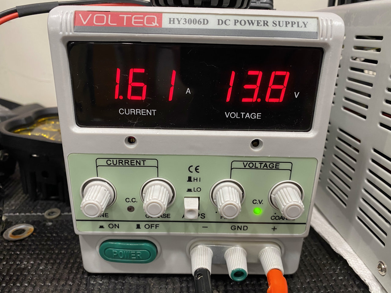

    Power draw after 15 minutes of run time, 22.2w. Right on the published 22w spec.
    The back of the LED and the driver both run cooler than Hikari Ultras.

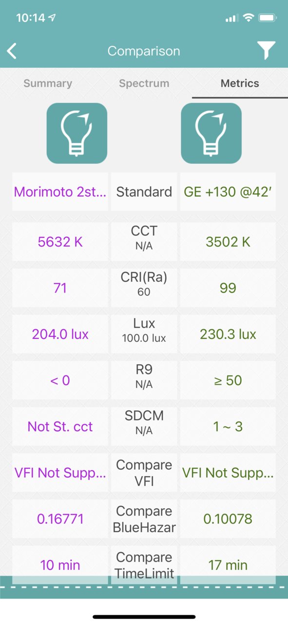

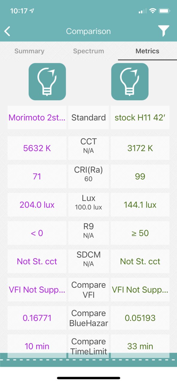

    42' distance test
    Moritmoto 2stroke 3.0 vs GE/Tungsram Megalight +130
    C06CACA3-7DBF-43EB-95E8-BEFA3A211C2E.jpg 9DBD5621-3E3D-46C1-869D-044EA1D440FB.jpg
    The Morimoto LEDs fail to outperform the GE (now Tungsram) Megalight +130 in peak intensity at a distance of 42'. However, they do provide about 41% higher intensity output than stock at 42', which is a solid achievement for a replacement LED. Typical of a Morimoto product the color temp is in the mid-5000k range, I have them measured at 5632k.
    Peak intensity is still a little lower than desired, but so far the Morimoto 2stroke 3.0s offer the best focus of any replacement LED tested.

    Re-running a stable Hikari Ultra current test, since I did not have it documented in my previous review. The Hikaris draw 24w vs Morimotos 22.2, nearly a 10% difference in Hikari's favor for being higher powered.

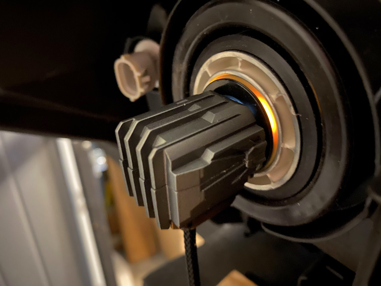

    Another nice feature of these Morimoto LEDs is they used a fixed collar mount just like every other reputable brand such as Philips, Osram/Sylvania, Tungsram and Diode Dynamics. They are not 'adjustable' like lessor designs that allow room for install error. So when you install these in your Tacoma low beam, you are guarenteed the correct orientation when they lock into place with the emitters at 3 and 9 o'clock. No guess work, and the square housing design makes it super simple to confirm they are positioned correctly.
    EDIT: These are adjustable, revised high beam comparison coming soon
    However, there is a drawback in that design in the case of the 3rd Gen Tacoma. When installed in the 3rd Gen high beam location, the emitters are not pointed at 3 and 9 o'clock as they should be. The LED is rotated too far when locked into position.
    Due to the three dimensional contouring on the back of the 3rd Gen headlight housing, Toyota rotated the H9 bulbs off center to clear the wiring harness plug into the bulb. With an omnidirectional and symmetrical halogen H9, that doesn't matter, but when replacing with an LED where the emitters need to be at 3 and 9 o'clock it does. As such this product is not recommended for high beam use as it cannot align correctly, unlike the Hikaris that use the less precise and less than ideal adjustable mount.
