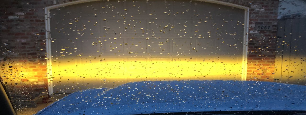

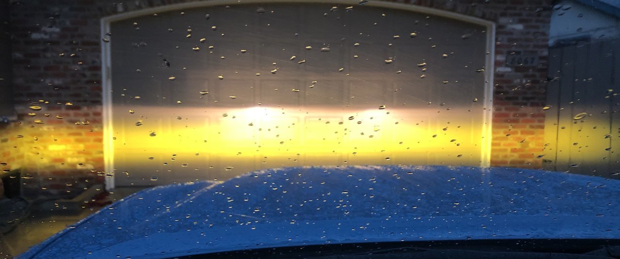

    JagoTaco
    JagoTaco Well-Known Member
    Nov 21, 2018
    #273394
    157
    2019 OR AC Cavalry Blue
    They are legit.
    Phillips H9 lows & Diode Dynamics SS3 Max fogs. 20’ with driveway angled slightly back.
    Excellent setup for foul weather. Spent a little on lows then a lot on fogs.

    crashnburn80
    crashnburn80 [OP] Vehicle Design Engineer
    Jun 6, 2015
    #156893
    14,751
    Kirkland, WA
    2003 DCSB TRD OR
    Difficult to determine in the photo, but looks like your fogs might be aimed a little high. Did you confirm a drop in the pattern from the mounting height?

    JagoTaco
    Nov 21, 2018
    #273394
    157
    Yes thanks saw the fog aiming diagram in the other thread but tough to find a perfectly flat surface for 25’ so drop was confirmed, but less as measured at a closer distance.
    Driveway is angled back in those pics. Confident that the lows are aimed correct vertically, so aimed upper cutoff of fogs just below hotspot of lows per DD instructions. Do the fogs look right in relation to the lows to you?
