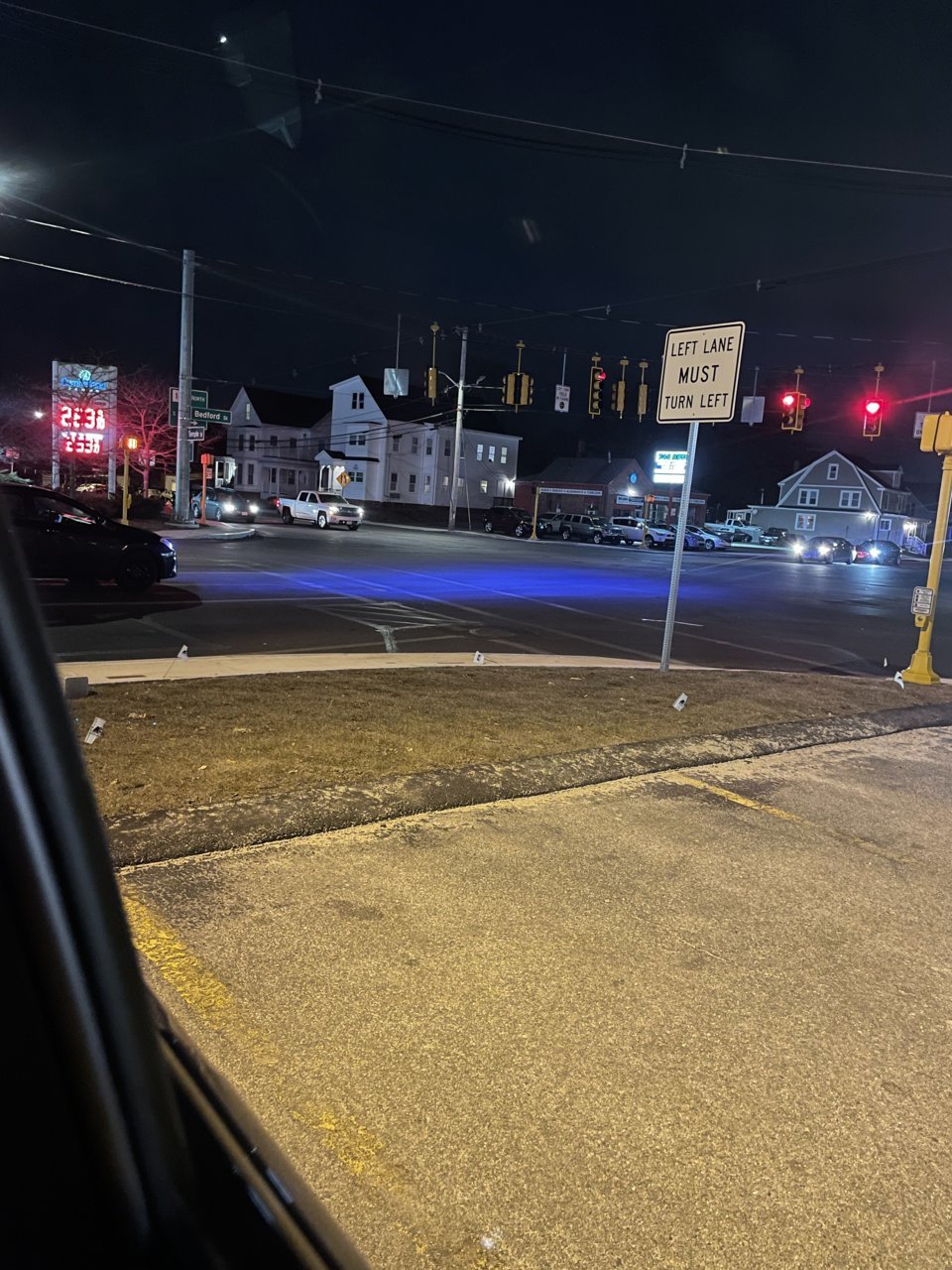

    Yeah those have to be aftermarket. I've seen lots of people with blue fog lights and it always makes me laugh.

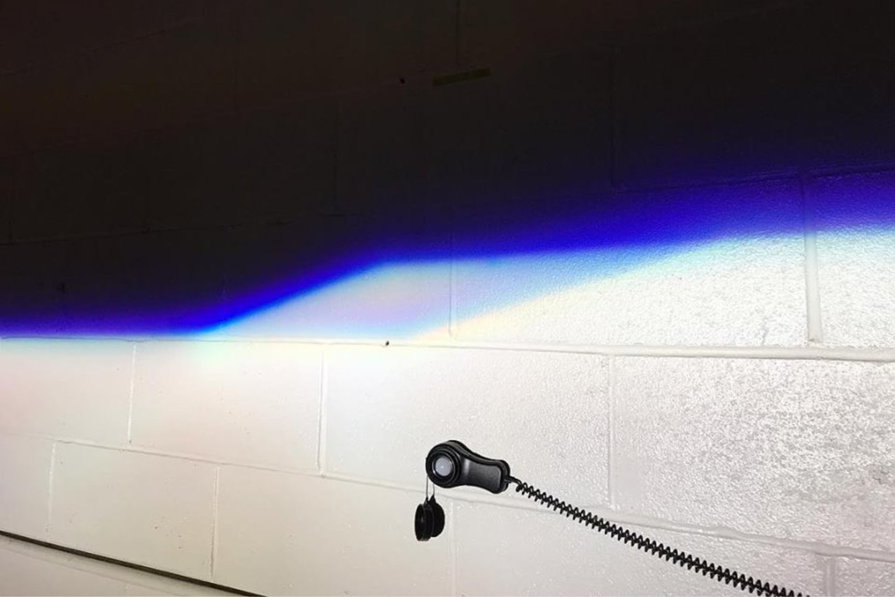

    That is way too purple to be OEM, definitely aftermarket. And LEDs don't even go up anywhere near that high in color temp typically, I bet he is running 12,000k temp HIDs. Facepalm.

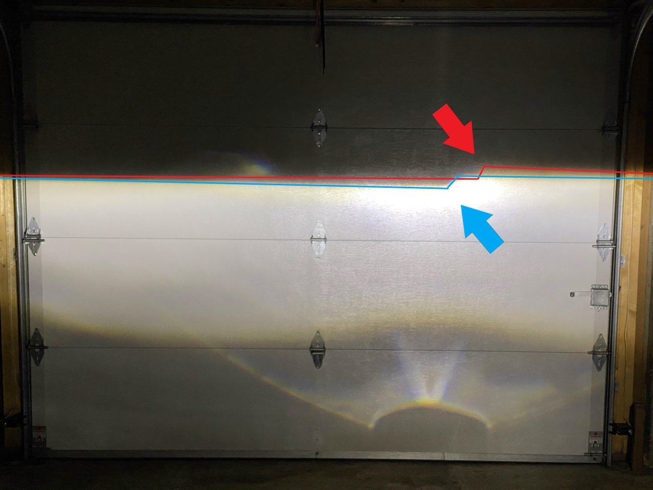

    What I'm talking about is the 2 low beam projectors in each headlight don't look like they are aligned to each other properly in each housing.
    Left headlight it appears one projector is rotated slightly off and is higher and to the left of the other. Represented in red is one and blue in the other. You can also see it in the prism type pattern at the bottom of the picture how they aren't lined up properly.

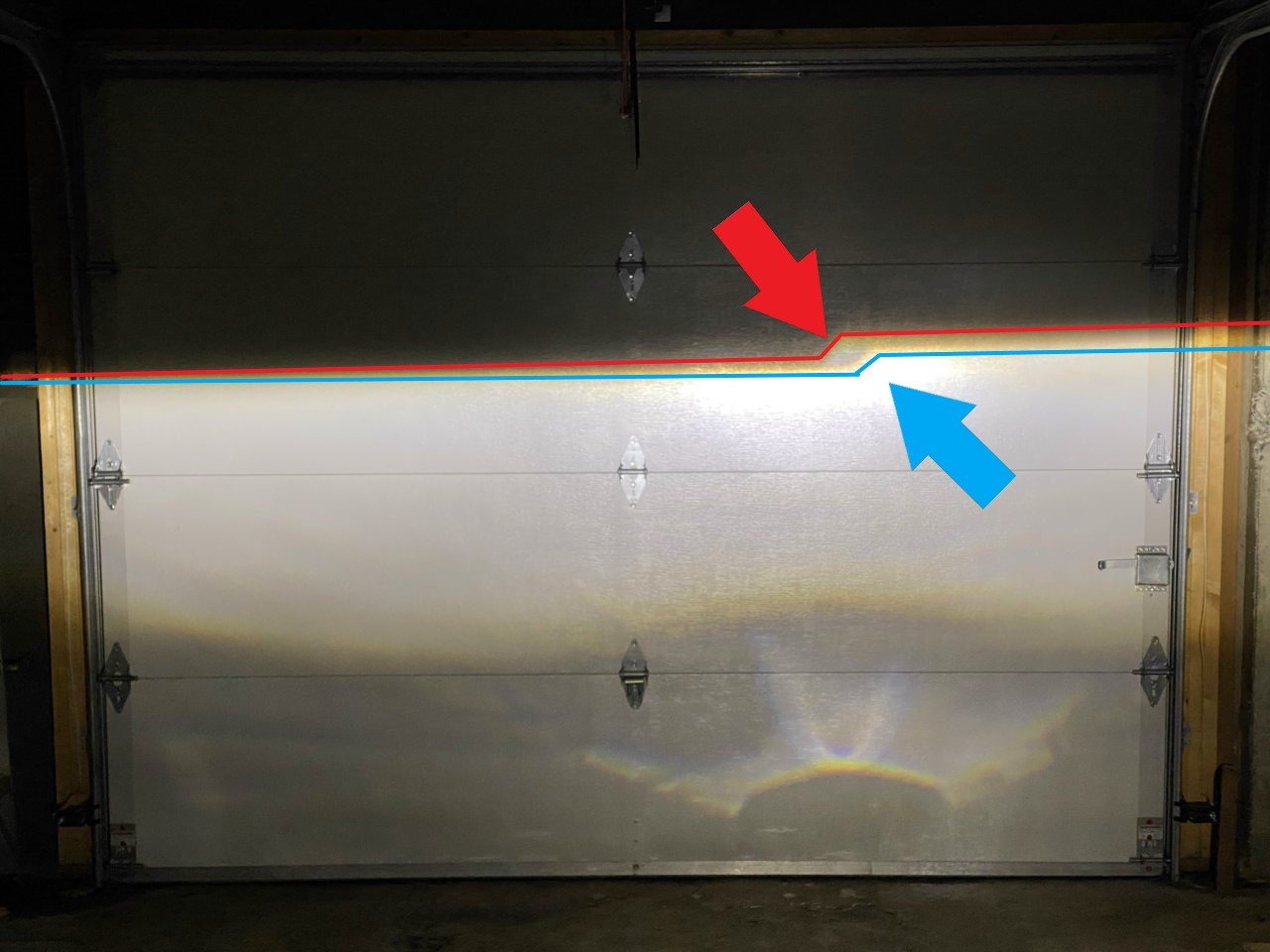

    The right headlight has a similar issue but in a different direction.
    Lining up 2 projectors in one housing is not easy. There will always be a discrepancy in where the step either crosses if they do not point straight ahead. IE if they intersect at 20' then at 25' they will appear crossed on a wall. If they are aligned so they point straight ahead there will always be a 3"-6" gap (or whatever the distance between the center of each projector is in the headlight) between the step of the cutoff assuming they are on the same horizontal plane with the top of the cutoff and rotation being the same between the two projectors in this situation. In this situation it appears that left headlight has one projector that is high, pointed left and slightly rotated counterclockwise. The right headlight appears that one projector is high and pointed right, appears the rotation is decent though.

    Yeah, projectors should just face forward in a multi-projector assembly, trying to align the cut off step will mean one or multiple projectors are not straight and at extended headlight distances it will cause the light to not be aimed ideally.

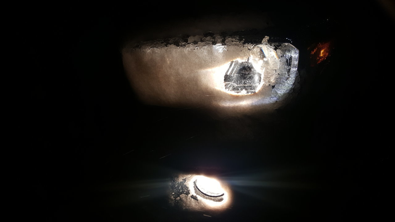

    Here was the halogen image from a significant snow event that froze over the headlights I mentioned earlier.

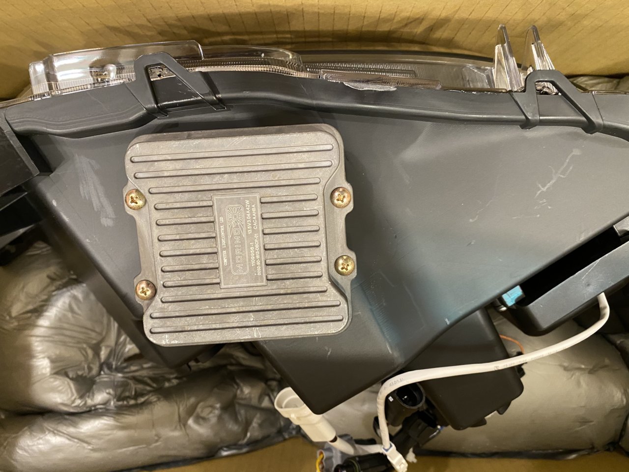

    hey all, I just got a pair of these recently. am i sucker? very electric talk, please explain in layman's terms

    Huh? Not sure what you just got?
