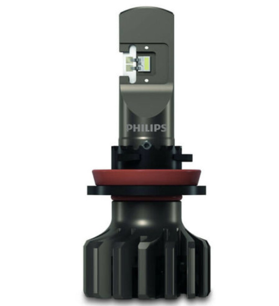

    Philips latest replacement LEDs claim to be the the very first LEDs to use state-of-the-art Lumileds TopContact LED chips, previously only used by OEM LED headlight manufactures. Top contact circuity should make for a thinner emitter cross section and better focus. Philips has continued to stay with passive cooling technology in their latest LED design. These are not available in North America, but I've ordered them out of the UK for testing. Shout out to @SRBenjamin for bringing them to my attention.

    I have high hopes they'll surpass the H9 bulbs. Looking forward to your test!

    I don't see them surpassing H9's. They may be made as an attempt to bring a compliant replacement product to market. So they're probably limited to the H11 maximum output, especially considering they went with passive heat dissipation.

    Agreed. Philips tends to make their products aimed at compliance rather than maximum output, which is how they were granted street legal status in Germany. The design looks promising for an H11, but it won't surpass an H9.

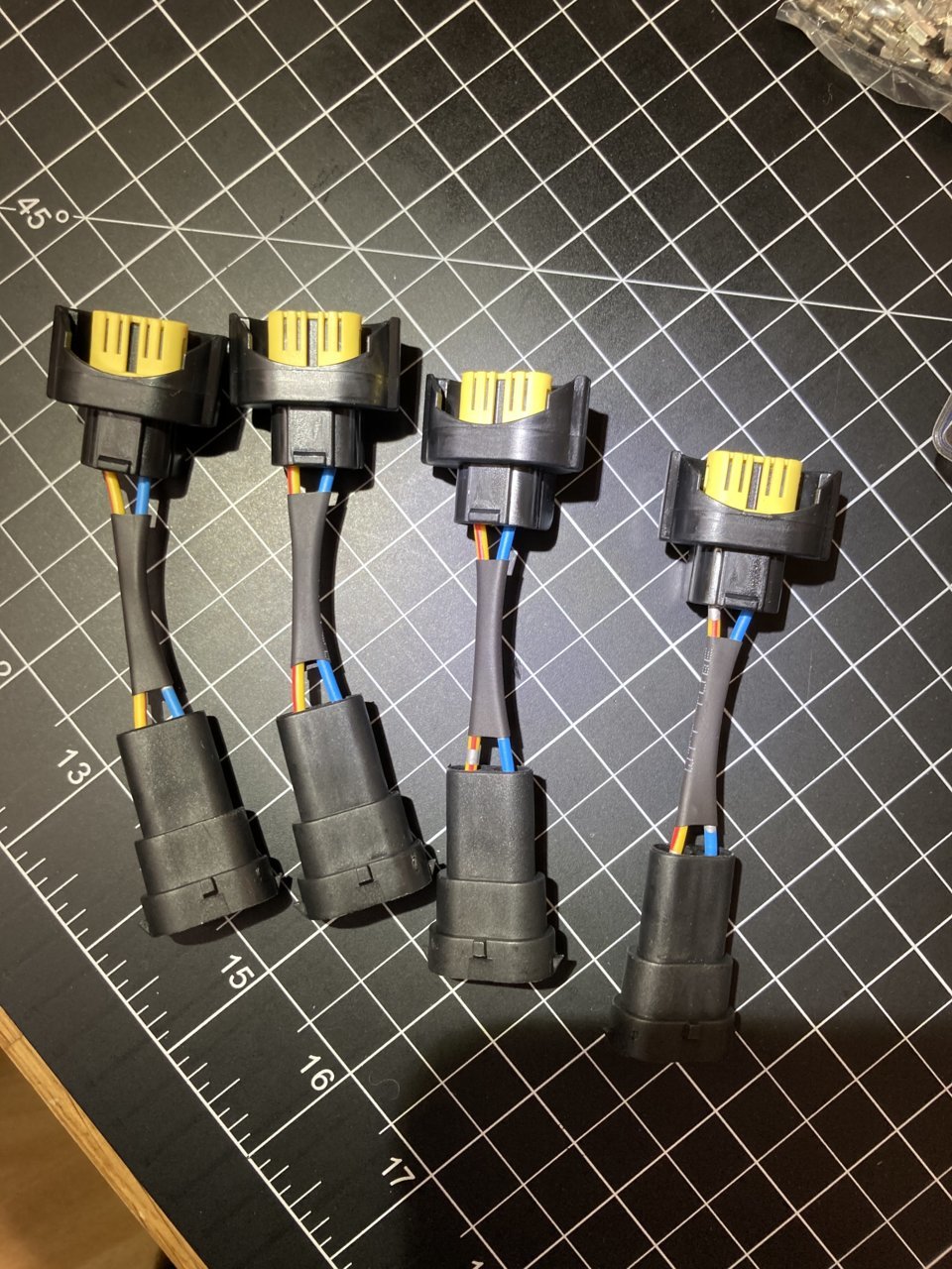

    On the H9 front, I am having so much trouble locating proper terminals for my preferred H9 female connectors. But I am happy to send some crappy conversion harnesses to anyone who wants to try a pair and evaluate, for the cost of postage. I’m not happy with them at all because the females just aren’t nice enough. DM me if you want to try a set.

    Sounds like another one of life's heartbreakers....

    It appears they may offer 2 different packaging options Listed as a H11-HL and a H8/H11/H16 - Fog, but it looks like the SKU is the same

    Interesting. Having trouble finding the bulbs to compare from an official source like Philip's site, since they don't list the products on their USA site, and I don't see automotive lighting products on their UK site. Typically the FL or Fog version is significantly reduced output to control glare in an attempt at making a legitimate replacement fog light. It is a bit of a challenge since an H11 is much higher output than an H16, but the product is universal for fog (H11/H8/H16). So while someone with H16 fogs may see it as a great improvement, someone with H11 fogs wouldn't. Of course replacement LEDs in fog lights isn't the right way to go, you should use an SAE J583 foglight LED assembly which is properly designed around the LED light source.

    Grabbed the wrong links on the first try. Looks like just the retail sites have the part numbers for both the same. They have a H11 and a H11 under Fog that is the same bulb and then the H8/H11/H16 under a Fog/FL that looks to be a 15 Watt bulb Vs an 18 Watt bulb for the HL bulb.
    https://www.philips.ae/c-p/11362U90CWX2/ultinon-pro9000-with-exclusive-lumileds-automotive-led - 18 Watt / 1350 Lumens
    https://www.philips.ae/c-p/11366U90CWX2/ultinon-pro9000-with-exclusive-lumileds-automotive-led - 15 Watt / 950 Lumens

    Good find. That is what I expected, though slightly higher than I thought for the fog version.

    You're just up the street, you can come by and check it out first hand. But an H9 is 2100 lumens at 12.8v, and running voltage is about 13.8v which will significantly boost output over the 12.8v rating, so the H9 will be far higher in lumen output than the 1350 lumen rating of the Philips LEDs. Paired with the H9 almost certainly having a smaller light source, providing better focus which increases output intensity, the Philips will be no contest to the H9 swap.

    Weird that the higher output version is actually more efficient in terms of lumens/watt consumed. And looks like the HL version is definitely intended to fall within the H11 +/-10% standard. If the cross section width is close to a filament, I could see it working fairly well in some applications.
