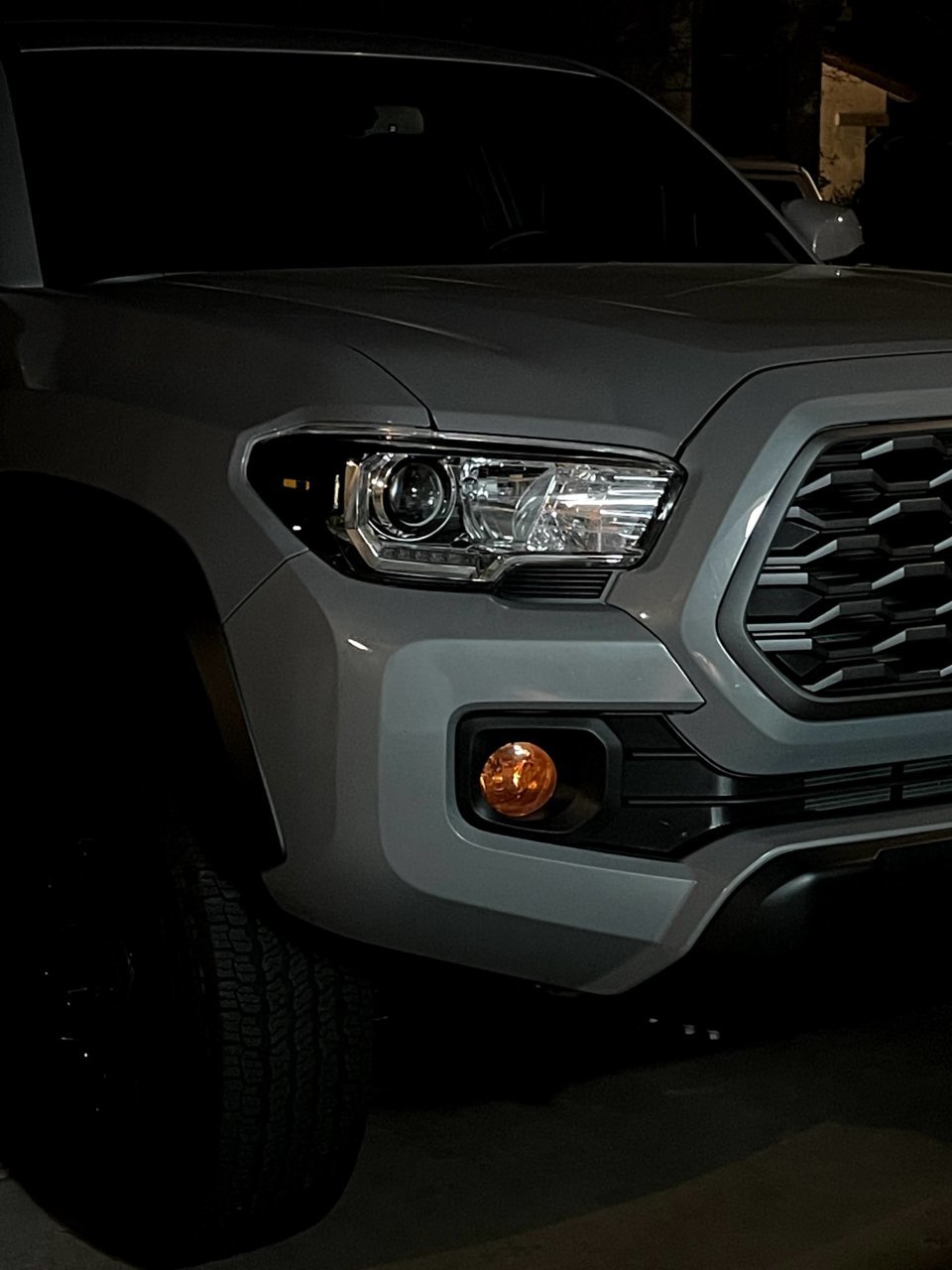

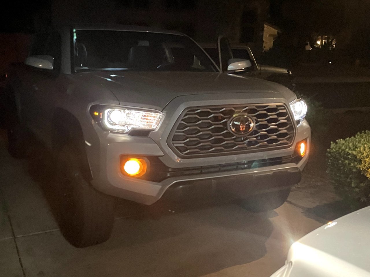

    So as a follow up, I did install both the Hella 2.0 H9 in the low beams (got the yellow plastic inserts from @daveeasa, highly recommended) and the amber Lamin-X film for my stock fogs. I am pleased with both - sorry this isn't a great forward looking comparison, but the color of the Hella's is definitely "whiter". Overall happy with the changes.IMG_9905.jpg IMG_9904.jpg

    i don't like 'em. You need to go OEM LED :D:boink:

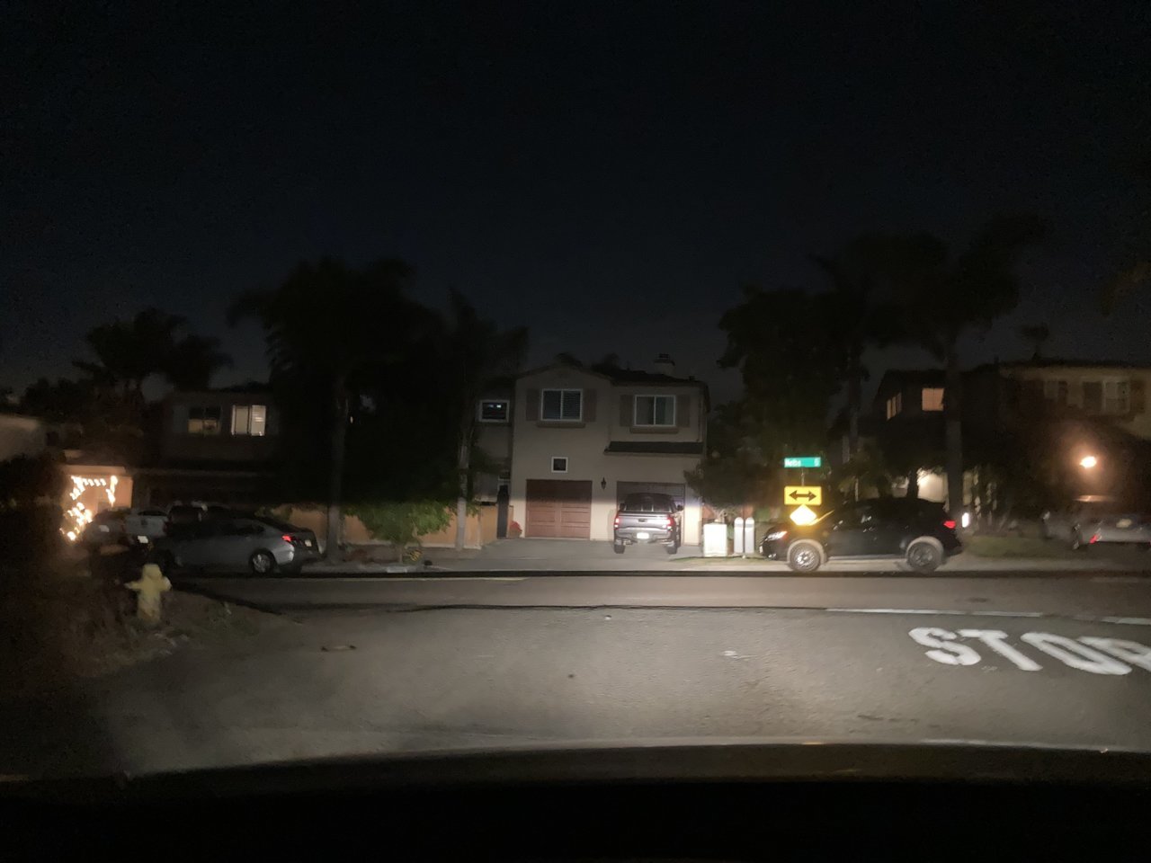

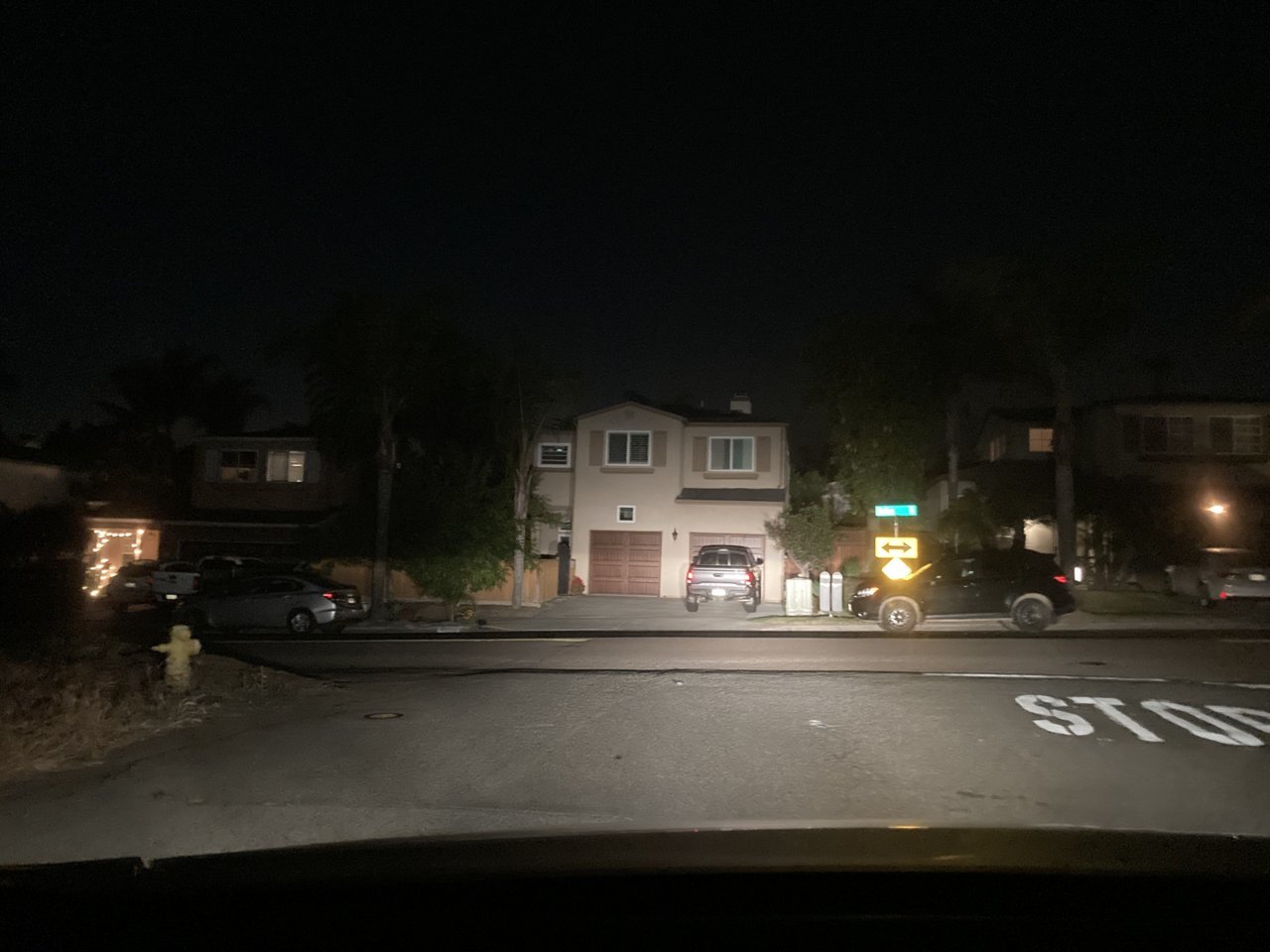

    As for the HIR’s, when it comes to high beam performance, they simply rule. Check out these photos of me blasting my house with light from the minivan.
    H9 low beams
    Toshiba HIR 9011 high beams

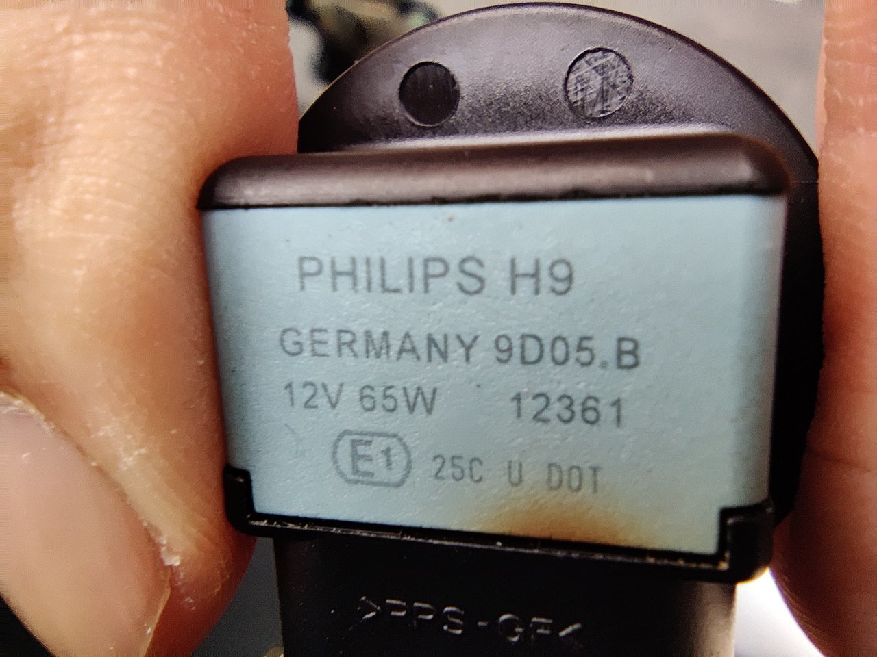

    The Philips H9s are rated at 400 hrs, as are the Philips Xtreme +100 H11s and the Philips Xtreme Pro150s H11s. The GE/Tungsrams are pretty low. Night breakers lasers are only 250 hrs. Short of staying with something close to stock performance for maximum longevity the Philips H9s seem like the way to go for performance vs lifespan.

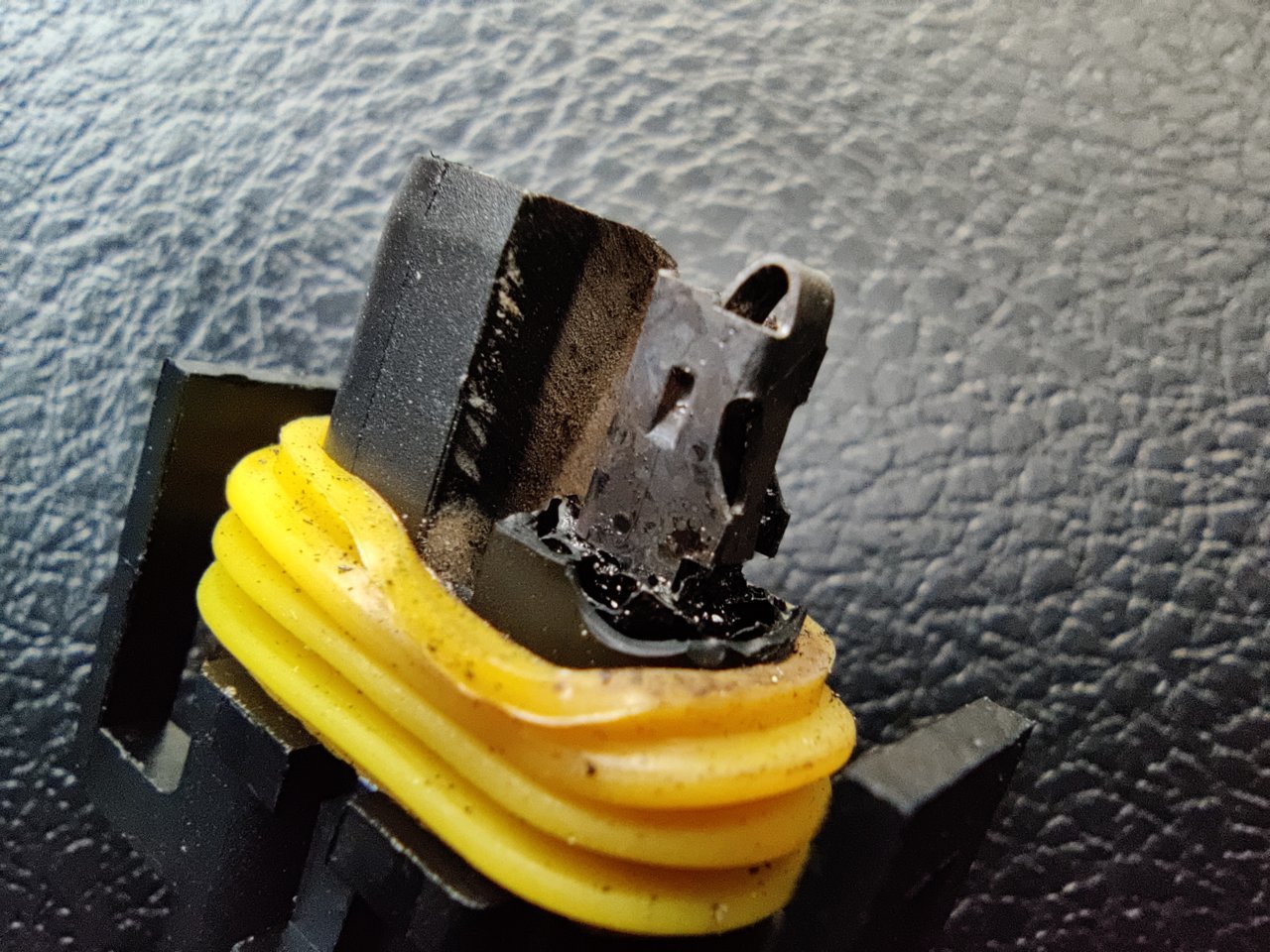

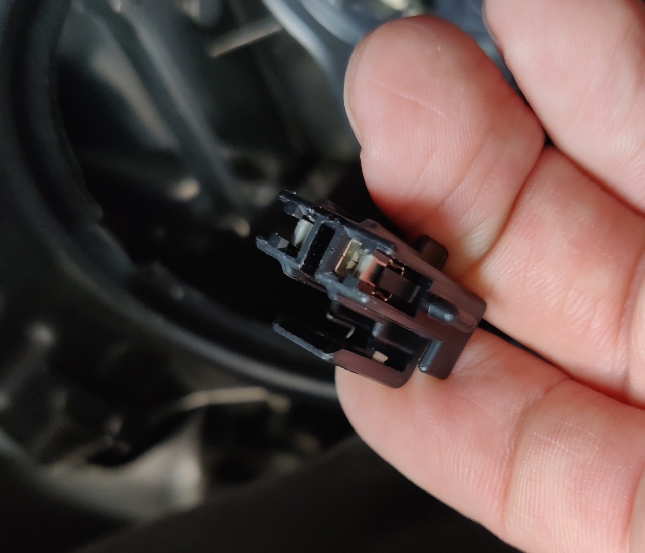

    I was going to do this on my 4Runner, but I forgot that mine doesn't have these plastic bits.
    Also, I let this adapter go a little too long...
    The plastic flaked off like burnt paper. :eek:
    Even the bulb looks a little burnt on the back
    I have a fresh of H9s to install, going to trim the tabs rather than use any adapters.

    If you de-pin and get a photo of the terminal I can tell you if it’s a match to the ones I have.
