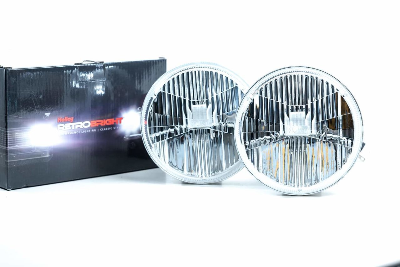

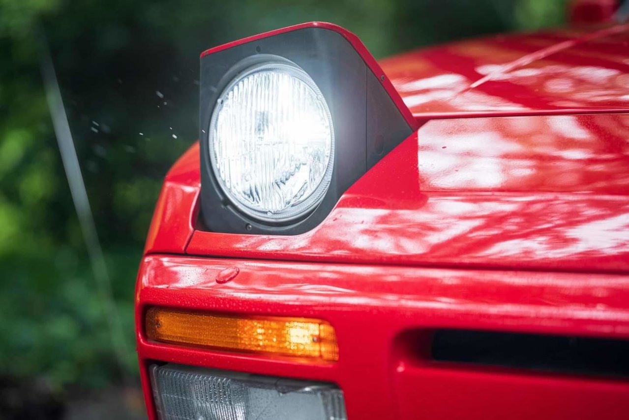

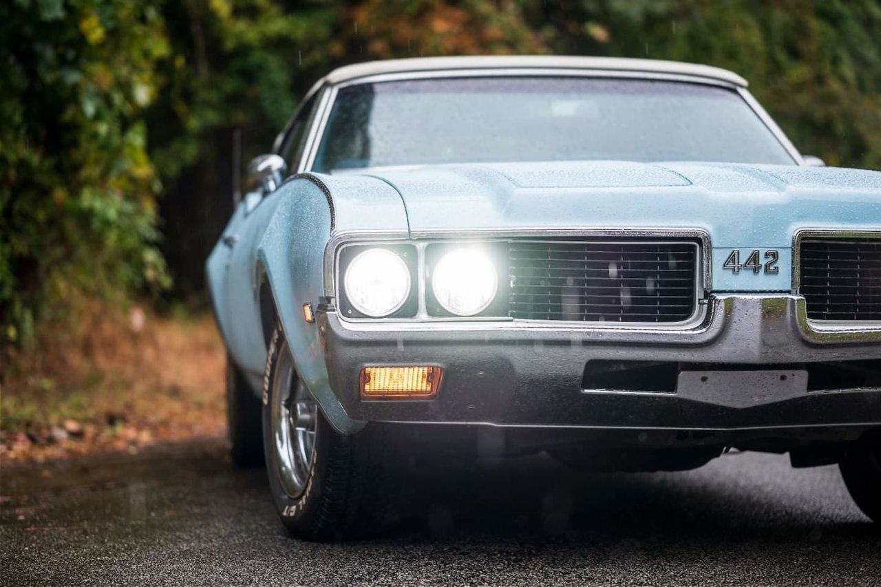

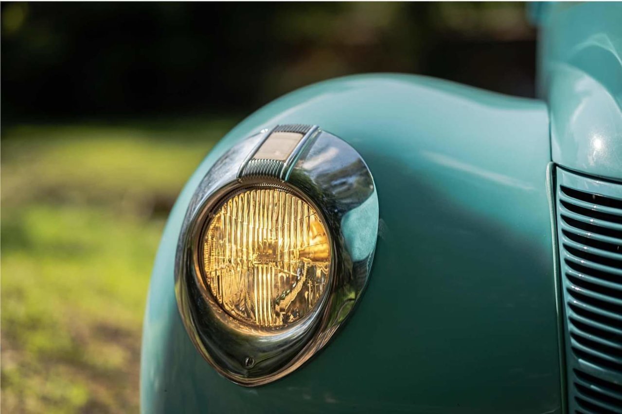

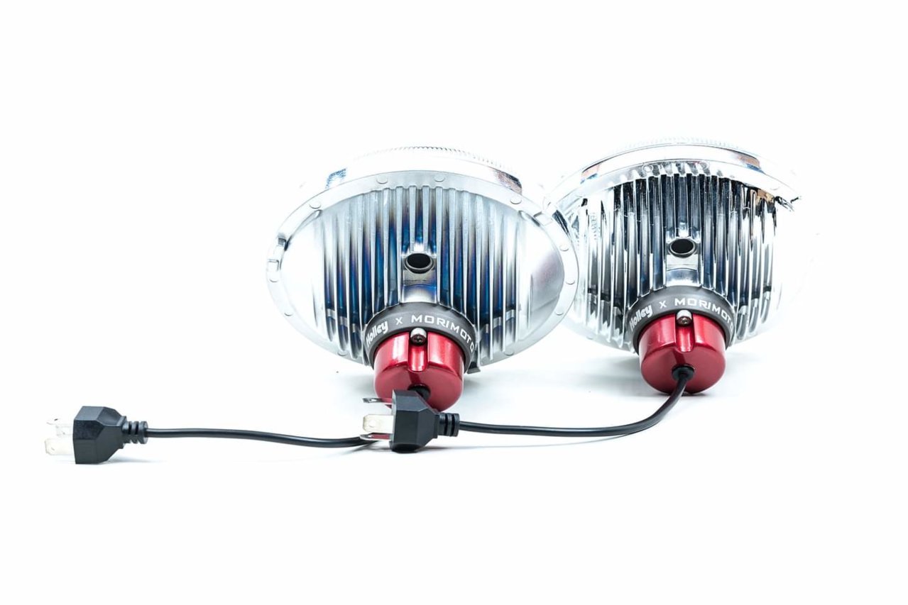

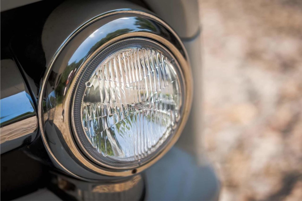

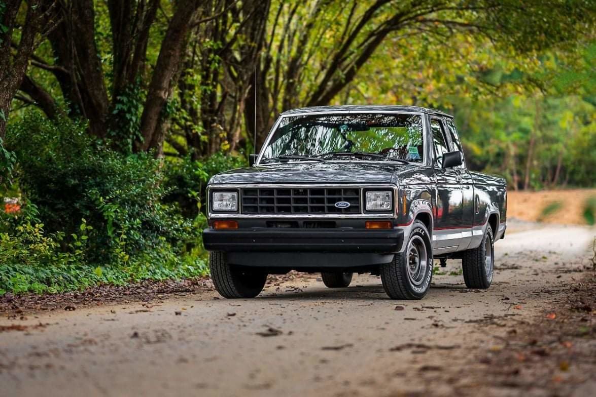

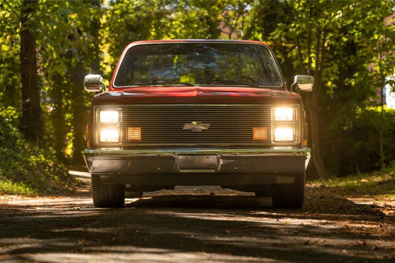

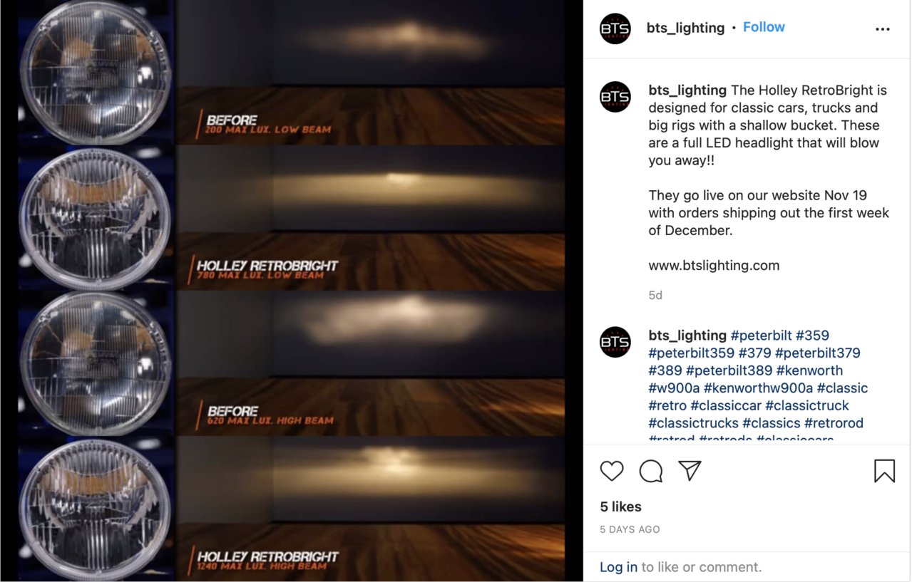

    Interesting product by Morimoto at SEMA:
    Classic car, truck, big rig and classic conversion crowd, the wait is almost over!
    Meet the Holley RetroBright by Morimoto, a "period correct" LED headlight assembly. These are designed to fit the shallow buckets of the classic cars and big rigs like the Peterbilt 359 and Kenworth W900A. If you want a modern upgrade to your lighting but can't stand the Modern LED look, these were built specifically for you!
    Holley chose Morimoto with this task for good reason. Morimoto is the industry leader in automotive lighting and specialize in high quality engineered optics. What does this mean? While most LED companies just slap an LED chip behind a lens and call it good, Morimoto's master engineer spends a great deal of time specifically designing where in the beam pattern the light needs to be distributed for the safest driving experience.
    The RetroBright will be available in 5.75", 7" round, 5x7 and 4x6. They will come in your choice of a classic 3000k output color to match the color of your current halogen lights or a more modern 5700k for a pure white look.
    There will be 2 adapters available as well-one to easily hook between newer style plugs and the older "center ground" ones, and an adapter to wire these in for a quad low/high beam. The RetroBright will have a sharp enough cutoff line from its superior engineering that you can get away with running all 4 on low beam without bothering others on the road for maximum light output.
    The Holley RetroBright will go live on www.btslighting.com on Nov 19/21 with first orders shipping out the first week of December.
    BTS Lighting is the only company focused on big rigs. We see a great market for these in the 359 and W900A, as well as the 379/389 with the united pacific housings as they tend to suffer from the buckets loosening too often from the heavy LED assemblies. The RetroBright will be lighter and slow these issues.
    It will be asked, over and over so we will address this here. No, these are not heated and as of right now there is no plan to make them heated.
    Please reach out to us if you have any questions about this product, or any other we carry.
    FB_IMG_1637216238508.jpg FB_IMG_1637216245519.jpg FB_IMG_1637216249512.jpg FB_IMG_1637216254229.jpg FB_IMG_1637216260094.jpg FB_IMG_1637216263537.jpg FB_IMG_1637216266786.jpg FB_IMG_1637216269616.jpg

    I really like this concept. A 3000k LED headlight will draw market attention if it performs well. Though ideally it really should be ~3500k like a performance halogen, stock halogens are typically ~3200k, so 3000k flat would be a bit yellow. But hopefully they are just being generic in terminology. I'm pretty interested in seeing where this product goes and how it performs.
    Although I have never head of any big rigs buyers reference BTS. What I do regularly see in that market is JW Speaker and Trucklite, both of which offer heated versions of their headlights. If they want to seriously serve long distance trucking, heated headlights are a must.
    A post I found on their site:
