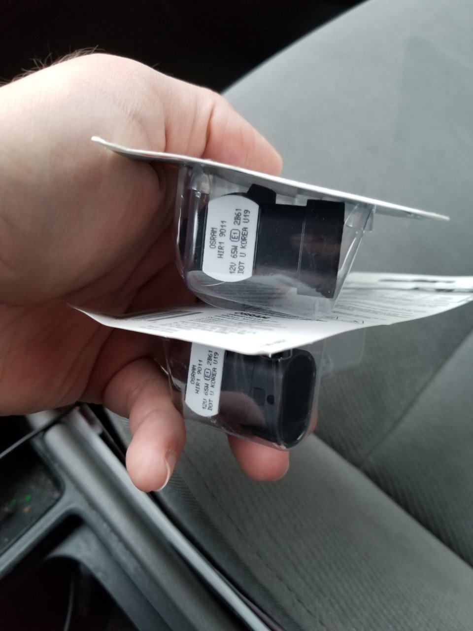

    So, I'm going to post this here as Crash has done the 4runner headlight testing in this thread. It's been like 3 or 4 months of looking, but I finally found a 2nd Osram/sylvania 9011. I've checked autozones/O'reilly's/NAPAs/Advance Auto's/PepBoys (which all carry sylvania pep boys usually carries a mix of Philips and Sylvania) across three states. About 2/3rds didn't stock 9011 bulbs of any brand, and those that did usually just had a single bulb, or were waiting to re-stock the single 9011/HIR1 bulb they had. 9012's were much more common. Of the remaining 1/3rd that carried 9011, most were sylvanias Basic bulb (which I don't believe has been tested by Crash in comparison to the GM/Toshiba OG 9011).
    So rarer than hens teeth.

    They are still Sylvania Basics, just the made in Korea makes them HIR. Luckily, I didn't have near the time you did finding them. Hopefully, you weren't doing all of that driving just for those bulbs.

    No, just checked out stores in/around the areas I was driving to. You're right that they're in the same packaging as sylvanias bulb, but the white osram tag on the plug base makes them easy to spot.
