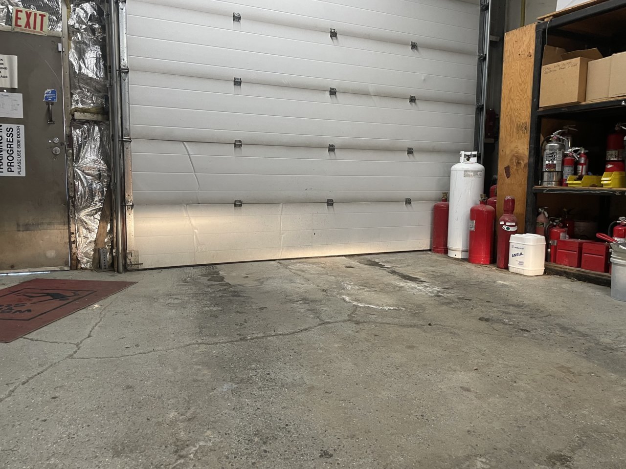

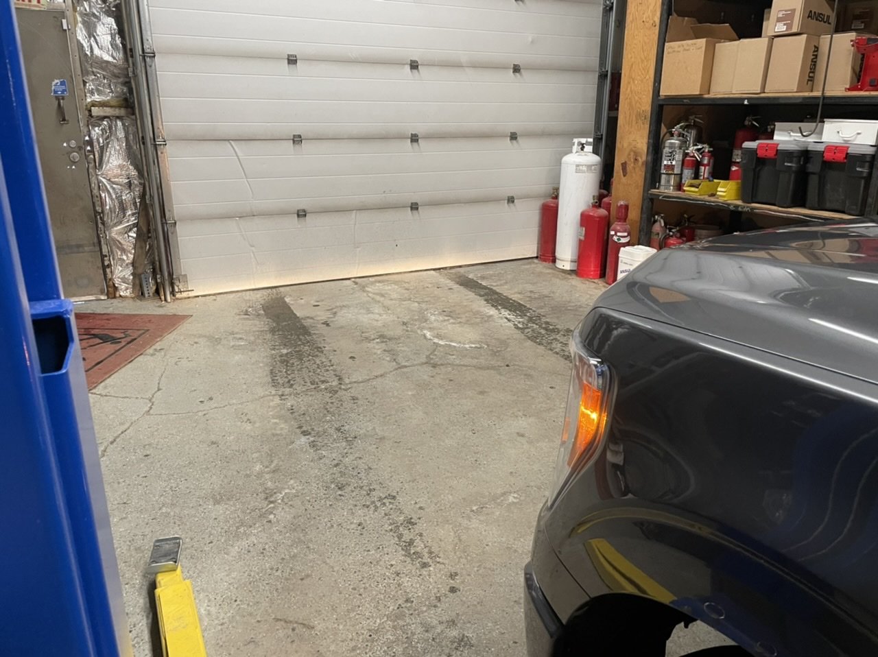

    I know it’s not a Tacoma, but I wanted to re-emphasize the importance of aiming your low beams and fog lights.
    The OEM fog lights on my F150 were aimed waaaaay too low. The center of the optic is 24” from the floor, and at 15 feet the cutoff was basically an inch off the floor! Remember, the general rule for fogs is 2-3” down at 25 feet.
    15 minutes with a wrench and all was better. A comparison with the drivers side adjusted so the cutoff is 23” off the ground. 8DB89BFC-4AC2-4F48-B273-970AC249C82B.jpg
    While not as bad, the headlights were also aimed low by 2” at 15 feet. Fortunately Ford has the vertical adjust on top of the housing where it is easily accessed.

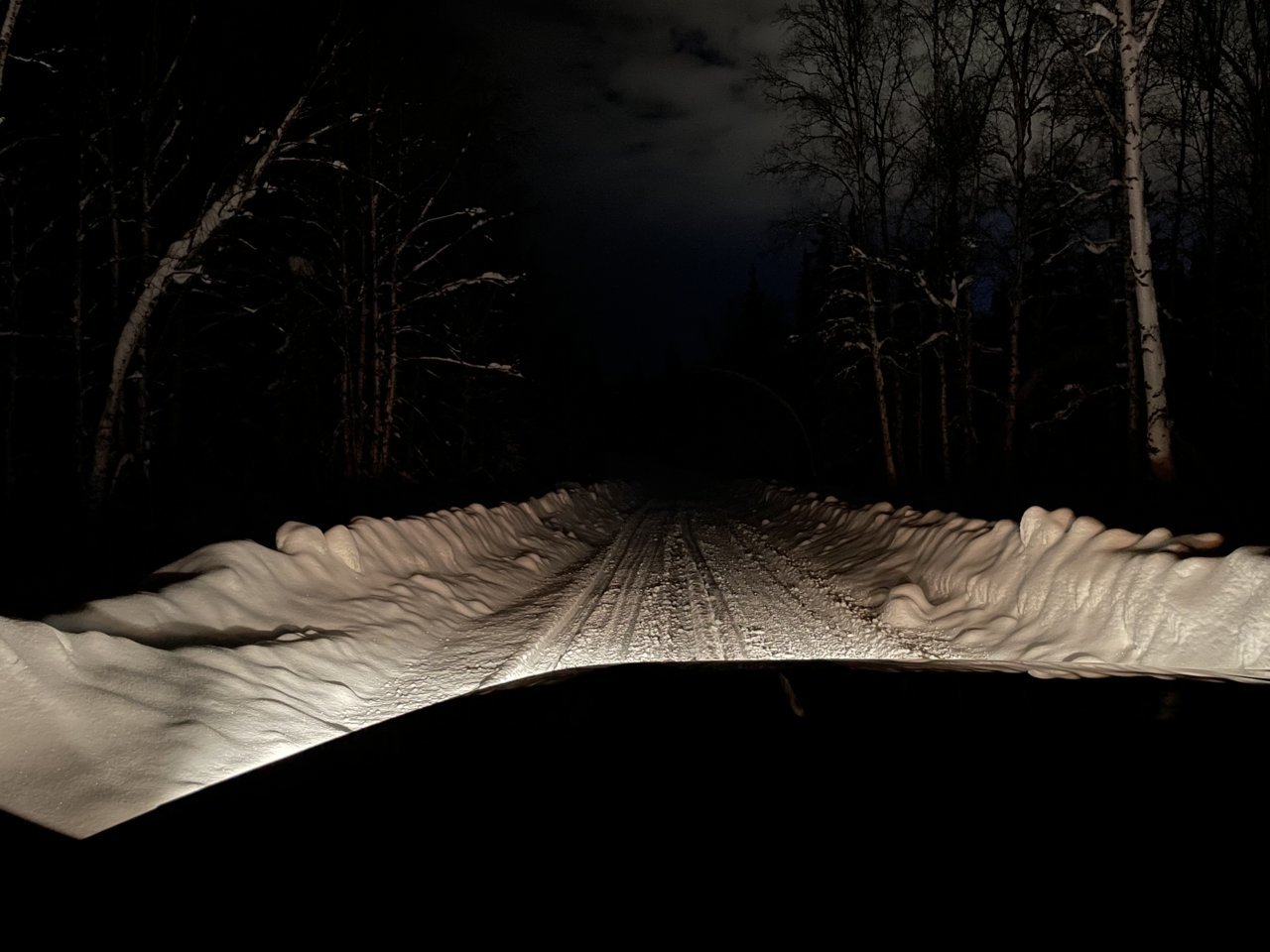

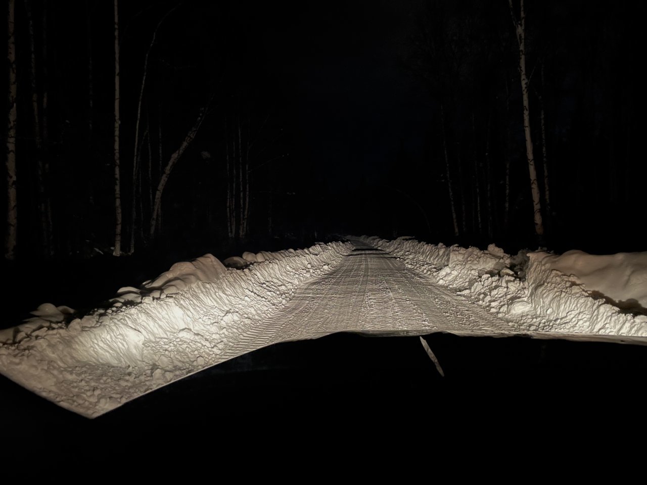

    Before aiming (and having the road plowed):
    And after:
    My phone is making the 2nd photo look there is more distance projection than there is in person, but it’s obviously gone from nothing to actually useful as a fog light. They are NO WHERE NEAR as wide as the TRD OR fogs I had on my Tacoma unfortunately!
