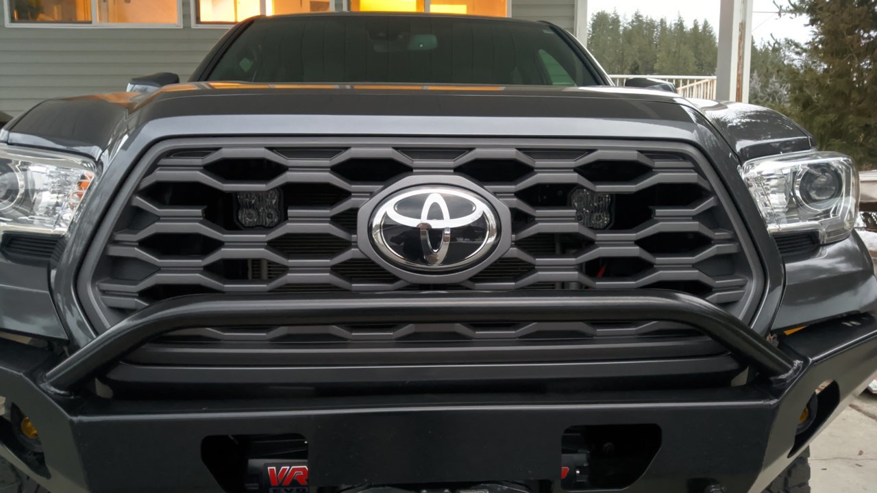

    I mounted SS3 Pro 4K on a BAMF behind the grill mount and then cut a my grill. That puts them at head light level for aux high beams.

    Interesting.... I have spent around 2 hrs. measuring and contemplating this! What is the distance from the front of the SS3's to the back & front of the grill.
    Seems like the Pro Grill would be a good way to do this...

    Roughly 5" from lens to mid grill. With driving lens on the SS3, there isn't much loss that the regular high beams don't cover on the periphery. I did have a section of the grill that was in front of the upper two LEDs, but trimming the grill solved that.
    That's the stock '21 OR grill.
    Aws123 likes this.

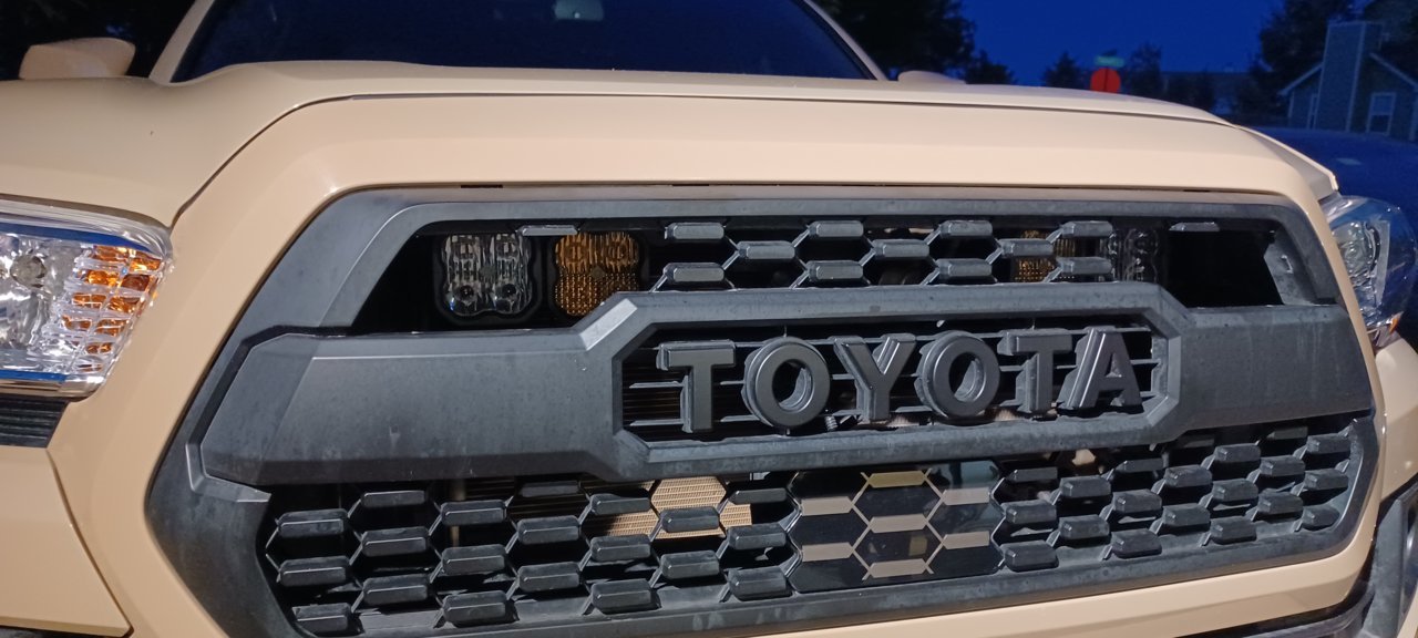

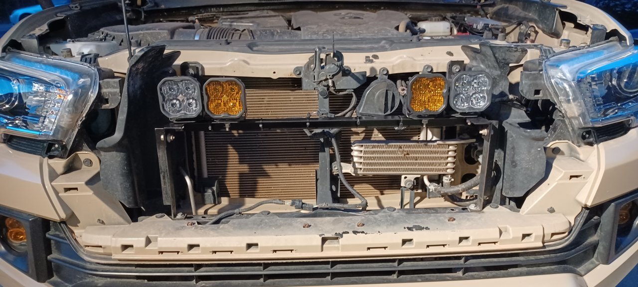

    20210728_204336.jpgi did something similiar to give you more ideas. Custom made brackets though.20210728_203004.jpg

    I'm digging your color coordinated radiator and cooler! Must be a Colorado thing....
