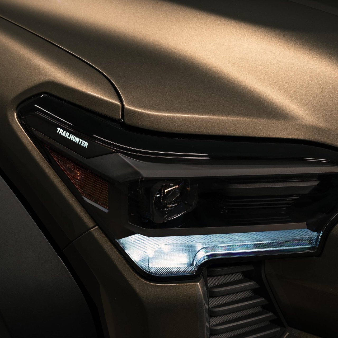

    Photo of the 4th gen headlights on the trailhunter trim.
