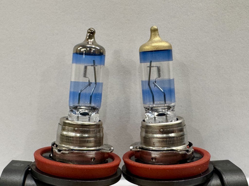

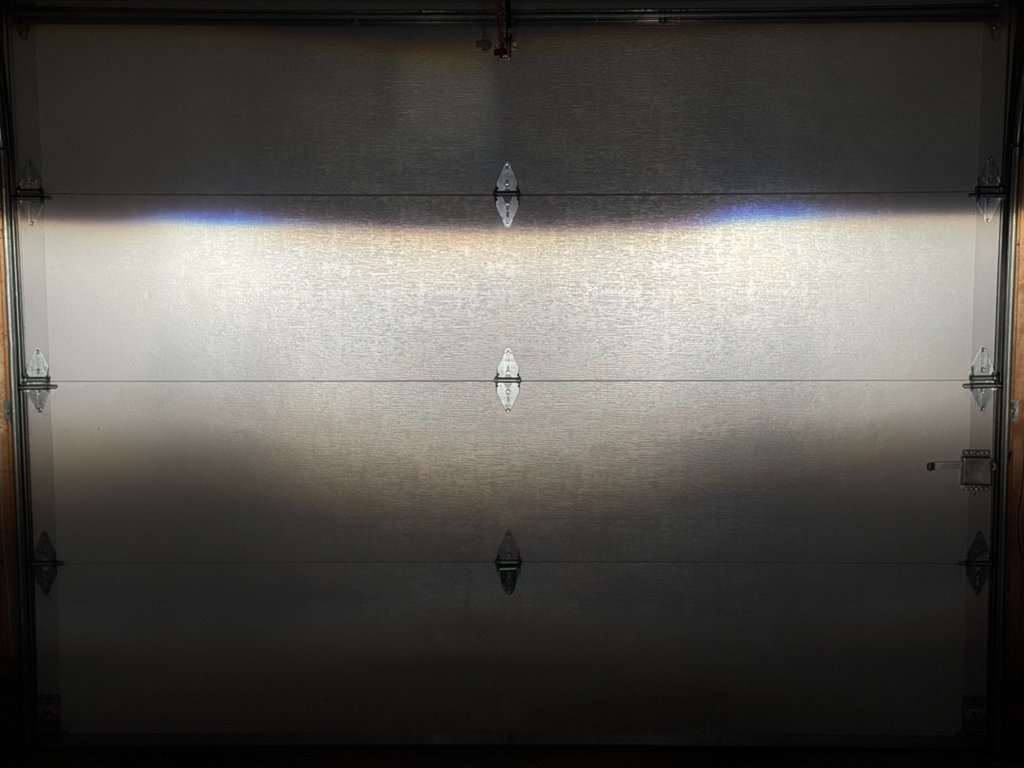

    Osram Night breaker +200 (left) vs +220 (right with gold cap)
    Aside from the glare cap being chrome vs gold, the bulbs look extremely similar. The forward blue coating on the +220s does look a bit darker than the +200s.

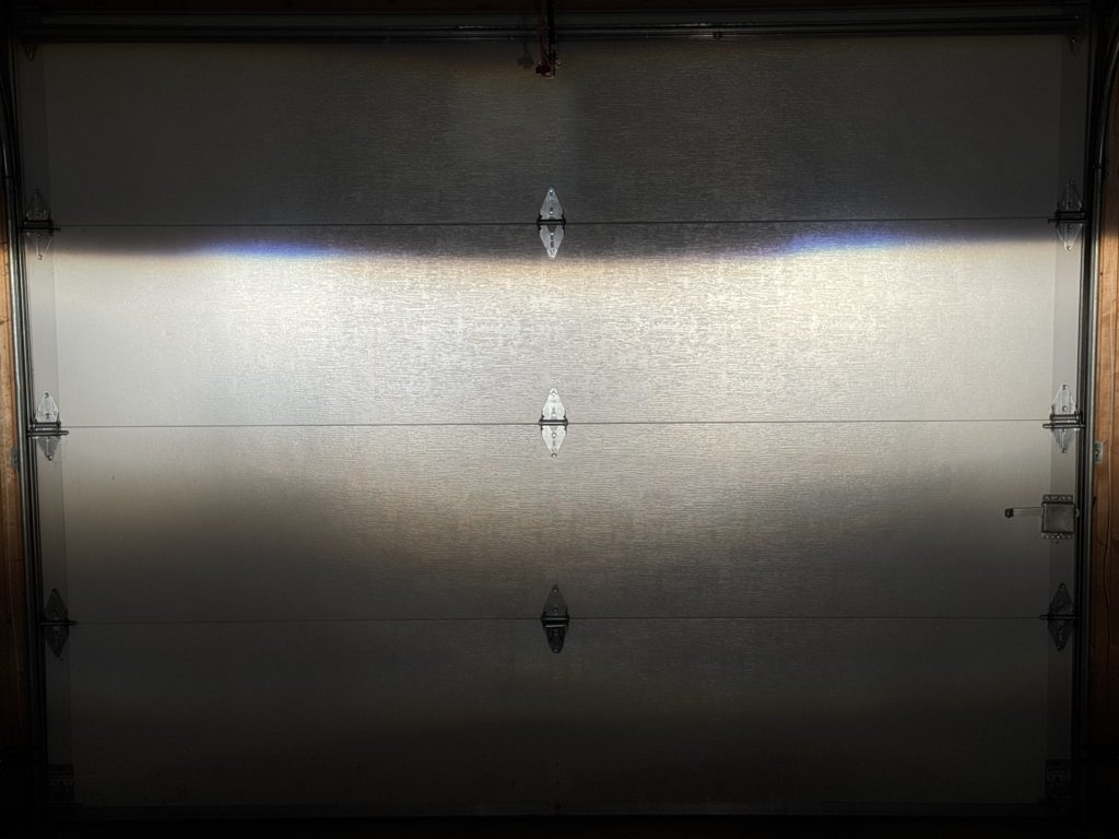

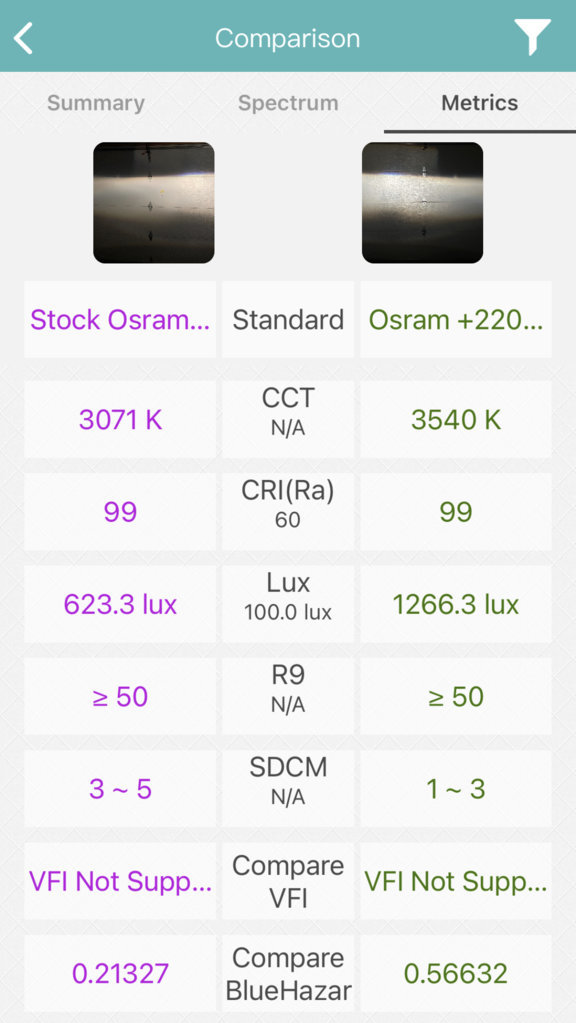

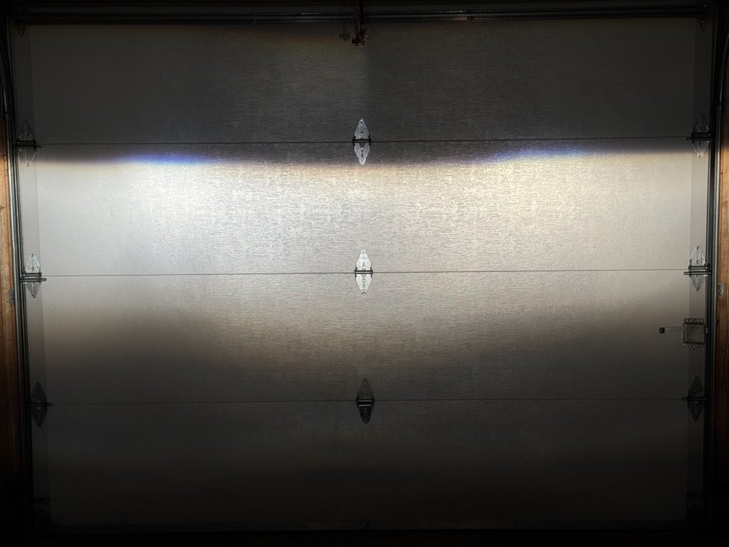

    Osram +220 (left) vs stock Osram standard (right)
    Very impressive, the Osram Night Breaker +220s come in over 2x in peak output intensity vs stock. Output color temp is also nearly 500k higher.
    Power draw at about 60.2w.

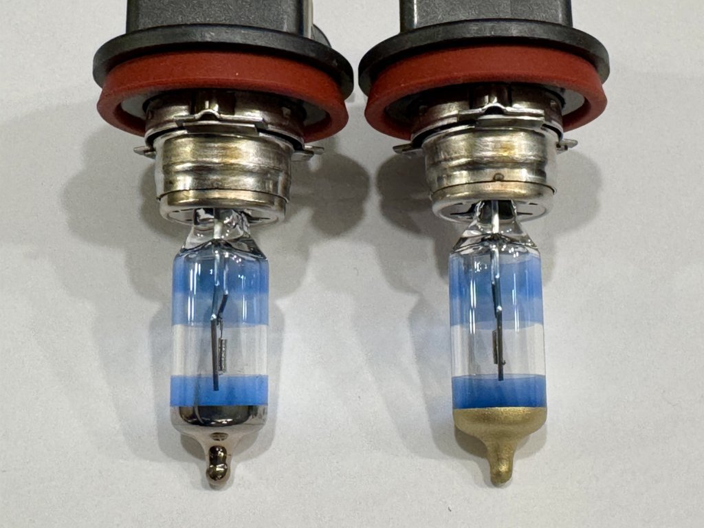

    Comparing the filaments on the +200 (left) vs +220 (right)
    Hard to see in the photo, but the +220 filament is just a little shorter in length, which should translate to higher peak output intensity. The +220 filament it is also appears shifted a little closer to the bulb base. Smaller filaments can burn brighter producing higher output intensity while not significantly increasing the total lumen output, thus keeping within required compliance limits.

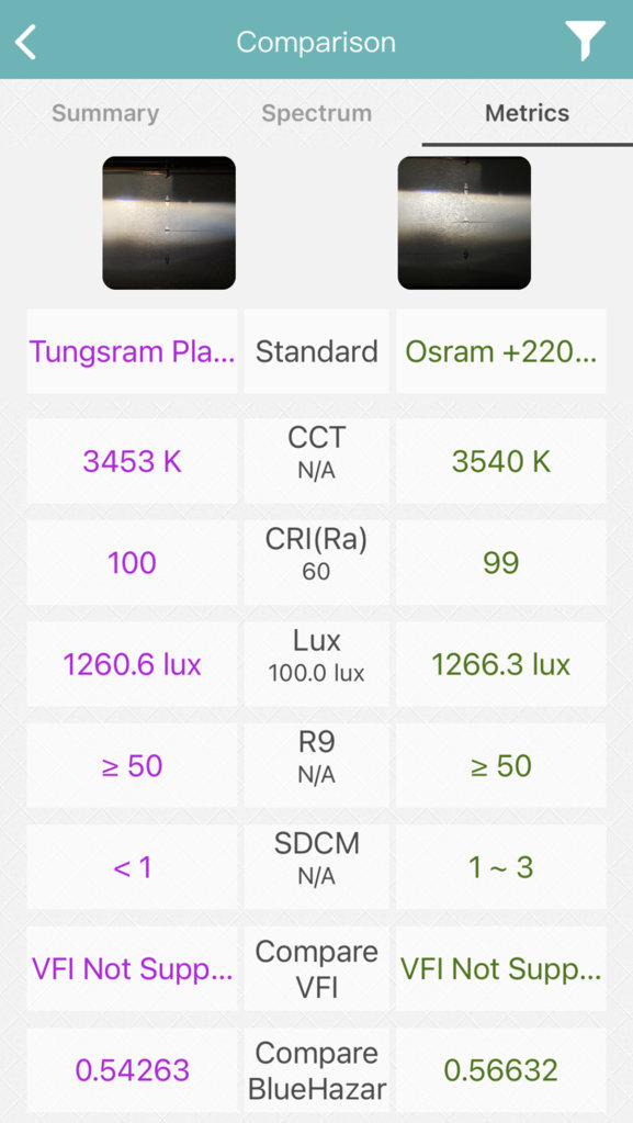

    Comparing the Osram +220 to the highest performing H11 tested thus far, the Tungsram Platinums.
    Tungsram Platinum vs Osram +220
    The Osrams just squeak out higher peak numbers over the Tungsrams, making it the highest performing H11 tested to date. Realistically though given the scale they are about the same and you will be unable to tell the difference in output intensity with the naked eye. The Osrams do have a slighter higher color temp, the Platinums were a largely uncoated bulb with only a small band coating at the bulb glare cap. The Tungsram Platinums have been unavailable for some time, so it is exciting to have a new highest performing H11 that is readily available.

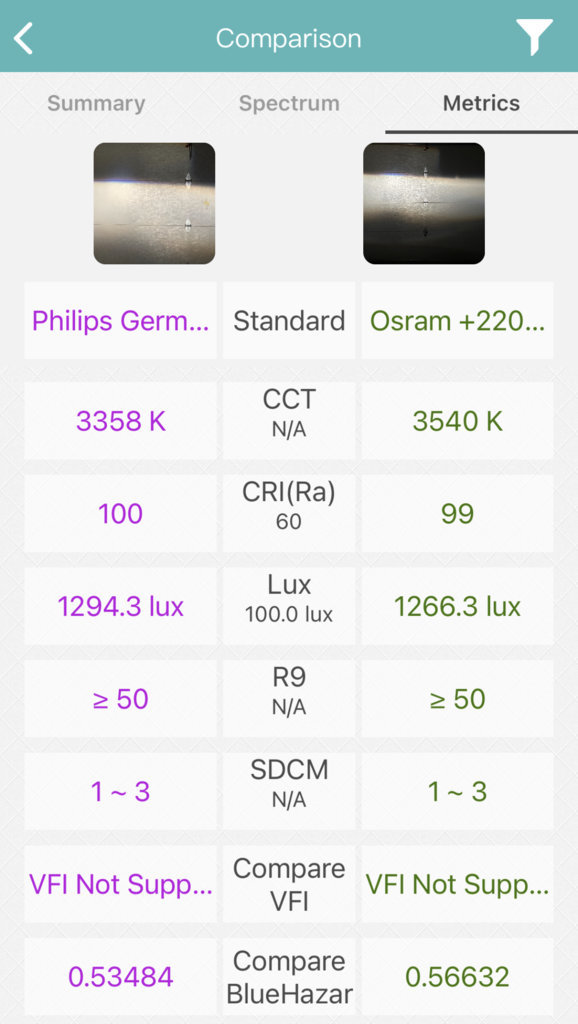

    Comparing to the highest performing bulb tested to date, the German Philips H9.
    Osram +220 vs Philips German H9
    Philips German H9 vs Osram +220 H11
    The Philips German H9s still come in 2% higher in peak output intensity vs the Osram +220 H11s, which is incredibly impressive on the part of the +220 H11s competing against the top H9. The Osram +220s are almost 200k higher in color temp.
    While the performance numbers between the Philips H9 and Osram +220s are close, the costs and bulb life are not so close.
