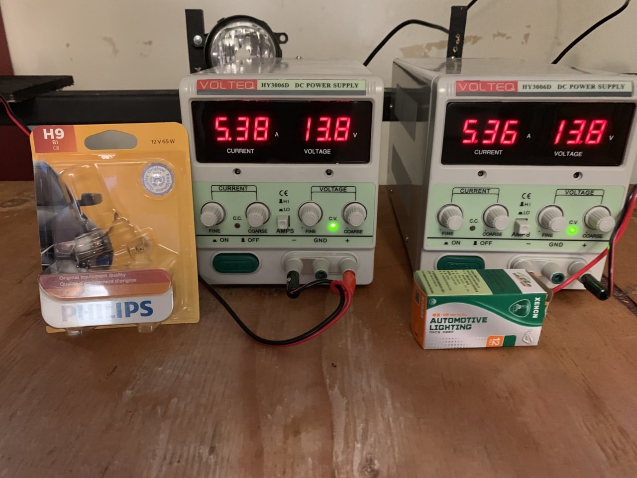

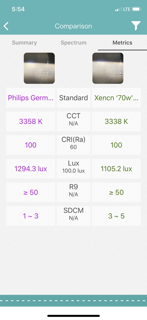

    As to the high wattage Xencn 70w ‘off road only’ H9s.
    Chinese product lies.
    The 65w rated Philips bulbs pull more current.
    The 65w rated Philips bulbs have higher output:
    While H9s are sold as 65w, doing the math on Volts x Amps = Watts, you can see the Philips actually pull 74.2w vs Xencn pull 73.9w. However this is in the legal allowable range for a 65w bulb, which allows +/- 15%, meaning a legal max of 74.75w. So sure the Xencn pull over 70w, but all they did is change the label on the package and sell them as something they are not, they are not over-wattage, they don’t even match the stock wattage of the Philips H9s. Just another over-promised misleading lighting product.
