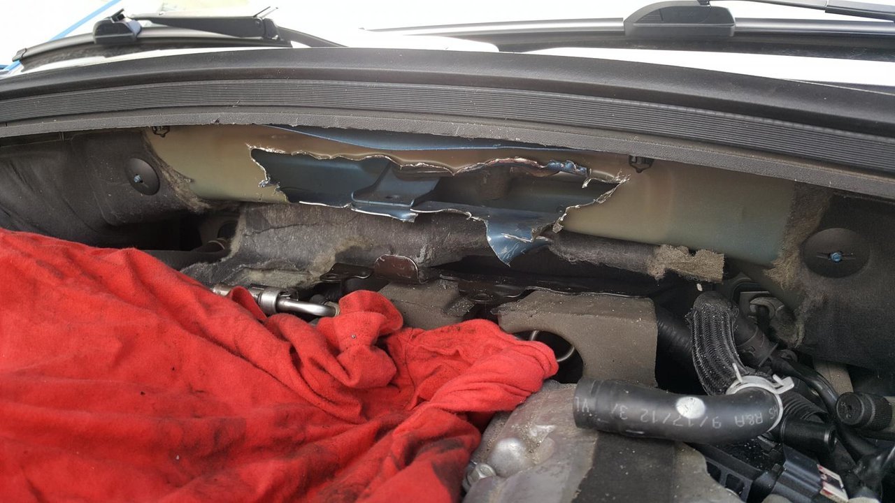

    Think about it this way, with all that air going through the bay at high speeds, its got no where to go. It will basically bounce around in your hood as there is no pass through, such as the reasons expensive sports cars have channels.

    You obviously do not know how louvers work or their benefits, so I'll leave it at that.

    So your not cutting into the hood to create a vent. Just adding plastic to make a pep boys truck. Ok I get it now.

    Main thing to consider is the hood support pieces welded underneath the outer skin. Cutting those may weaken your hood causing it to bend or buckle during raising or closing it. :notsure:Good luck!
